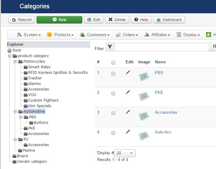

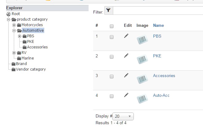

Strange problem. As you can see from the attachment, I have added a category under "Automotive" called "Auto-Acc" and this category is visible if the "Automotive" category is selected in the left hand menu of categories.
However, in the left hand menu, this category does not show up and is, therefore, unselectable when dealing with products. I cannot see how this situation exists.

Probably a problem with the category tree data.
Click on the "rebuild" button at the top of the categories listing and it might help.

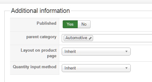

  • Posts: 279
9 years 6 months ago #262365
Wish it was as easy as it wasn't published but it isn't. As could be seen in the first image I attached, it's viewable in the right hand pane when selecting the parent category. I have attached a screenshot of the additional items in the category. No idea what a category type is???

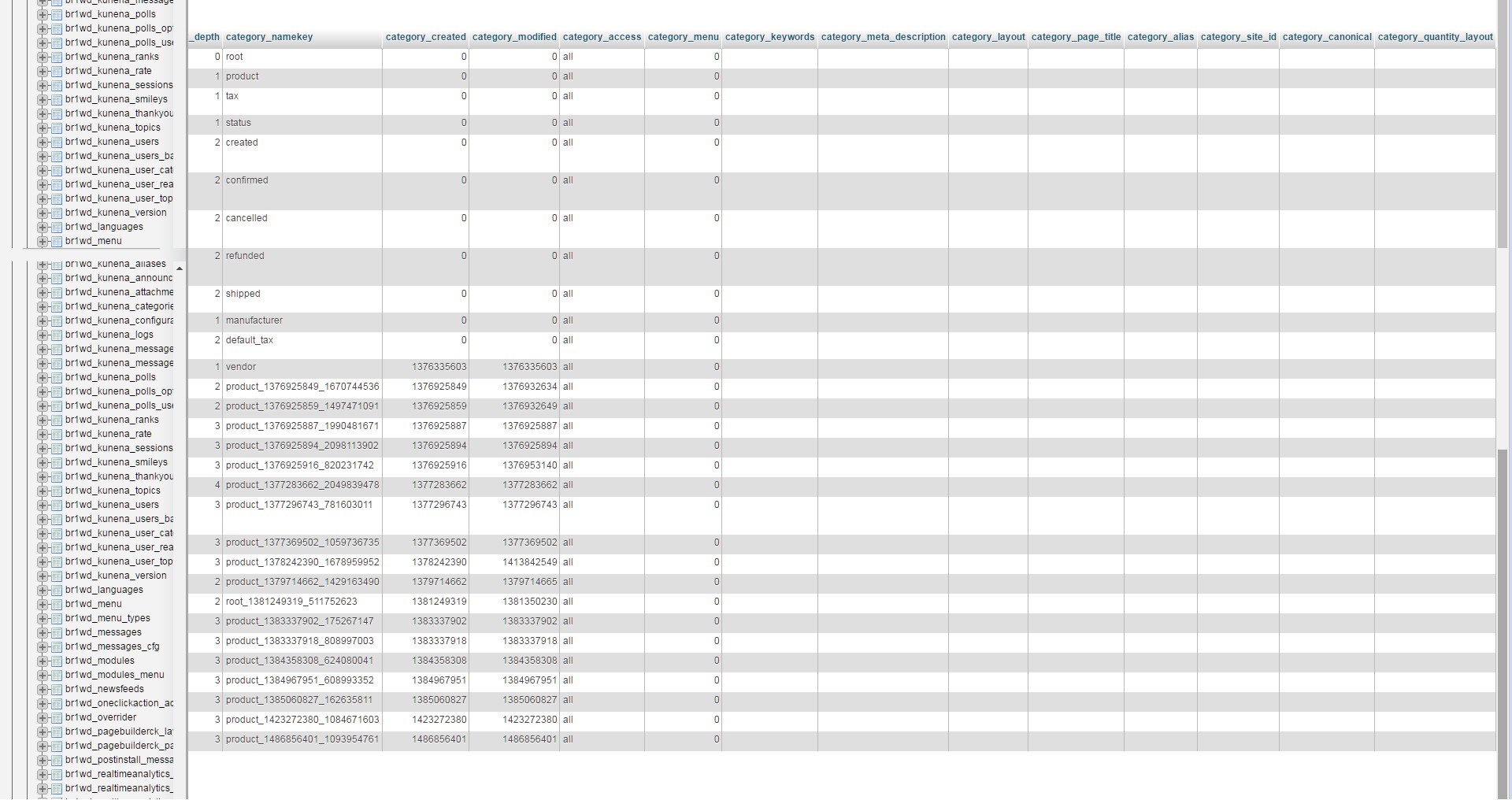

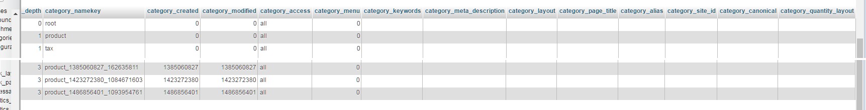

  • Posts: 279
9 years 6 months ago #262471
Here are 2 images showing the full row.

I think that there actually might not be any problem and that the Auto-Acc category is simply below the PBS category and that's why you see it on the right listing (which display all the sub elements regardless of their level) and the left explorer doesn't have it as the PBS category is not expanded.
  • Posts: 279
9 years 6 months ago #262551
Sorry but absolutely not. The first image I posted actually answered that, but here's a further image to show this is not the case.

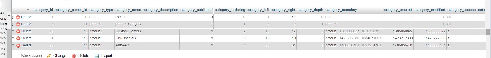

Unfortunately, your screenshots do not contain the information of the category with the id 14. There are only the categories with the ids 1, 2, 29, 31 and 36. So that doesn't help.

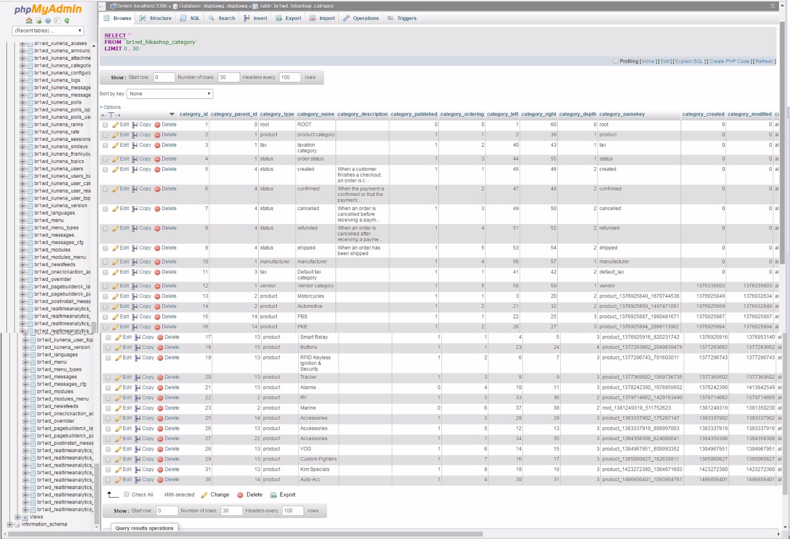

9 years 6 months ago #262689
Here's the full category data.
  • Posts: 86058
  • Thank you received: 14182
9 years 6 months ago #262698
That's great thanks!
Unfortunately, all the data of the categories is correct. So I don't see why that category would be left out.
