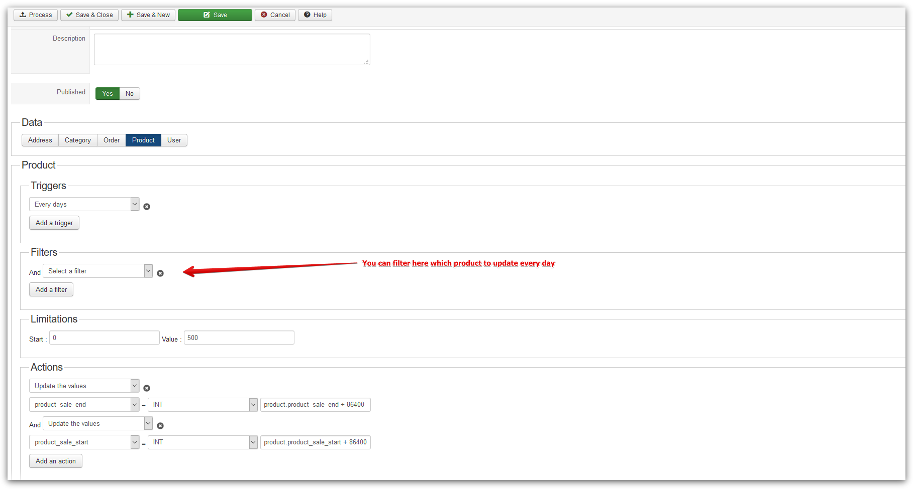

9 years 5 months ago #265961
Here is an example of how to configured your mass action.

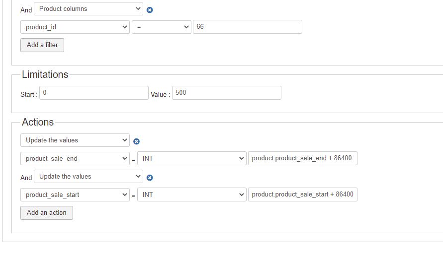

4 years 4 months ago #341094
Hi, I have set the same as the image below, but after I click process, the product sales start and end date didn't add one day. Kindly let me know which part is missed up.
  • Posts: 86094
  • Thank you received: 14196
4 years 4 months ago #341095
You need to select "operation" instead of "int".
Also, you probably also need to remove the spaces around the + signs.
