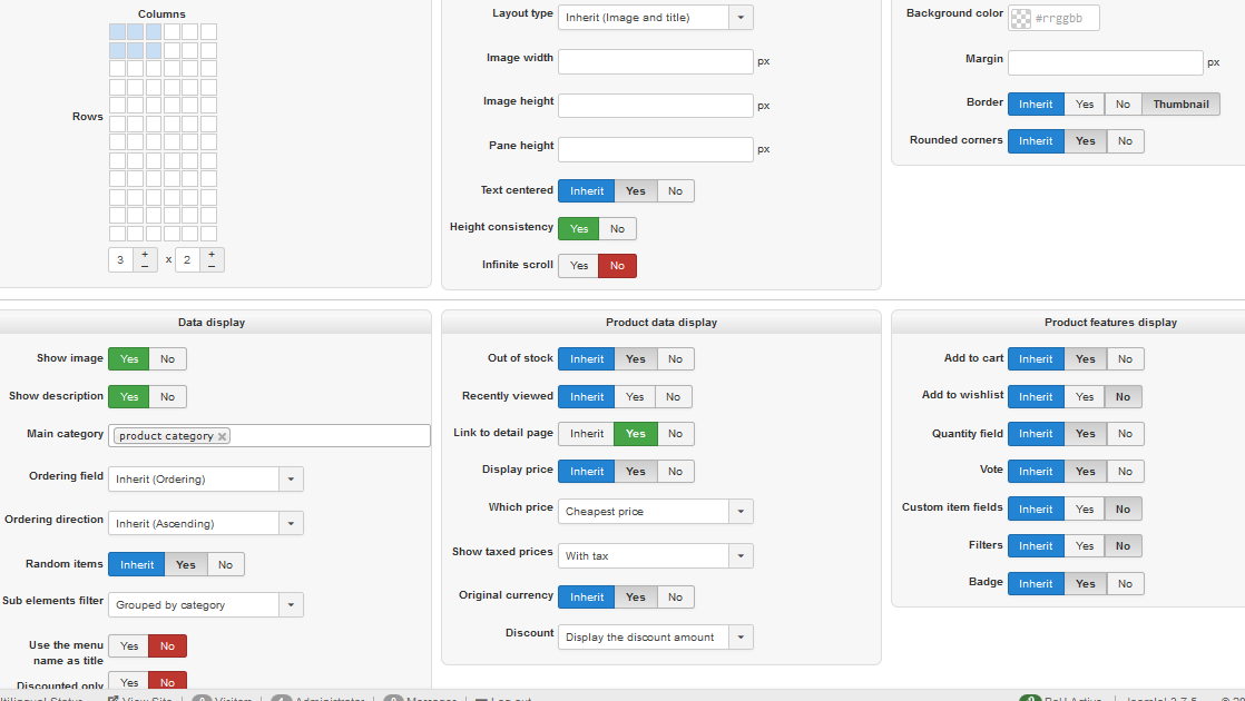

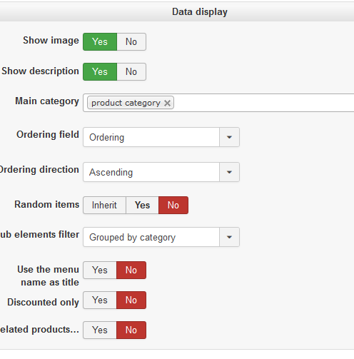

I would like to have the product listing page showing in 3 colons (products grouped by categories). The current configuration in Hikashop is in the attachments. What is wrong? Why do I still see products in 5 colons?

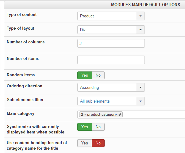

In your second screenshot, I see that you're looking at the default number of columns setting, which is used to set the default value when you create new HikaShop content module instances.
The setting that controls the number of columns once the module is created can be found directly under the "HikaShop options" tab of your module:
www.hikashop.com/images/stories/tutorial...u_item/Modules24.png

in Products listing menu, I set to 3 columns but still is not working. What is wrong in configuration I attached?

On the link you gave, the products listing is generated by the menu item with the id 194 :
monosnap.com/file/yQhguDfSEtwYuiG6RaibpySGiIWjXA
So please make sure that you're looking at the settings of the menu item with that id in your Joomla menu manager.
Also, try saving these settings once to make sure that the data in the database for these settings is correct.
Also, clear any cache you might have configured on your Joomla website as otherwise, you might be looking at a page generated before you changed the number of columns of the menu item.
If that still doesn't help, all I can think that's left is to switch to the default template of Joomla and check if the listing has the correct number of columns. It might be that your template has view overrides of Joomla which force the display of the listing in 5 columns regardless of how the menu item is configured.

Thanks a lot Nicolas. Your help has been precious. I fixed the problem.

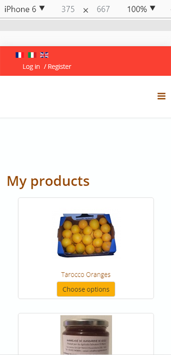

Just one more question: if I open the same page on mobile device, the image for the product 'Tarocco orange marmalade' is a bit larger than the others.
Is there the possibility to have images all the same dimensions?
On PC desktop the page looks fine.

The issue is the way your template switch between responsive and non responsive display.
Add that CSS and that will counter act that:
@media (max-width: 996px){
.hkc-md-4 {
    width: 100% !important;

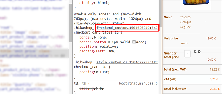

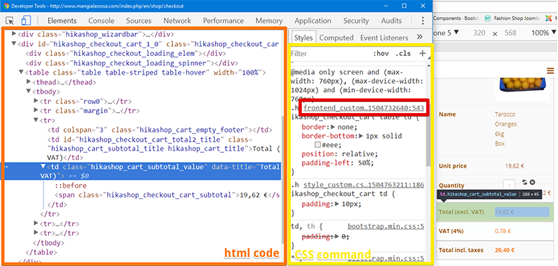

I will explain you how to proceed to get the concerned css file.
- Go to your page and right-clic while you target the point to correct
- Select inspector, inspect tool (depends from your used navigator)
- A new window will open with a view on the html and the css
- In the Css part you will be able to see css command grouped by css file name
As you can see side to the Css file name, you have the command line, here in this example
frontend_custom...xxxxxxx: 543
I invite you to fully understand this tool quite usefull to customize your css.
You can see with this screenshot that you have again a padding-left command that maybe you can change.

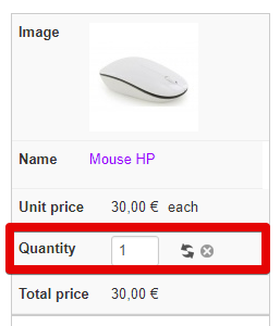

My final problem on mobile view is about the margin of quantity field box on page www.mangialarossa.com/index.php/en/cart . On mobile, the quantity field box is overlapping the table line "total price". I would like to increase the margin but I can not find where the CSS string to edit is located. Could you please help me?

I think you can use a Css height command on your required td that display your quantity.
But you have to know that right know the way your quantity is displayed isn't as it by default in HikaShop css file or css style :
When I analyzed your Css code, the root issue about this come from your custom in the style css.
More precisely, I see inside the td that you have some float command, and this kind of command can break your container (here, the td).
You can try with a default style css, in order to see by yourself.
