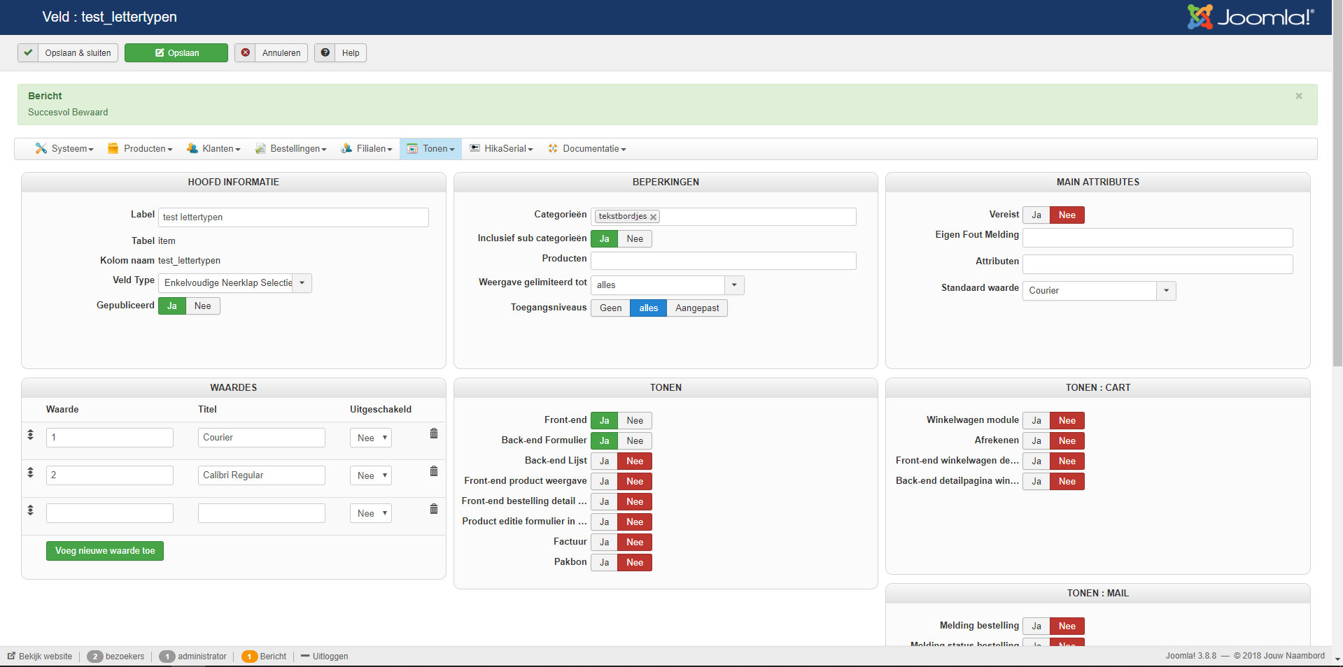

I would like to achieve the same effect in a custom field dropdown where one can select a font. I added a ccs line in my template:
.test_lettertypen option[value=1] {
font-family:Courier New;
where the single dropdown has the column_name "test_lettertypen" (see attachement).
Unfortunately, this does not work. Is there a simple solution?

8 years 1 month ago #295214
You can do that yes. However, the class test_lettertypen doesn't exists.
The class is hikashop_item_test_lettertypen_line if you look at the HTML of the area where the select is with the HTML inspector of the developer tools of your browser.
  • Posts: 515
  • Thank you received: 22
8 years 1 month ago #295248
Yes, I found that before in Firebug, but that also didn't work when using:
.hikashop_item_test_lettertypen_line option[value=1] {
  • Posts: 86096
  • Thank you received: 14200
8 years 1 month ago #295260
Try like that then:
.hikashop_item_test_lettertypen_line option[value="1"] {
font-family:Courier New !important;
Please understand that this is purely CSS customization, and has nothing to do with HikaShop itself.
  • Posts: 515
8 years 1 month ago #295314
Thanks, allready tried that. I understand, will figure it out myself.
