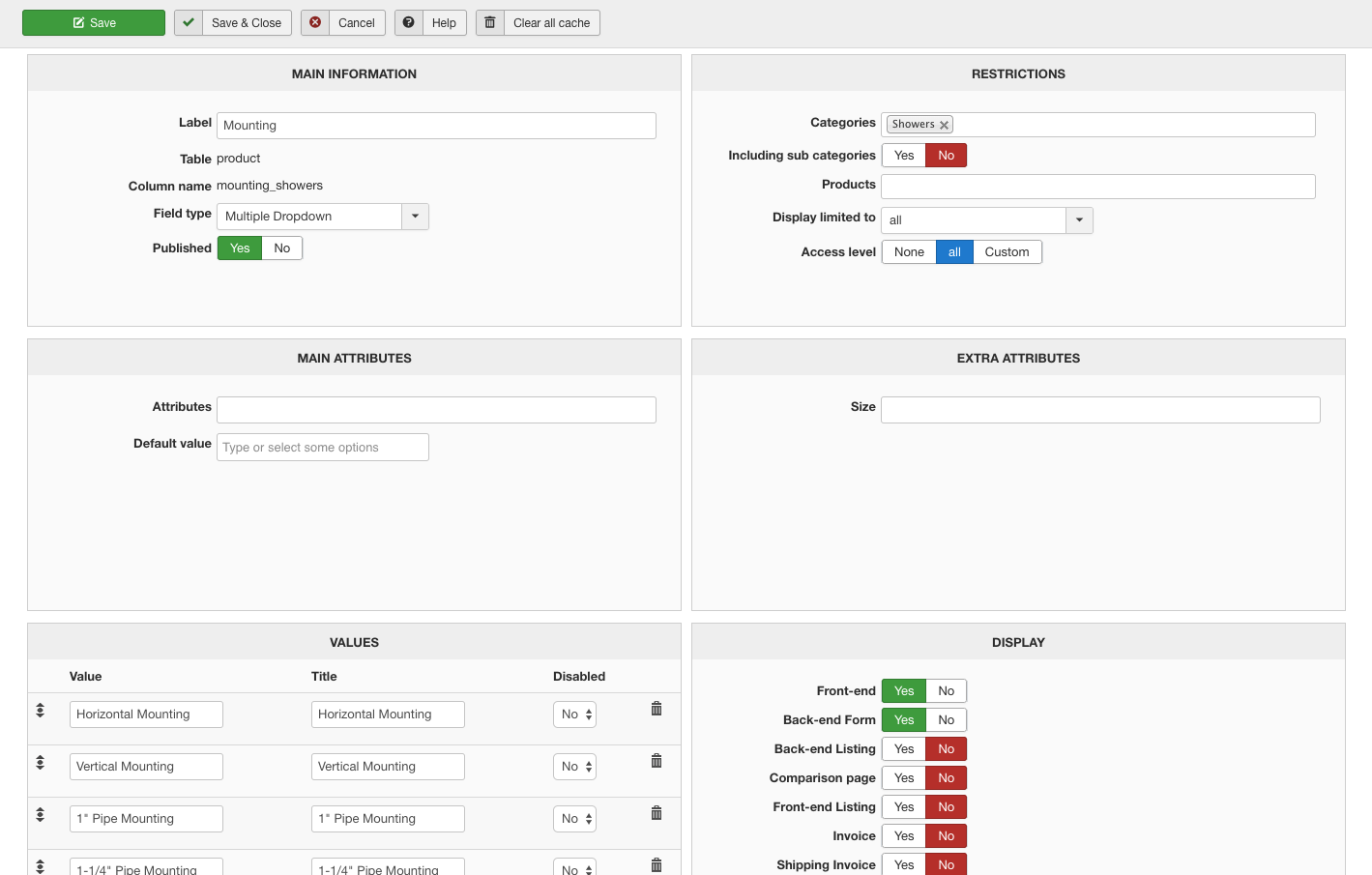

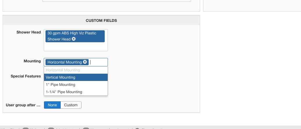

I have a multi-select custom field added to a product. When I navigate to the back-end of the product, make a selection or two from the multi-select and save, some values save and some do not.
An example: Multi-select custom field name "Mounting" with the following structure.
Mounting
- Horizontal Mounting
- Vertical Mounting
- 1" Pipe Mounting
- 1-1/4" Pipe Mounting
If I select Horizontal Mounting or Vertical Mounting or both, the values save into the product. If I select 1" Pipe Mounting or 1-1/4" Pipe Mounting the values do not save. It seems like the double quote in the value is causing an issue. Perhaps the custom field values need to html entity encoded before they're placed into the option value="" in the DOM.
6 years 8 months ago #314703
Can you provide theses elements in order to better understand the context ?
we need :
- A screenshot of your relative custom field setting page
- Any relatives elements that will help us to reproduce your configuration on our side
Awaiting news to progress on your subject.

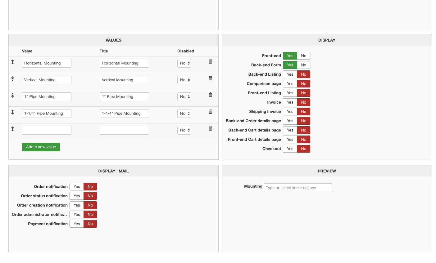

  • Posts: 11
6 years 8 months ago #314720
screenshots attached
