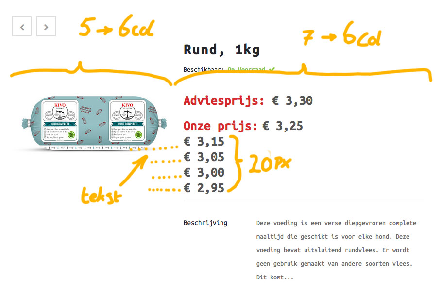

B.
Can anyone help me with some extra css to display these lines in a smaller font size?
C. [solved]
What is the name of the layout of the product page?
I want to change the width of both the left and right column from 5col/7col to 6col/6col
Thanks in advance

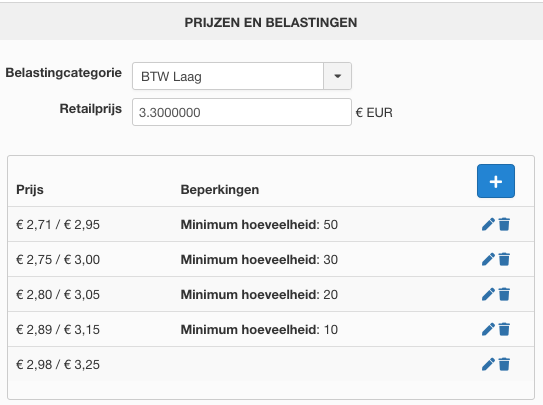

5 years 10 months ago #324733
"A. the strings; PER_UNIT_AT_LEAST_X_BOUGHT=" per stuk bij aankoop van minimaal %s" are not displayed.
I cannot find a reason for this
This will be displayed, when you define a price for a specific quantity, I mean :
1 item for 10 Euro
2 item for 8 Euro => Will display " 8 Euro per unit for buying at least 2 items"

Issue C is solved. I found the html
For issue B
Thanks, I found the classes and added this to custom css
.hikashop_product_price hikashop_product_price_1, .hikashop_product_price hikashop_product_price_2, .hikashop_product_price hikashop_product_price_3, .hikashop_product_price hikashop_product_price_4 {
font-size : 20px;
without the desired result
I stink when it comes to understanding css

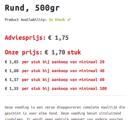

For issue A:
As you can see, in the screenprint, there ARE prices for more items.
nevertheless the text string is not displayed, hence my amazement, as in the other hikashop sites I have, these lines are there:
Last edit: 5 years 10 months ago by Formidog.
5 years 10 months ago #324815
"For issue B" :
Css isn't that complex, from what I can see their good chance that if that don't work it's only because your command haven't enough priority, see my example :
1. .html_element_class {command: value;}
2. .html_page_class .html_element_class {command: value;}
3. .html_page_class .container_html_class .html_element_class {command: value;}
4. .html_page_class .container_html_class .html_element_class {command: value; !important}
Here, the most priorty command is the last, so reproduce this kind of idea to increase your custom Css command priority.
Another, things good to be sure to be sure to go over the Css command, when you use your inspector tool is to check the most high css command :
Here, the most highest priority command is the red bordered one (the most high), so you have to built your selector with at least same selector part AND one additional html class.
"For issue A:"
There something that have been customized, OR that modify your html (sometimes the template modify the html) check these different elements :
1. Your translate file ( documentation )
2. Your overrideview ( documentation )
3. Process a test with a default template (like ProtoStar)
Make a precise return on these different points, please this will allow us to get the root issue.
Hope this will help to progress on your subject.
