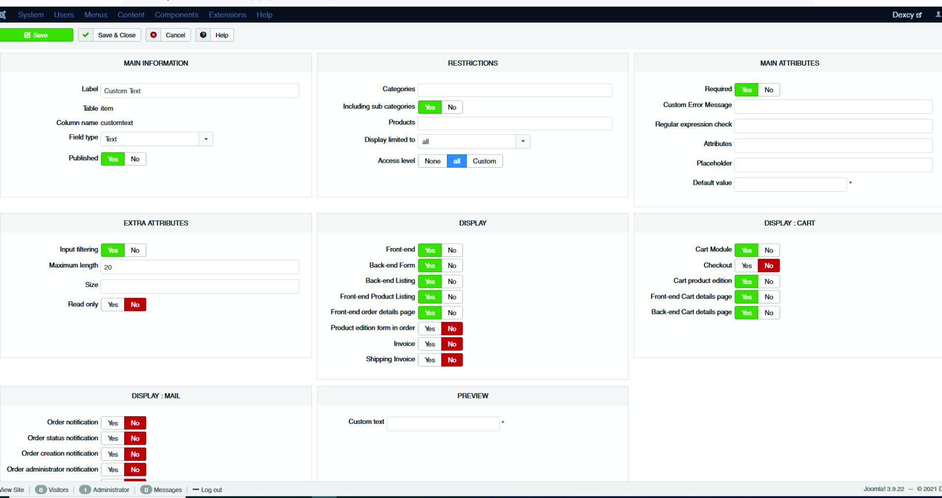

I tried to create a custom field for item and there is error again:
Warning
Copy failed: /web/administrator/components/com_hikashop/falang/hikashop_category.xml to /web/administrator/components/com_falang/contentelements/hikashop_category.xml
and yes, it for for "table : item" and not for category
also, there is no any mention about these field in the product details.... so I cant configure it
Thx

Custom item fields are indeed not showing on the backend since their role is to allow the customer to enter things in them on the frontend.
If you want to enter things in custom fields on the product edit page so that they can be displayed on the frontend, you need to create custom fields of the table "product".
However, that doesn't mean that custom item fields have to display to all the products.
If you edit the custom item field via the menu Display>Custom fields, you can see a setting "categories" and a setting "products" so that you can restrict the field either to several categories or several products.
Also, one nice trick is to configure an unpublished category with the name of the custom item field and select that category in the "categories" setting of the custom field.
Then, in each product edit page, you can just add that unpublished category in the "categories" setting of the product so that the corresponding field will appear on the frontend for that product while it won't for the other products, without having to edit the custom field settings.

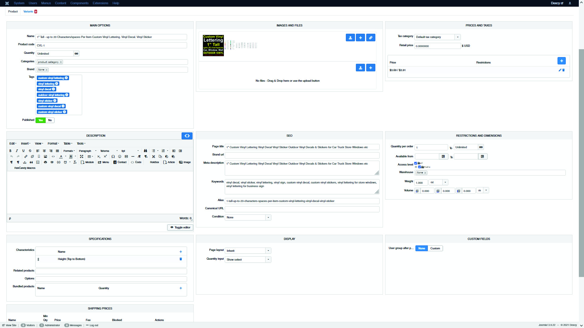

One more thing, is that I'm not able to get sales tax for only 1 sate - virginia
I created a tax zone for virginia, but it's still applying taxes for every address
Also, When I add variations, then add price in the "Price" field" it shows the price, but doesnt show price in the cart... instead, it says it's free
So, I added had to add "restriction" in every variation (one more pain in the back to go to every variation and do so many unnecessary actions)... and in that case, prices are shown in the cart, but prices are already include sales tax.... and then one more, the same sales tax is added on the total for any address you use...

Regarding the price of variants:
If you don't set any price in a variant, it will automatically use the prices of the main product. And if you see the word free for a variant in the cart, it probably means that neither the variant nor the main product has a price for the quantity of the product in the cart. I find it strange that you says that the price then displays in the cart when you add a restriction to the price of the variant. What restriction did you add ?
Now I would need a screenshot of the settings of the variant and a link to the product page on the frontend to be able to check the situation and say anything for sure.
