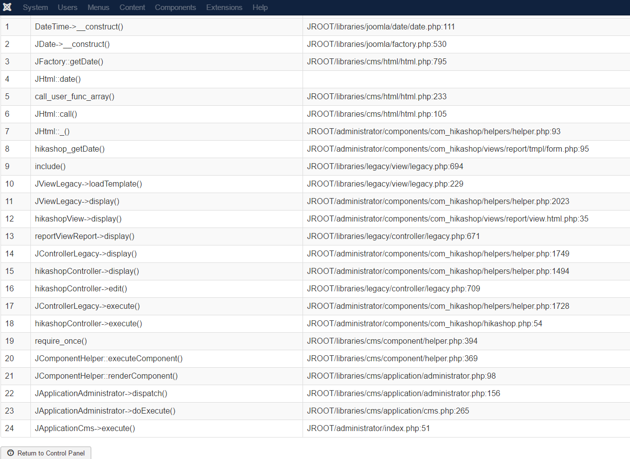

-- Error-message(debug-mod must be tuned on) -- : 0 DateTime::__construct(): Failed to parse time string (-001-11-29T23:40:28+00:00) at position 7 (-): Double timezone specification
Hi !
After update to the latest J! version today, wanting to edit my report, i get the following error :

  • Posts: 86187
9 years 3 months ago #270268
I don't know why you have that but the first dash shouldn't be there in the date.
Change the line:
return JHTML::_('date',$time,$format,false);
to:
return JHTML::_('date',ltrim($time,'-'),$format,false);
in the file administrator/components/com_hikashop/helpers/helper.php and that should prevent that issue from happening.
Please report back on the result.
