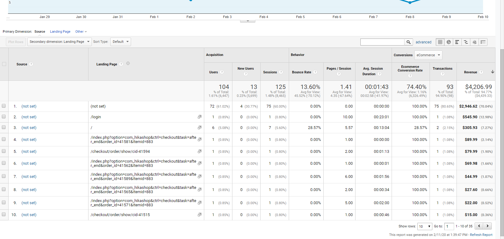

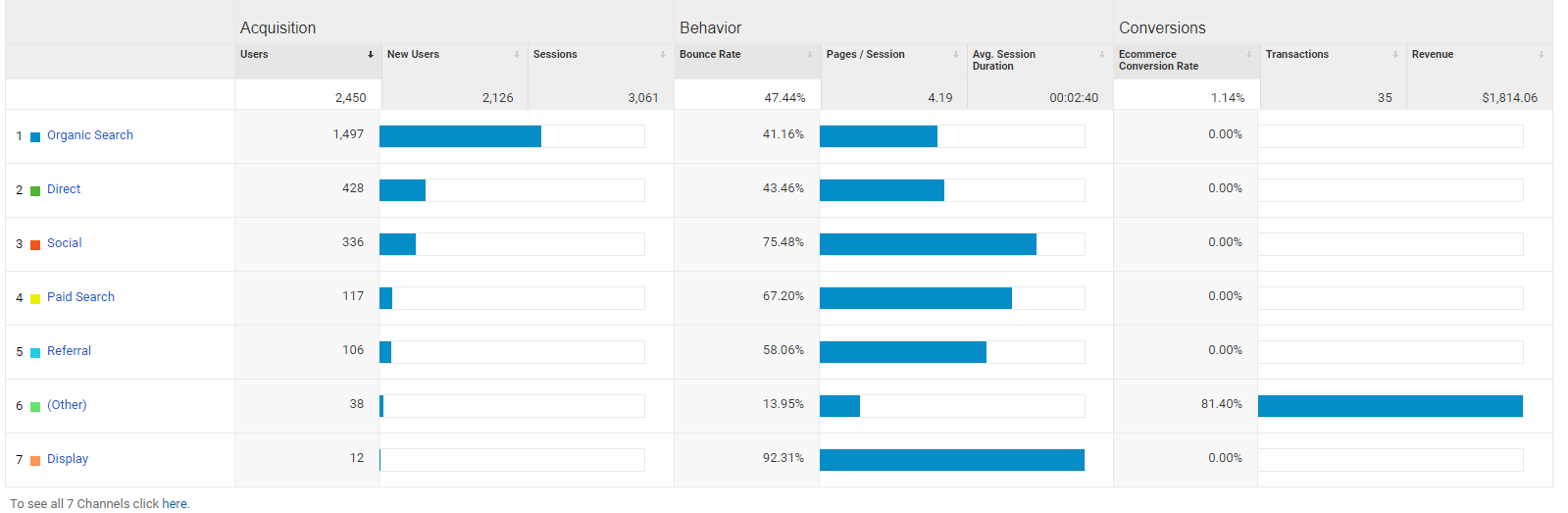

Not sure if this is on the Hikashop side or GA side.
Description of problem:

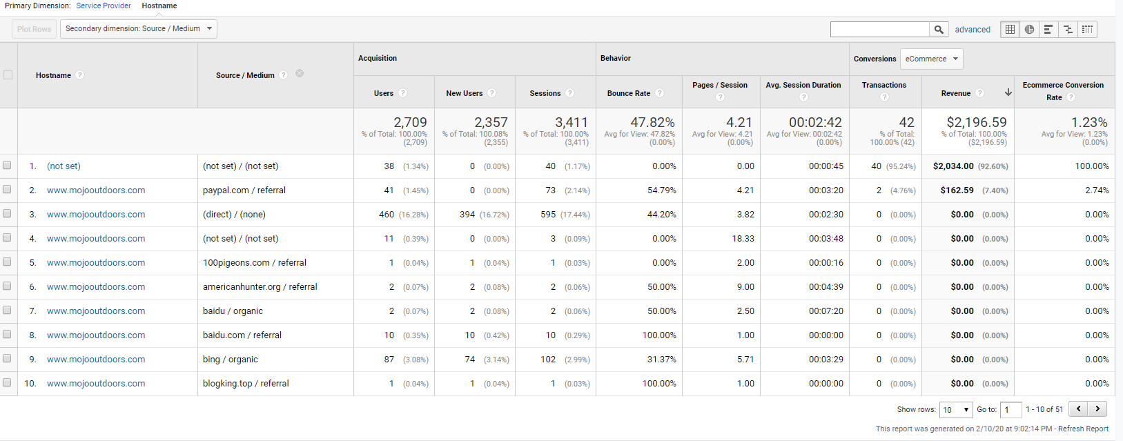

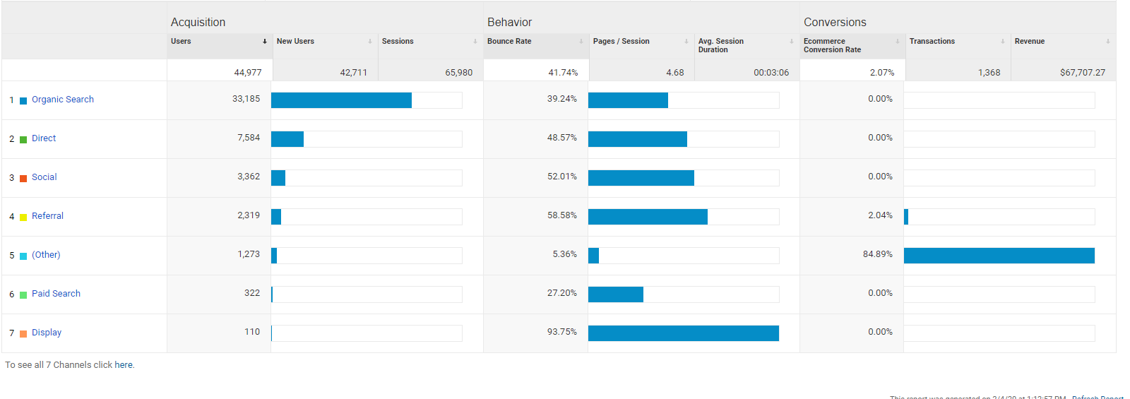

Google analytics reporting lumps all sales on website into the "Other" category. Upon further inspection, 99% of these are logged as "(not set)", implying there's either a lot of users using ad blocker, something is breaking in the direct call or there's some other thing going on with our checkout or GA that's preventing the correct logging.
Screenshot of data logged in GA:
Screenshot of Hikashop GA plugin:
Most other statistics on referral traffic to the site are being tracked properly. The only delta seems to be the actual transactions. E.g., our facebook pixel tracks all traffic from watching ads or viewing our facebook page that get funneled to our website and converts to a sale. This accounts for a large number of sales on our website. By this logic, we should have a large percentage of transactions from Facebook. However, we do not.
Any help with this issue or things i should check to T/S would be appreciated.

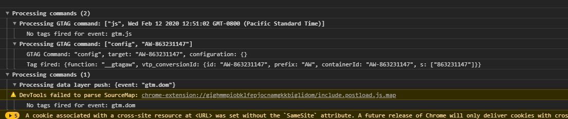

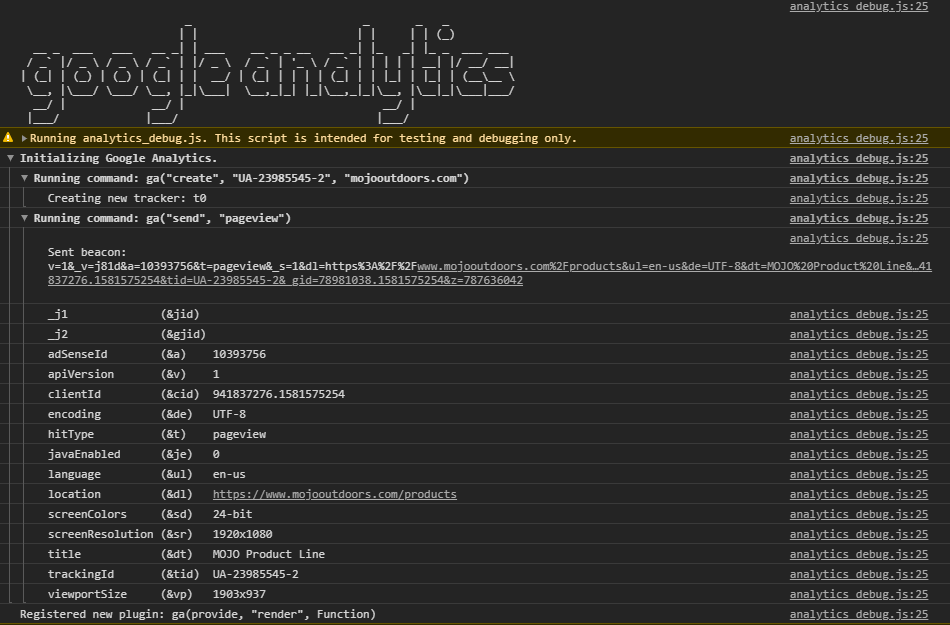

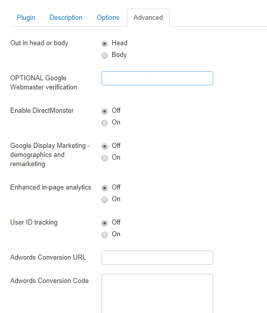

6 years 7 months ago #315616

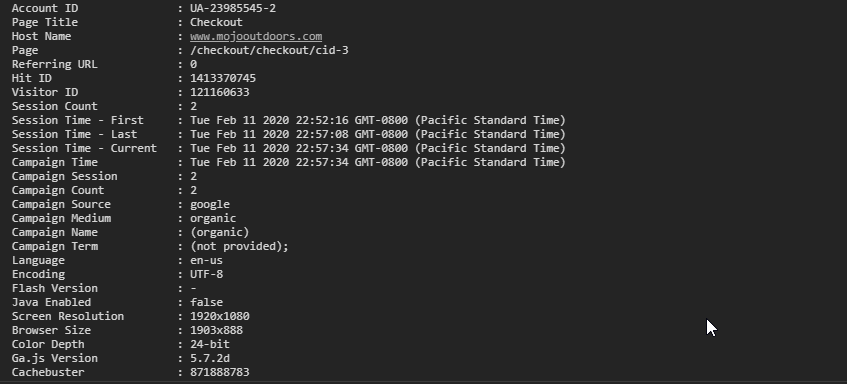

After some further investigation, i noticed my current GA plugin wasn't reporting the campaign, source, etc. properly. I unpublished the current one (Google Analytics Pro by Peter Bui) and reverted back to the Nice google analytics plugin.
After using the google analytics debugger, the campaign, source, etc. seems to be showing properly. However, after this change, the order_params are now missing (traded one problem for another).
While this did not fix the problem, it at least shows the behavior can be changed through the GA plugin. Maybe there's some conflict in my Hikashop GA plugin settings? I'm using universal with the following settings:
GA analytics Pro by Peter Bui settings:
Please let me know if you need any further data.

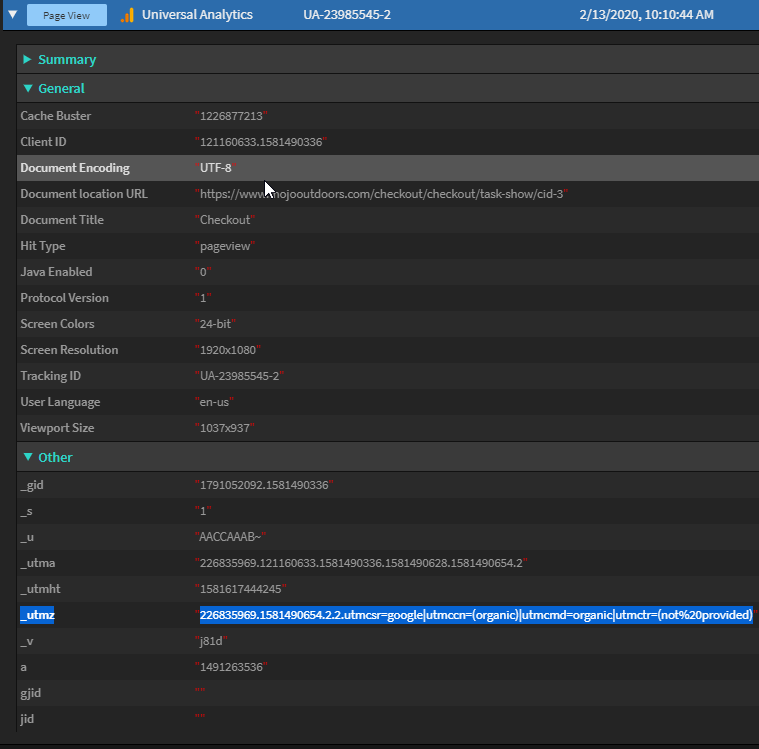

6 years 7 months ago #315681
Google and most other search engines are automatically tagged by GA for organic and GA should know that the user accessed the website directly (bookmark or typing URL in browser). UTM parameters in this case are not necessary (according to GA docs). For social, referrer, ads, etc., UTM parameters must be present for GA to properly assign each session/pageview/conversion.
With that being said, I'm not exactly sure how GA tags as organic or direct but it appears this information is lost either as soon as the user lands on our website (e.g., clicking google search result or typing www.mojooutdoors.com in browser). I've done these two tests multiple times and cannot see organic or direct as source after the purchase is made.
After speaking with Google Analytics rep and seeing what each piece of the GIF request that is sent back to GA, it appears that the campaign, source, and medium values are stored within the 'utmz' variable.
__utmz identifies traffic sources, campaign, medium, etc.:
http://springest.io/anatomy-of-google-analytics-cookies
An example from our website using omnibug plugin for chrome:
In this case, i have accessed the product via google search and it is properly identifying as (organic), but this info is not being passed back to GA after checkout is complete (from Hikashop side). Not entirely sure how you guys handle passing the data back to GA. I see in the plugin file that you look for utm_source, utm_campaign, etc. but not for the other utm parameters to pull this information. Is it possible that the hikashop plugin is overwriting the already collected utm parameters?
I can see with omnibug that even after redirect back to website from paypal, i still retain __utmz with the source, campaign, etc. The content of this variable is probably what needs to be transmitted from hikashop google analytics plugin to GA.
More info:
https://developers.google.com/analytics/resources/concepts/gaConceptsTrackingOverview
Let me know what you think?

Has this ever been solved "for everyone"? I have exactly the same problem - and I see that there was some "secret" version send to the original reporter. How do I solve this? Just to baseline I have exactly the same problem:
1. I'm running a Google Ads campaign
2. Google is correctly setting up query params/cookies when someone clicks the ad.
3. I can see incoming traffic from this ad in my google analytics.
4. I know people are "converting" - I've set up a custom conversion in GA which fires off on confirmation screen.
5. E-commerce tracking in principal works - I can see the orders information in GA.
6. None of the transactions are marked as coming from my ad - even though I know thanks to point 4 - that actually some of them bought something (but with simple conversation tracking I don't know how much they have spent - this is where I need HikaShop's E-commerce tracking).
Help!
  • Posts: 431
  • Thank you received: 22
5 years 7 months ago #329601
I found this topic and have same problem. All transactions are as "Other" acquisition.
Have latest Hikashop.
Have you manage to solve this?
