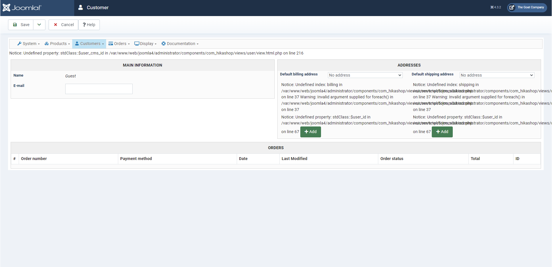

-- Error-message(debug-mod must be tuned on) -- : Report widgets not working correctly.
Notice: Undefined index: billing in /var/www/web/joomla4/administrator/components/com_hikashop/views/user/tmpl/form_address.php on line 37 Warning: Invalid argument supplied for foreach() in /var/www/web/joomla4/administrator/components/com_hikashop/views/user/tmpl/form_address.php on line 37
Notice: Undefined property: stdClass::$user_id in /var/www/web/joomla4/administrator/components/com_hikashop/views/user/tmpl/form_address.php on line 67
Default shipping address
No address
Notice: Undefined index: shipping in /var/www/web/joomla4/administrator/components/com_hikashop/views/user/tmpl/form_address.php on line 37 Warning: Invalid argument supplied for foreach() in /var/www/web/joomla4/administrator/components/com_hikashop/views/user/tmpl/form_address.php on line 37

2 years 10 months ago #354602

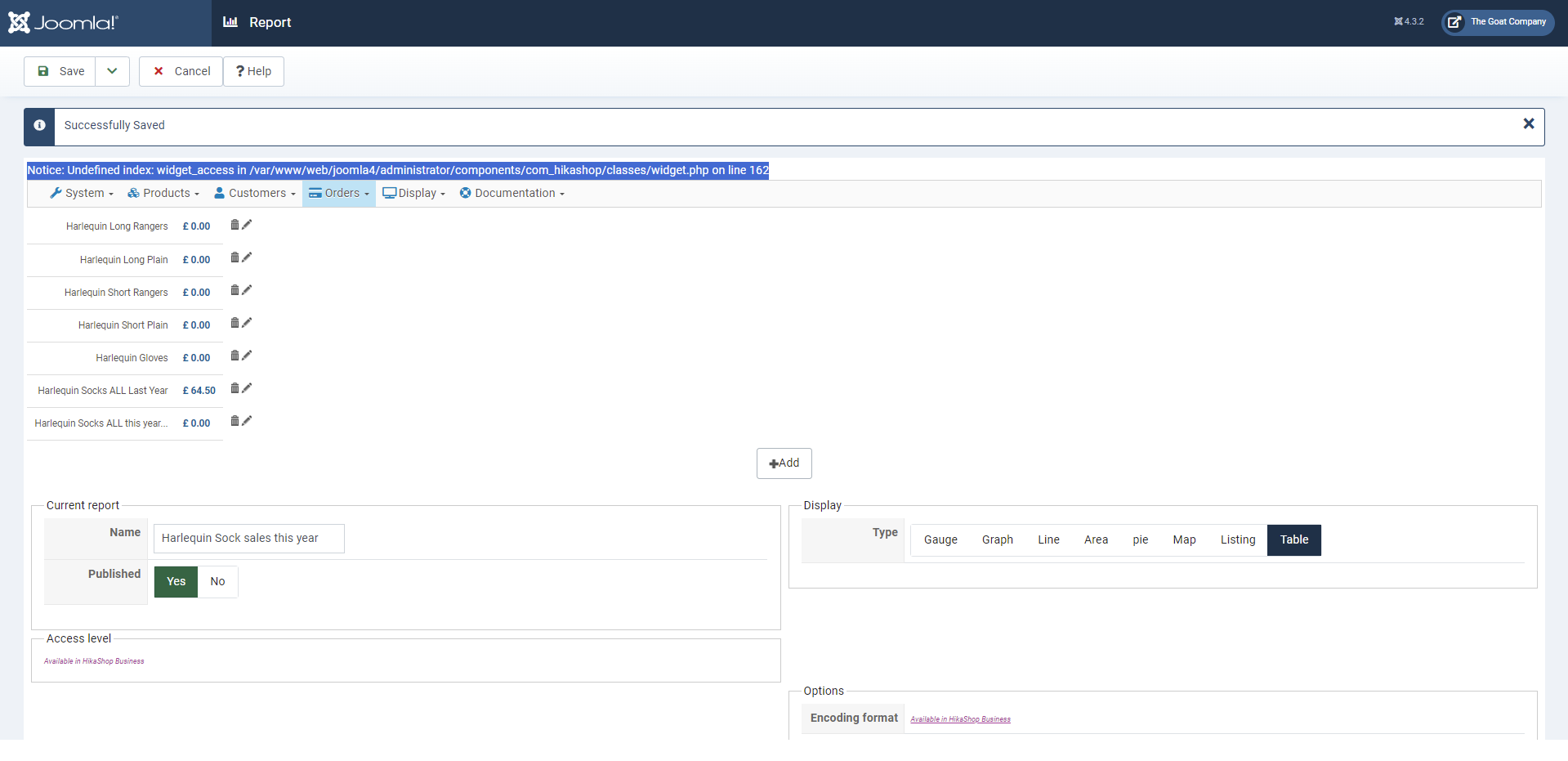

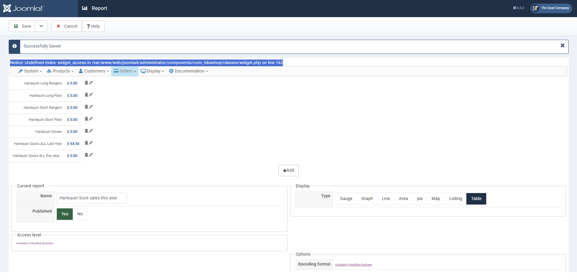

Your message is about errors with the widgets which don't work.
But on your first screenshot, I do see the widget settings successful saving message, indicating that the save worked, and the widget is displayed below.
There is a notice message, which we will fix, but that shouldn't prevent you from using the widgets. In fact, that notice was already there for years. I suppose you didn't see it because you have the "error reporting" / "debug" in the Joomla configuration turned off.
So I'm still not clear on what is the problem with your widgets ? Are you just reporting that notice message ? Or do you have errors which prevent you from using the widgets ? What are these errors then ?

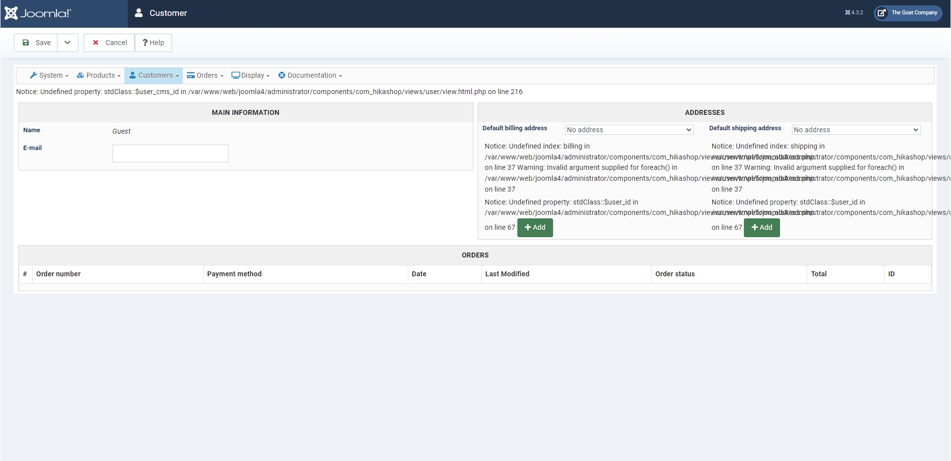

The second screenshot comes from the edit page of a guest user , as if you were trying to edit the settings of a user which doesn't exist. How did you access that page ?

2 years 10 months ago #354603
I accessed that page under Administrator...

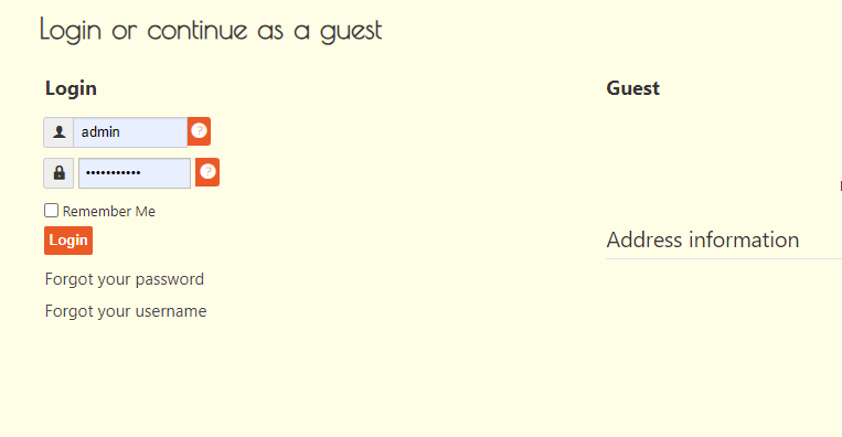

2. What do you mean by "the "hikashop_checkout_login_form" has lost its formatting as well" ? Please provide precise information.

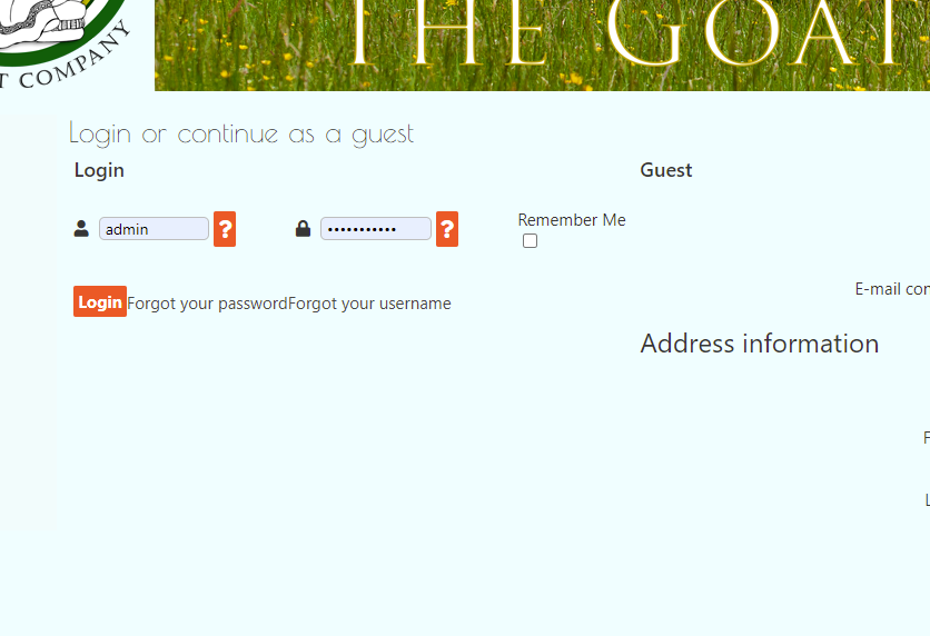

I went ahead and checked your website login form on the checkout, and the only thing I can see is a warning message:
i.imgur.com/BUI1jzl.png
This warning message can be removed by turning off the "error reporting" of the Joomla configuration page. That setting should be turned off on a live website for security reasons anyway.
Also, this warning comes from a view override file in your template ( in the file templates/newskin2017/html/layouts/joomla/form/field/password.php ). So you should:
- report the warning to your template provider support.
- you can try renaming that file to something else via FTP in order to deactivate it and see if it works without the warning that way.

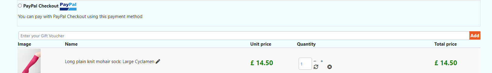

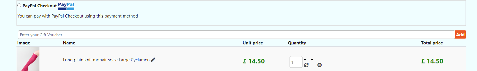

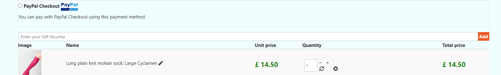

2 years 10 months ago #354729

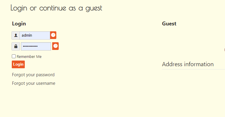

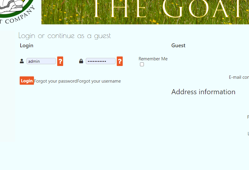

I think it's a problem with the new bootstrapv2 again.
When you looked at it the other day I must have disabled the "Use bootstrap v2 design" at that point as I was trying to work on it...
This is what I get when I enable the "Use bootstrap v2 design" on Joomla4:
This is Joomla3 "Use bootstrap v2 design" enabled:
So as you can see I'm not getting the same results with "Use bootstrap v2 design" on Joomla4.

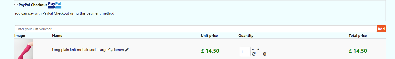

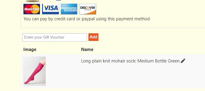

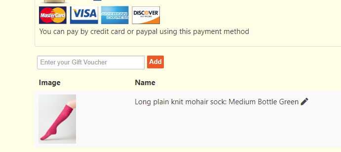

And another issue on the checkout page is the voucher field, can not for the life of me find out how to reduce the width??:
In Joomla4 I'm getting this:
Hope this makes sense?
Thanks for you patience Nicolas :-)
All the best
Ian
  • Posts: 85837
  • Thank you received: 14097
2 years 10 months ago #354734
Note that Joomla 3 included by default bootstrap 2.
With Joomla 4, we have boostrap 5 in it.
So most templates for Joomla 3 were based on boostrap 2, while most templates for Joomla 4 are based on bootstrap 5.
If you activate that option, you'll get HTML code specific to bootstrap 2. So unless your template is specifically made with bootstrap 2, it won't display properly. That's why this option is disabled by default.
Going forward, you'll likely want to keep that option turned off.
Regarding your coupon, the issue is linked to your template CSS. It bascially forces all the input fields to take the maximum width available in the area where they are being displayed. You'll need custom CSS to counteract this for this field.
For example:
.hikashop_checkout_coupon_field {
    flex: none !important;
The following user(s) said Thank You: ianspeed

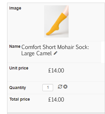

2 years 10 months ago #354779

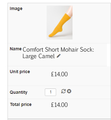

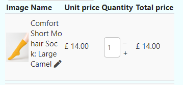

I expected the the DIV'S to collapse for each product and to just not squash the table horizontally?
Currently:
So you would have:
product image
description
Quantity
Price
total
Many thanks
Ian
Last edit: 2 years 10 months ago by ianspeed.
2 years 10 months ago #354787
Can you process somes tests :
- With a default template (Cassiopeia)
- Without any custom css in your Css Options part (Main configuration => Display tab)
Make your returns
