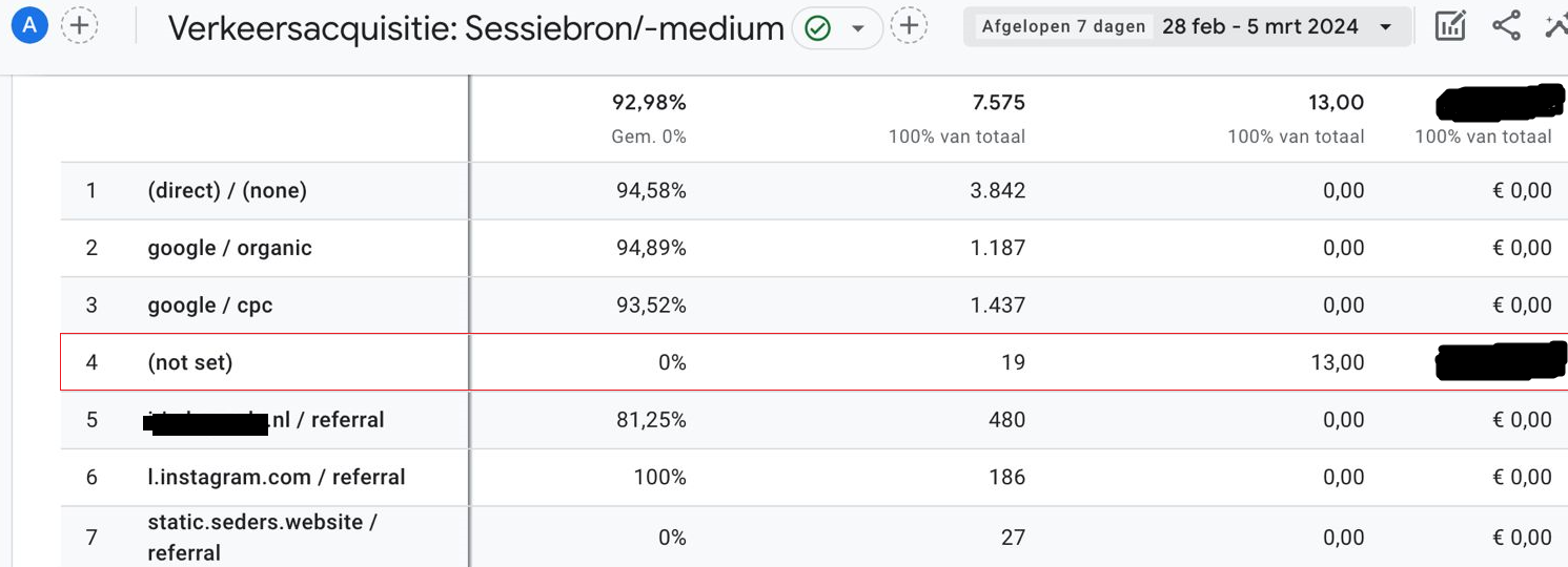

My ads manager asked if i can ask how to perfect the plugin connection for sales details.
He mentioned it has probably to do with "datalayer" but i am not skilled at all.
Could someone skilled in the GA4 plugin and how it should work in GA4 and gtag/ads check my attachment to see why we only get "not set" results on all sales and how to specify in gtag/ga4 what kind of sales they actually are?
Kind regards.
  • Posts: 86101
  • Thank you received: 14203
2 years 6 months ago #359589
I don't know how that works either.
Looking online, it seems you could add view overrides to add extra javascript code to push events and data to GA:
developers.google.com/tag-platform/tag-manager/datalayer
I'm not sure.
Here ( stackoverflow.com/questions/14352440/how...-the-traffic-sources ) it says that you can configure GA to set the source of the events... Maybe that's what you should do ?
Your ads manager should know more about this than me.

  • Posts: 147
  • Thank you received: 8
2 years 6 months ago #359603
I checked some sources and discarded what could not be the problem, and i ended with this probability:
"Measurement protocol is not implemented correctly. The developer is sending events to GA4 without including a correct session_id. And if the event is sent to the past (up to 72 hours), then timestamp_micros parameter is not included (or it contains an incorrect value).
session_id parameter must contain a value of a session that was already tracked by GA4 on the website (client-side). If a developer randomly generates the session_id, the source/medium will be (not set).
If the event is sent to the past, the developer must include a valid session_id and it must include the timestamp (with timestamp_micros parameter) of when that session was actually happening on the site."
Is there a chance this is the issue in your opinion? Thanks
