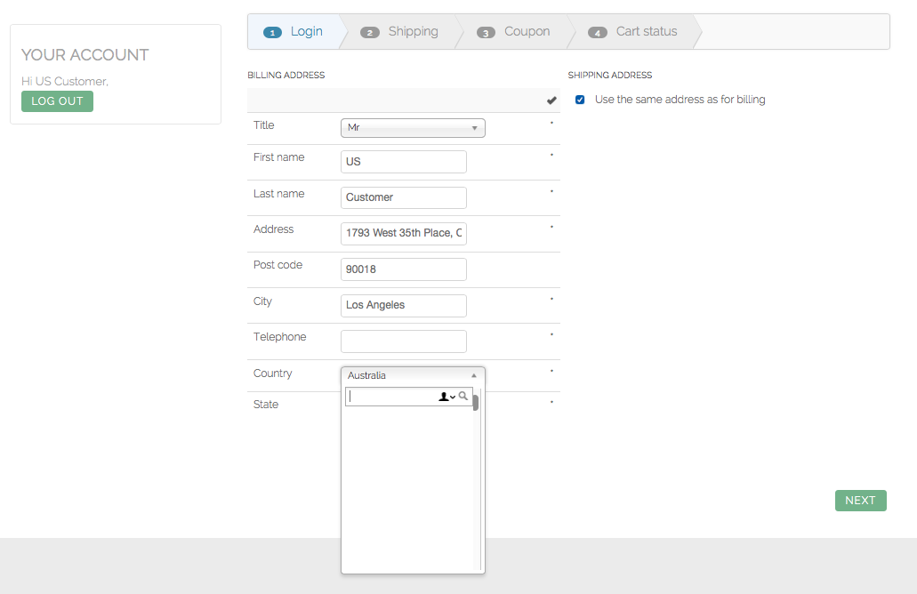

We are in Australia. Thought we had free shipping in Aus only but an order from the US came in without shipping so we are selling a product that doesn't cost as much as the transport. Tried setting a default $25 flat rate overseas shipping but when I log in as an OS customer I don't see it as an option. The step "2 Shipping" only has payment info and lists the chosen method as "free shipping in Australia".
When I tried to log in as US customer using Safari, the drop down list of countries was blank. It did not respond to search and always bounced back to Australia. GRRRR! Used Firefox to get around that but I bet customers won't. See attached png.
Can you give us a temporary access to your back-end so that we can directly test and debug it ? You can send it via :
Please, don't forget to also add the link to that thread so that we can quickly identify for what these access were sent.
