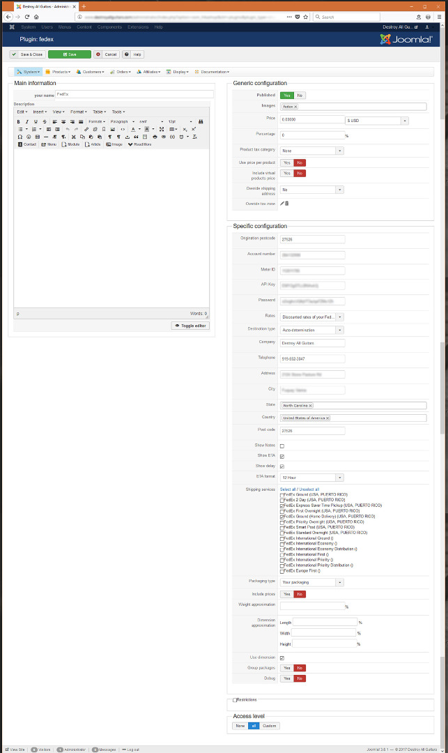

Please provide details regarding your Fedex shipping plugin configuration (screenshot).
  • Posts: 39
8 years 8 months ago #284616
Screenshot attached...

Changing the value of "Packaging type" and "Group packages" options will probably help you change the rate returned from the FedEx platform.

In my case, choosing any packaging type other than "Your packaging" yields error messages indicating that the chosen package type will not accommodate the weight/dimensions of our product. (24 lbs and 45x18x8 inches is our lightest product.)
Additionally, selecting "Group packages" does not repair the incorrect rate. We would not try to use this option in any case since the smallest package we ship is 51 lbs and 27x14x15 inches - far too heavy and large to be combined with anything else.
I understand that the FedEx plugin will only send product info and return prices. This is all I want it to do, but in this regard it appears to be failing, at least in my case.
