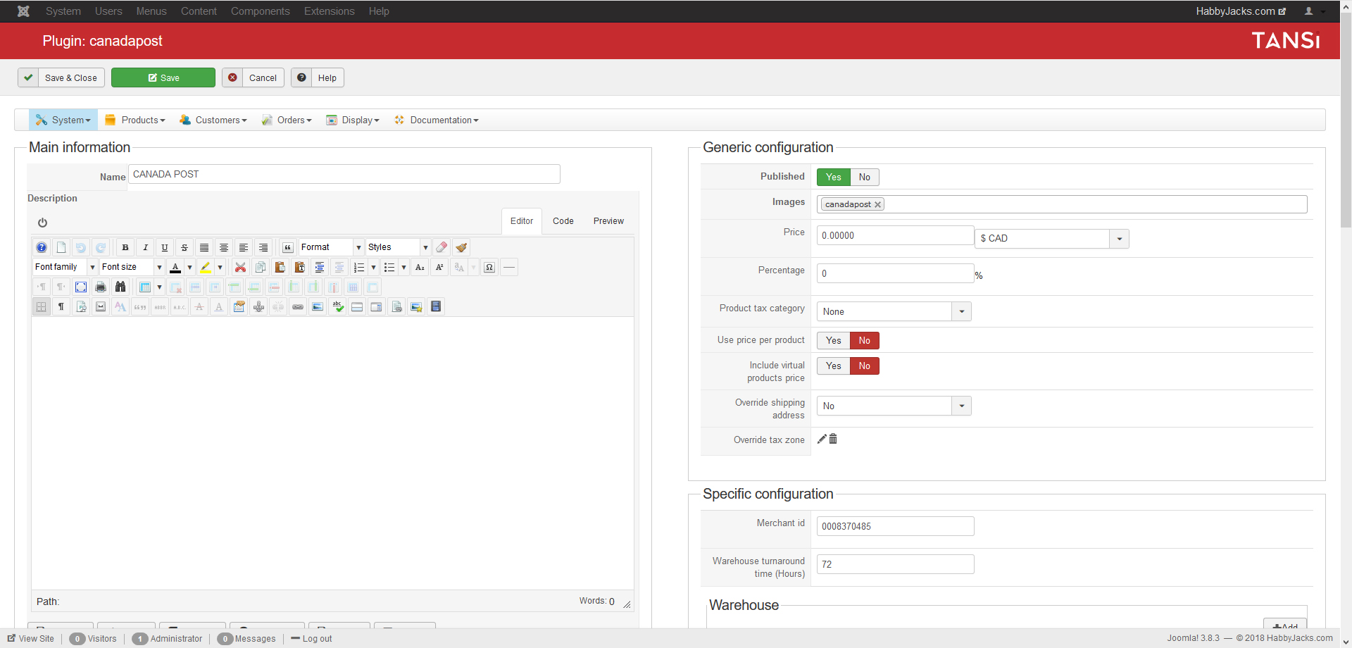

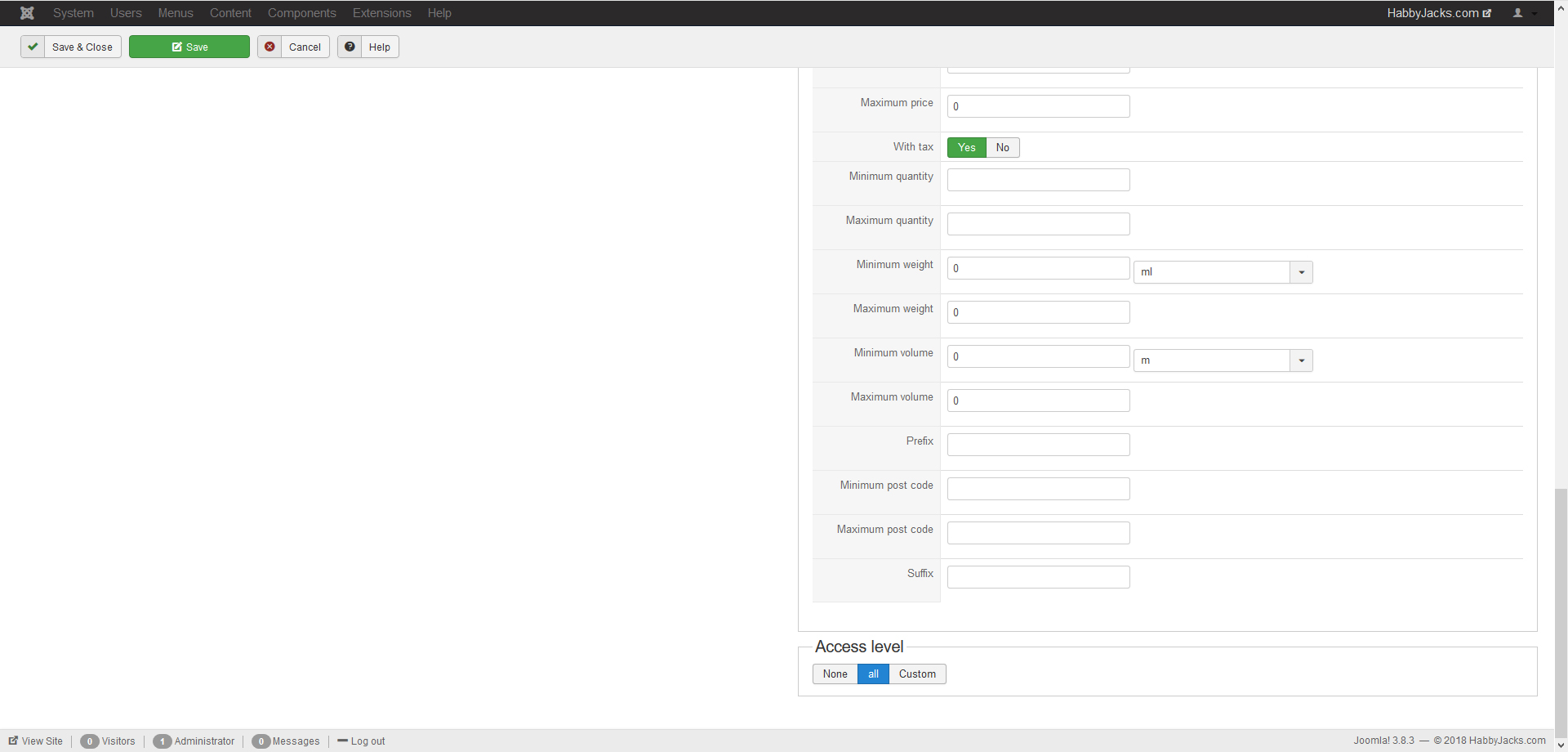

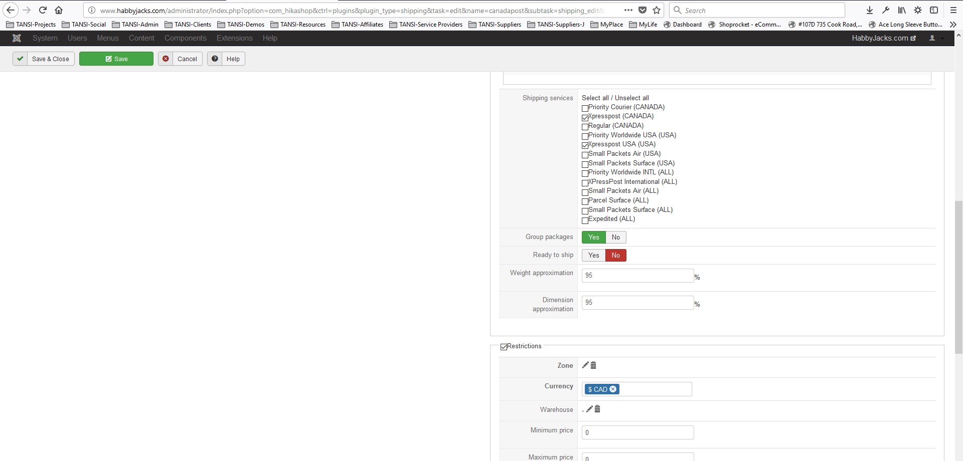

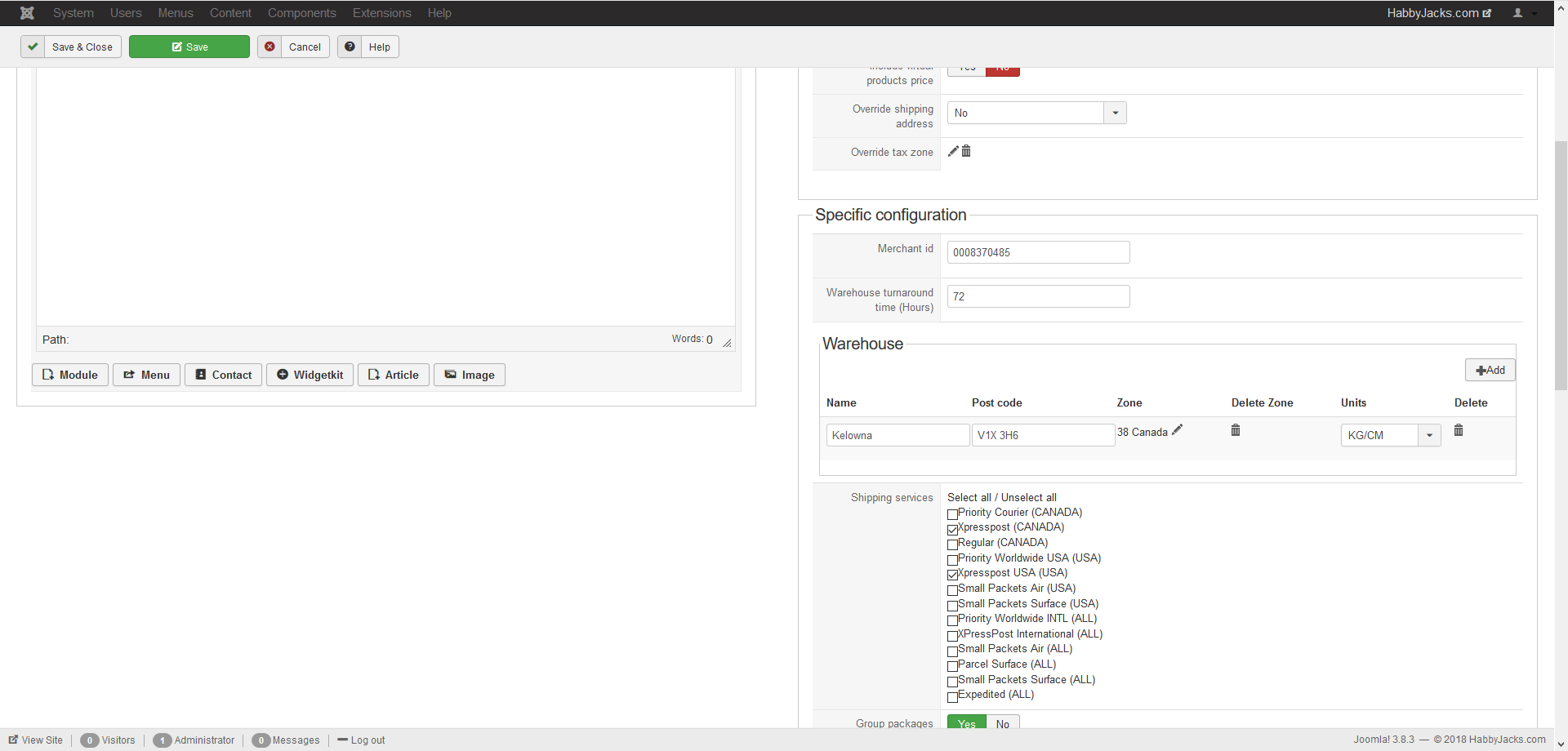

  • Posts: 33
8 years 8 months ago #285564
Please see attached
Last edit: 8 years 8 months ago by jukeboxjunkey. Reason: added attachement
8 years 8 months ago #285583
Can you try it without any space on your the "Post code" option of your canada post warehouse configuration space ? Also, you should contact the Canada Post platform regarding the "Error code: -2001. Message: Merchant CPC Id not found on server." error message, it generally means that your credentials aren't valide or enabled.
Best regards,
Mohamed Thelji.
