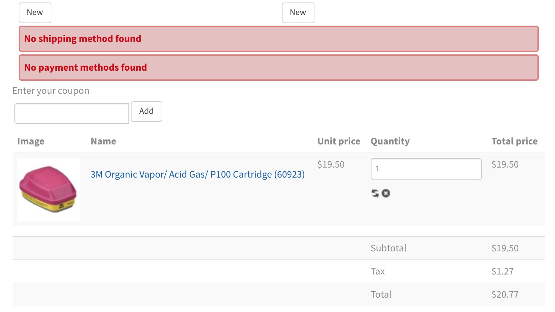

-- Error-message(debug-mod must be tuned on) -- : UPS - No shipping method found

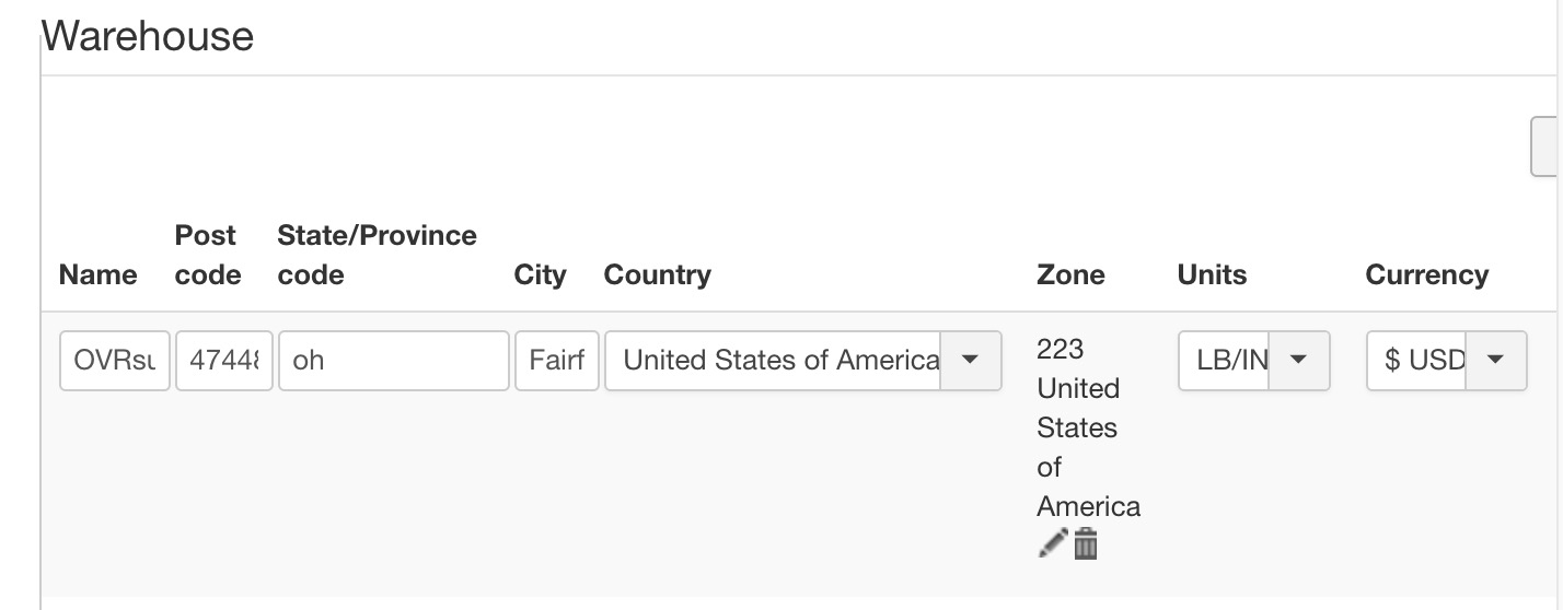

This is my first post on Hikashop's help forum. AND... my first time using Hikashop.

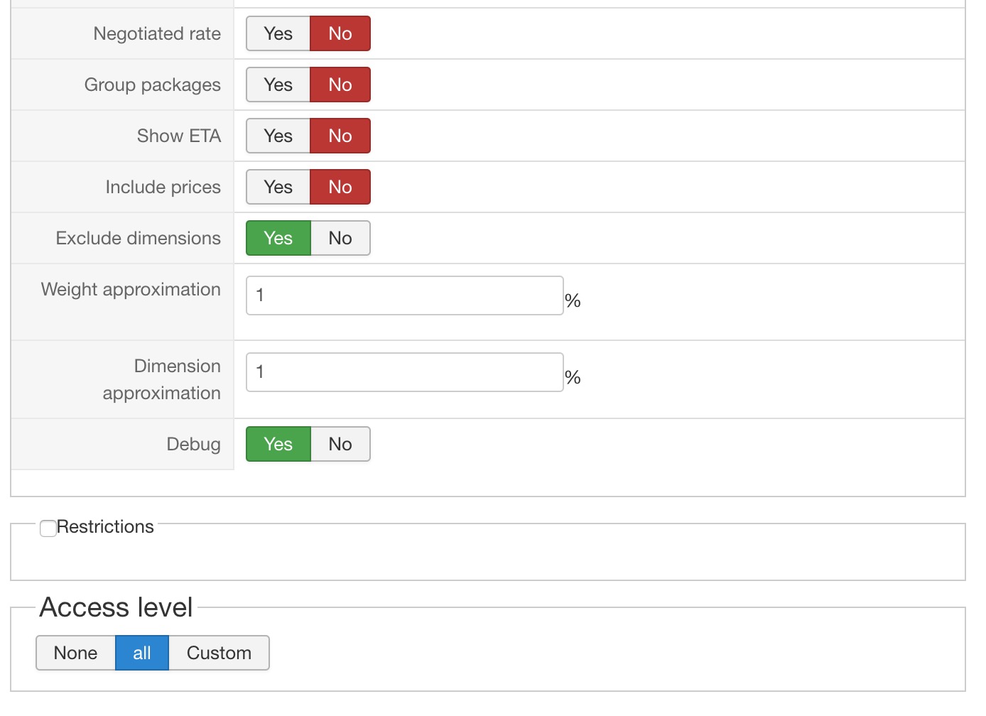

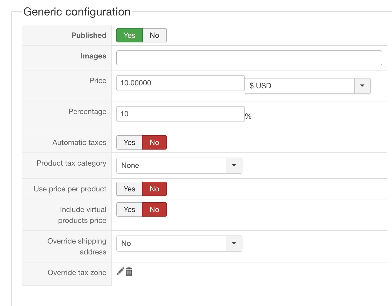

PLLLLLease Help me fix the message "No shipping method found" in checkout. For many many hours I've search the forum and read many many articles on this issue... I've tried many many fixes... YET, no joy???
I have set this up with the exact same credentials and settings on another client's Hikashop site and it's working perfectly? But on this site it's not working.
See attached screenshots on the setup.
Please advise if you need admin access to take a look inside?
Thanks in advance for the help.

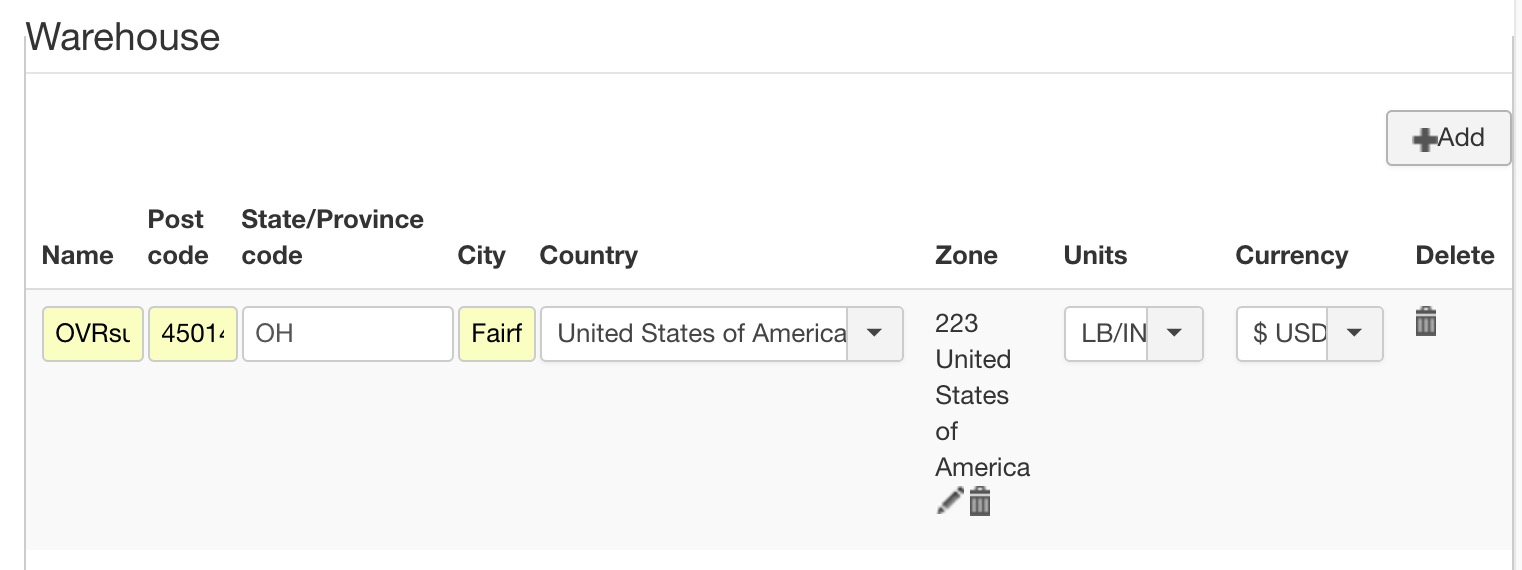

Also, your issue can eventually be coming from the "Zone" option of your UPS warehouse tab.

7 years 11 months ago #295684
Hello Mohamed,
I still cannot solve this issue. I can't believe that this setup is so so so difficult. What could I be doing wrong????????

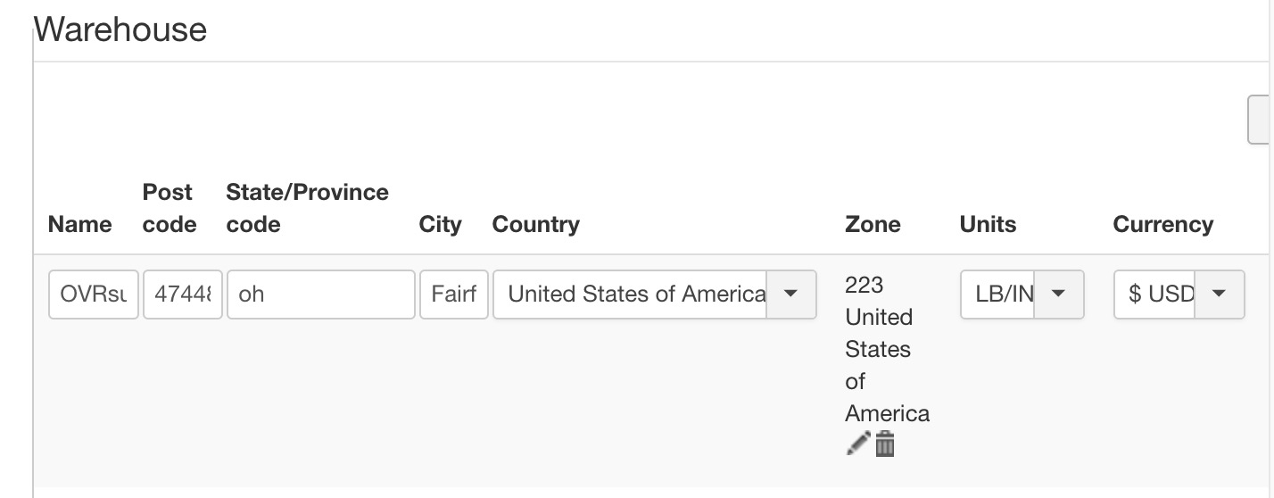

You said: "Also, your issue can eventually be coming from the "Zone" option of your UPS warehouse tab."
I have this set to "United States of America" and the zone set to "223"... it this correct?
NOTE: I have this fully working on another site with the same UPS user info... It works perfectly!!! BUT, NOT on this new site? I compared ALL know elements and settings and they match completely?
Please take a look at: OVRsupply.com
If you (OR anyone?) would like to log into the admin and check the configuration... Please let me know. I have a admin account already setup for the help.
PLLLLLLLease... someone help me before I have to totally abandon HIKASHOP. I really want to like this component.

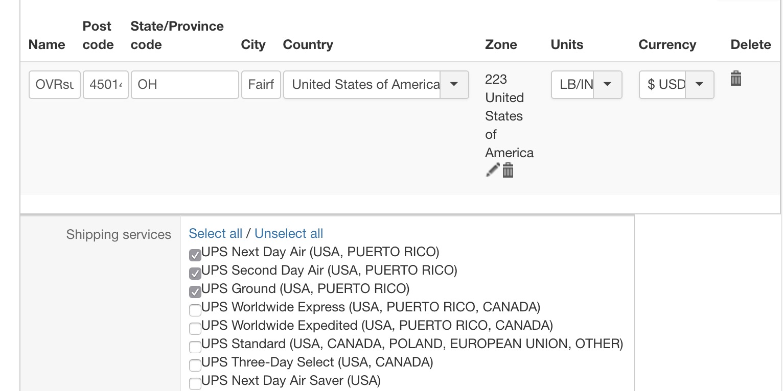

7 years 11 months ago #295742
Hello Jeremy,
Thanks for your response... YES!!! All the products have weight and dimensions
This has been the most frustrating issue I've ever had working with a Joomla component. Again, I've been able to set this up with another existing site with No issues... Yet, I cannot get this site working.
NOTE:

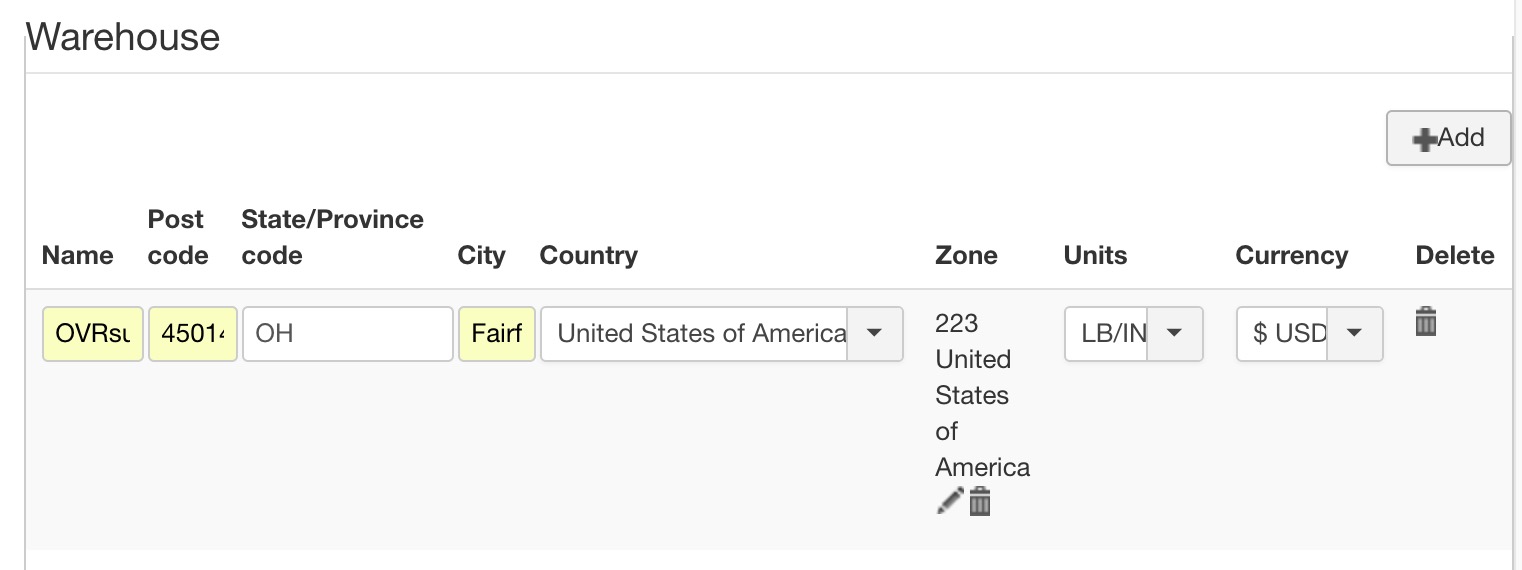

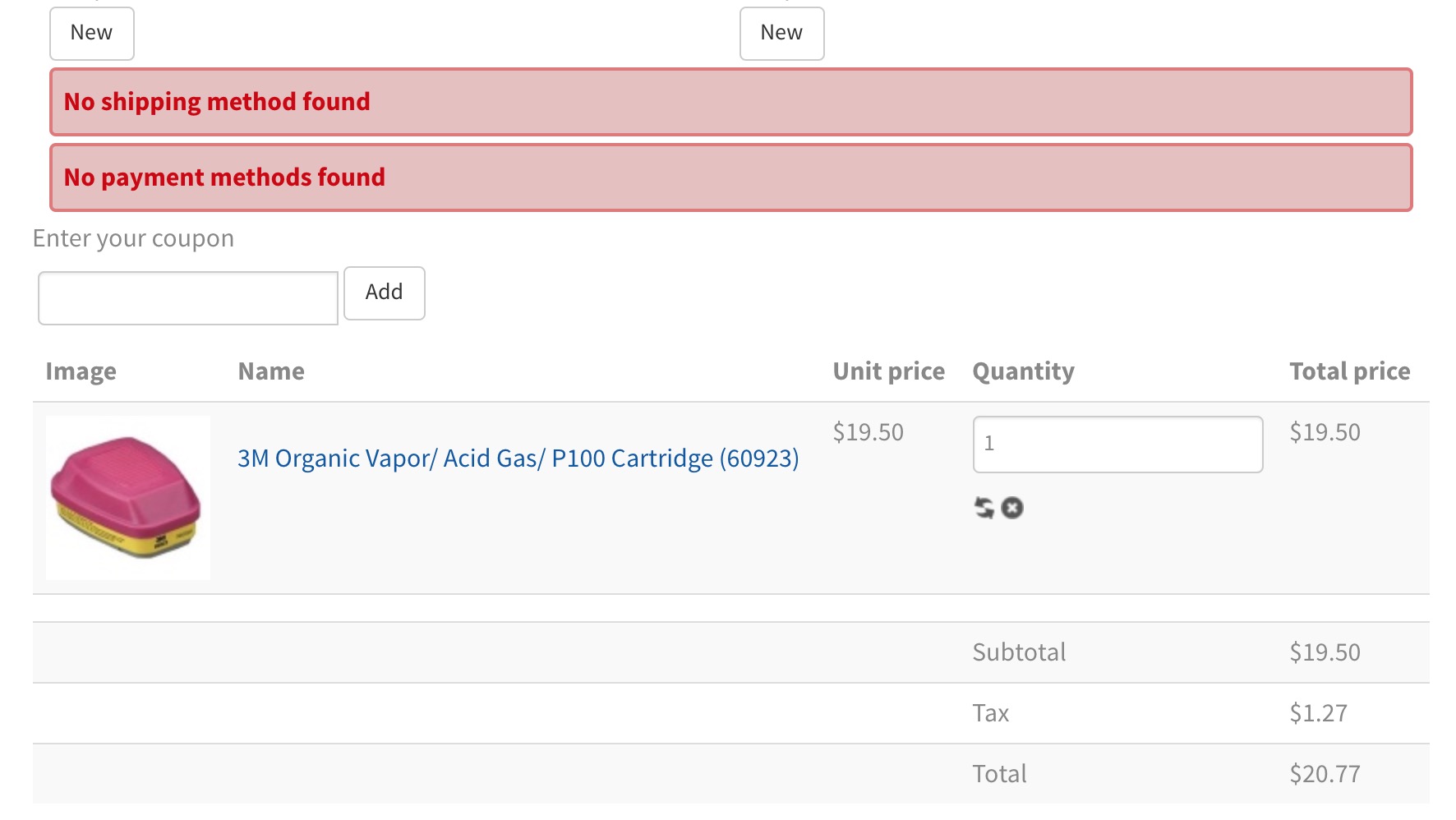

1. When I remove the UPS "warehouse" totally, I get the following error "no_warehouse_configured."
2. When I recreate the UPS "warehouse" using our warehouse address info (OVRsupply.com, 45014, OH, Fairfield, United States of America, 223), I get "No shipping method found."
See ATTACHED.
I've spent countless hours of the last few weeks.... STILL NO FIX!!!! Please Hikashop... Help me! This should be this hard to figure out?
Last edit: 7 years 11 months ago by shockoe.

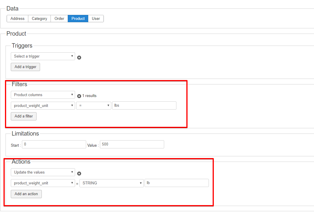

7 years 11 months ago #295823

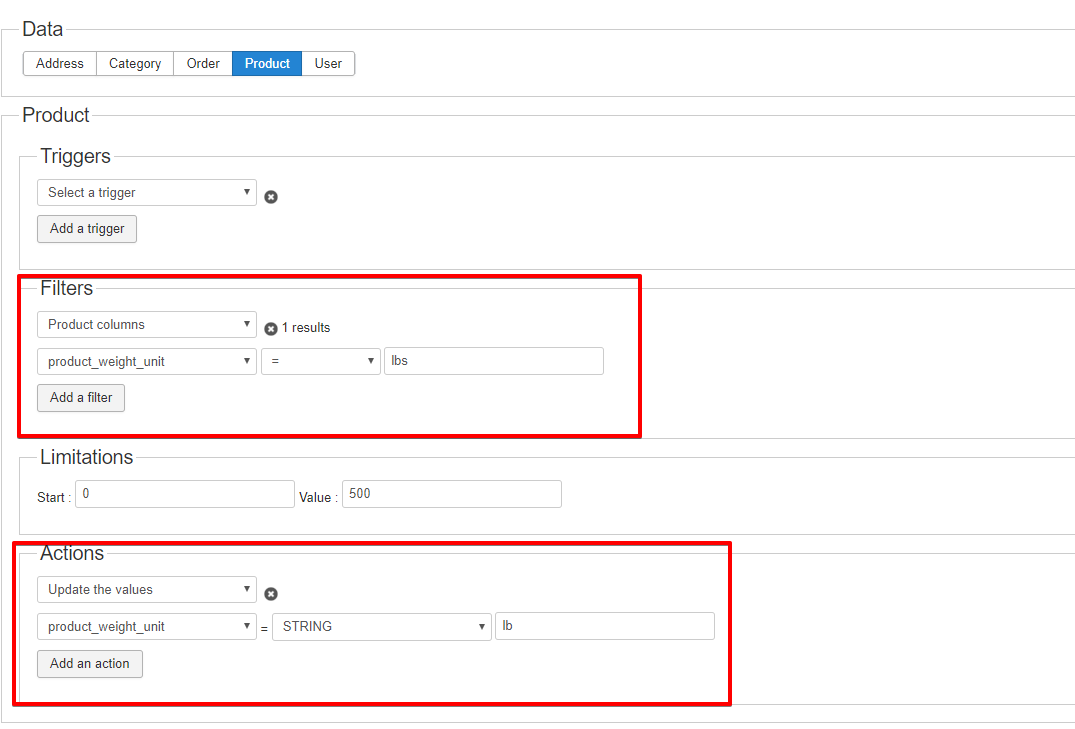

Your issue is coming from the fact that the weight unit of your products is "lbs" instead of "lb", your products probably have that weight unit because you imported your product using a CSV file with a wrong weight unit.
If you test it with the "Nitrile Gloves- 6 Mil, Large, 100/Box" product it's working fine now.
The solution will either be to re-configure all of your products with the correct weight unit, or to directly use Mass actions to do it via "Hikashop->System->Mass actions":
www.hikashop.com/support/documentation/167-massaction-form.html
Last edit: 7 years 11 months ago by Mohamed Thelji.
