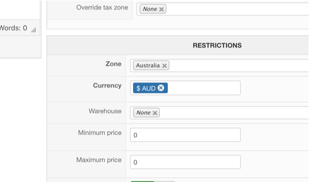

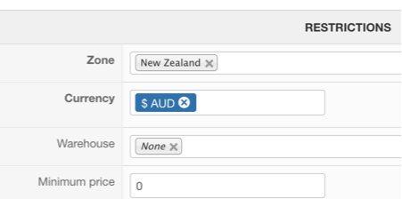

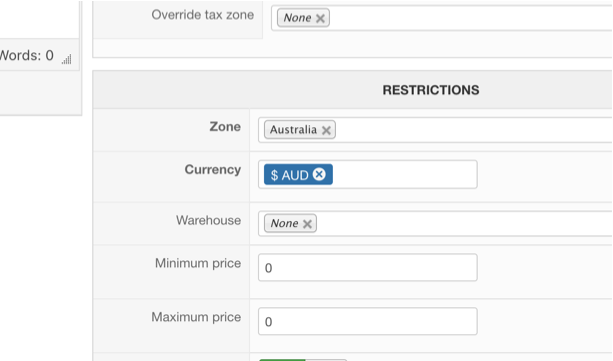

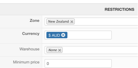

You should select the corresponding country in the "zone" setting of each shipping method.
See attached what setting I have for Australia and the other countries I mentioned.
So the zone changes to each country selected.
I'm using the Manual Shipping method plugin.

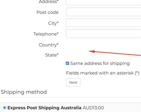

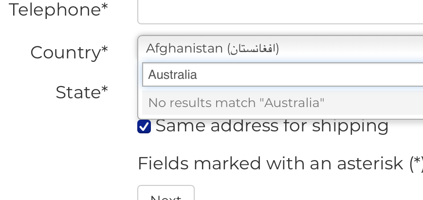

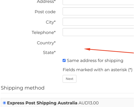

  • Posts: 23
5 years 7 months ago #329273
Attached is the issue I'm facing.
I downloaded a browser that has never been to the site before to ensure a clean access as well
My VPN is via the UK and check myIP shows this
Will change security settings to allow access and report back.
5 years 7 months ago #329292
Your issue is coming from the fact that you have unpublished through "Hikashop->System->Zones" every zones of the type "country" and "state".
Publishing them back should fix the issue.
Kind regards,
Mohamed.

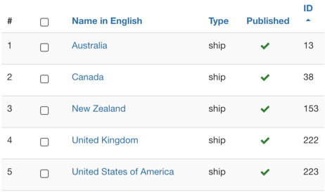

  • Posts: 23
5 years 7 months ago #329337
I have now published every Country and State in the list ... all 4310 of them
Any of the Countries that we ONLY deal with that I have selected and published in the Shipping Methods (previously mentioned) DO NOT appear in the list when I go shopping
Something still not happening as it should.

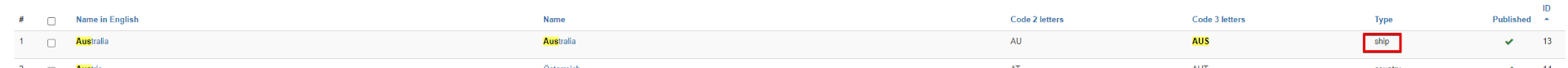

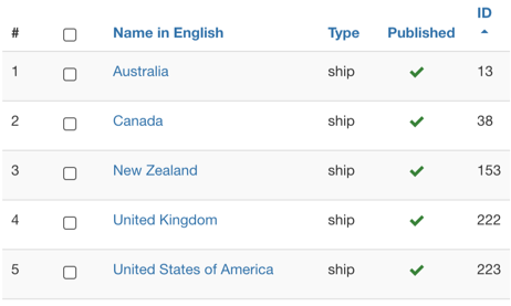

5 years 7 months ago #329359
Your issue is coming from the fact that you changed the type of these zones from country to shipping (cf screenshot).
If you want to create a shipping zone, you'll have to :
- Create a new zone via "Hikashop->System->Zones"
- Set its type to "Shipping"
- Add every zone you need in it (countries or states).
So if you previously changed the type of country/state zones to shipping/payment, you should revert your changes if you want addresses field to properly work.
Kind regards,
Mohamed.
