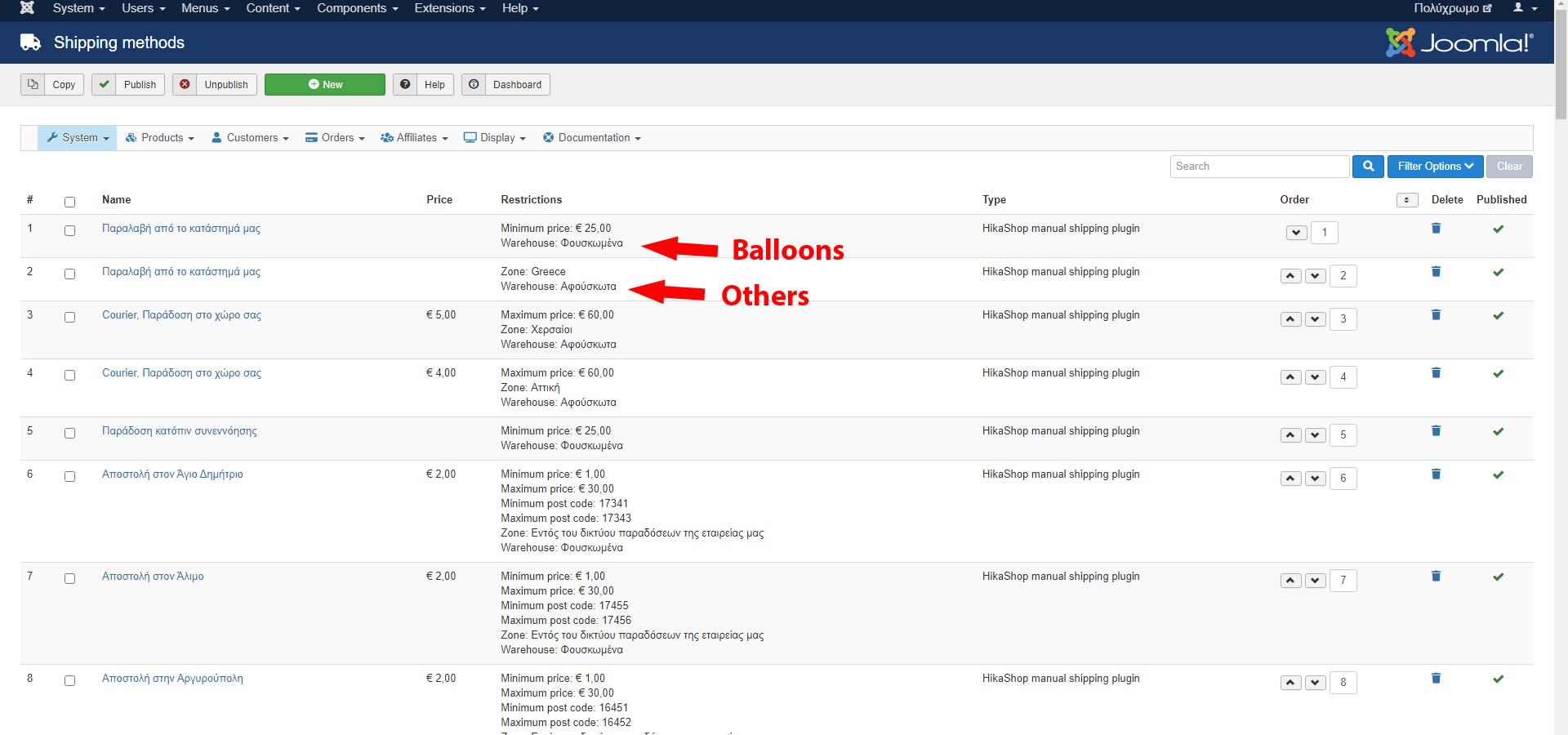

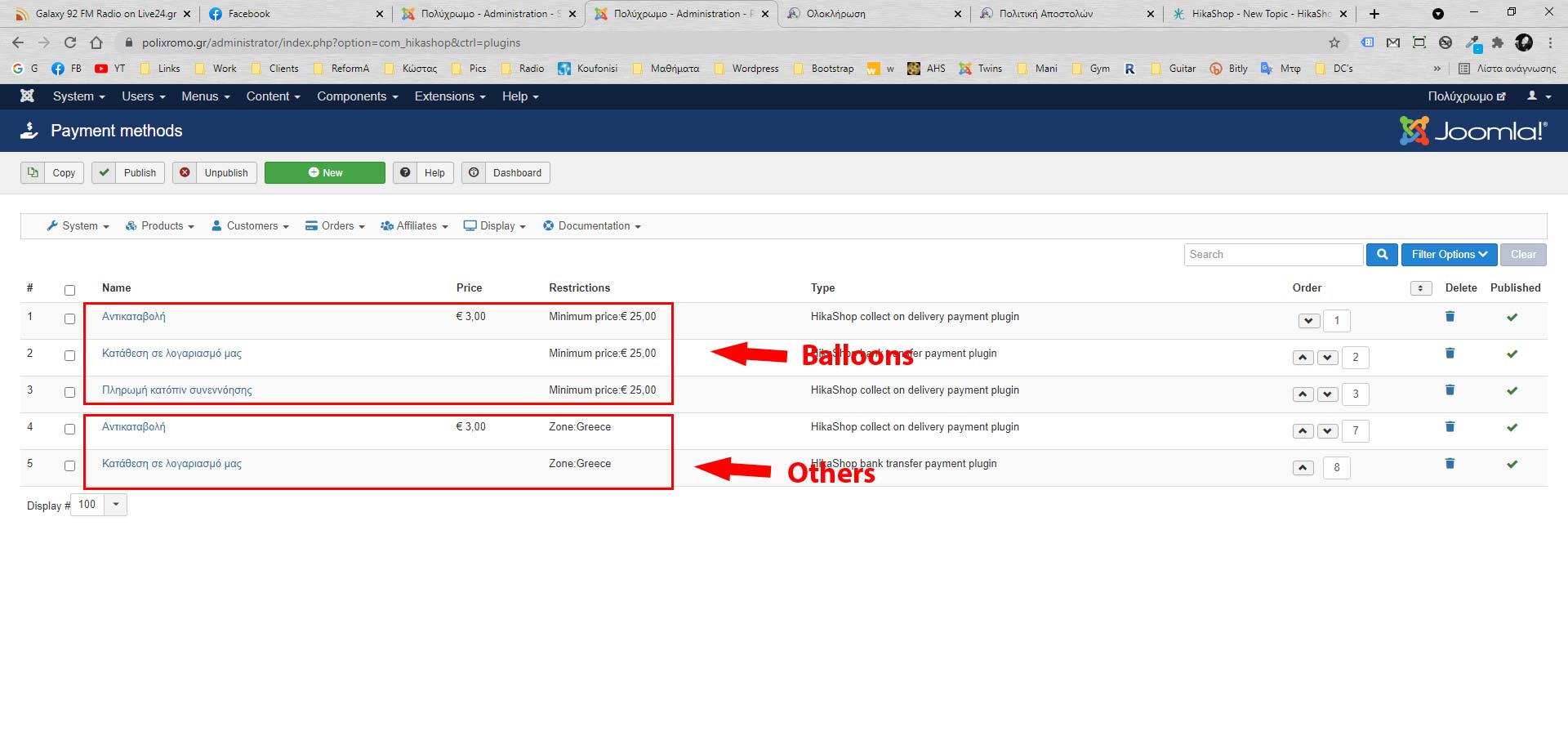

There are 2 warehouses in my shop, "Balloons" and "Others". For the "Ballons" warehouse i need to have a minimum order price 25€ and the delivery is only available via our courier service and we deliver at speicific post code areas.
For the "Others" warehouse there is no minimum order price and we deliver via courier service all over Greece.
When a customer adds "Ballons" products to his cart that their cost is lower than 25€ i need to display a message for that at the checkout.
I tried to create all that but i'm having trouble and i could really use your help!
May i send you backend access?
Thank you

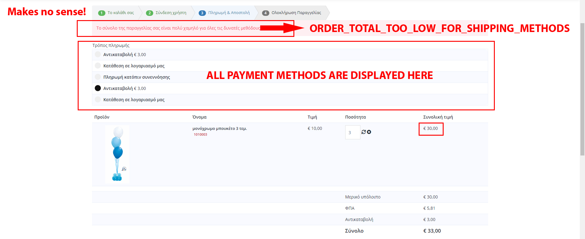

The part that i mostly need help is with the "Balloons" warehouse, i'll explain.

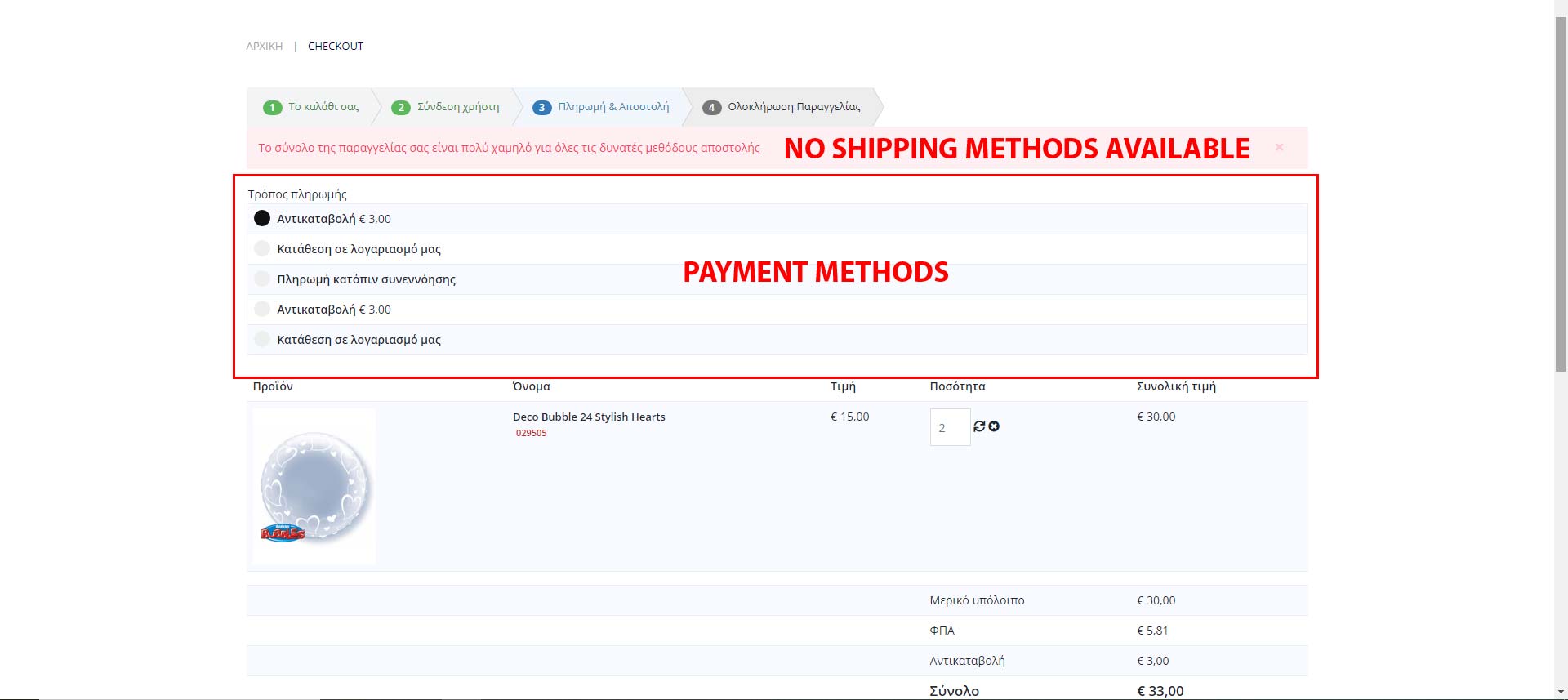

When the total cost is below 25€ for all products of the "Balloons" warehouse then the customer cannot complete the order.
If the order is over 25€, the shipping methods apply to specific areas (depending on the post code).
For example, if the customer lives in AREA A and the order's cost is 50€ then the process should be completed because we deliver in that area. If the customer lives in AREA B that's an area that we do not deliver so the order should not be able to complete. In that case we must display a message to inform the customer that we do not deliver in AREA B and to also hide the payment methods from the checkout.

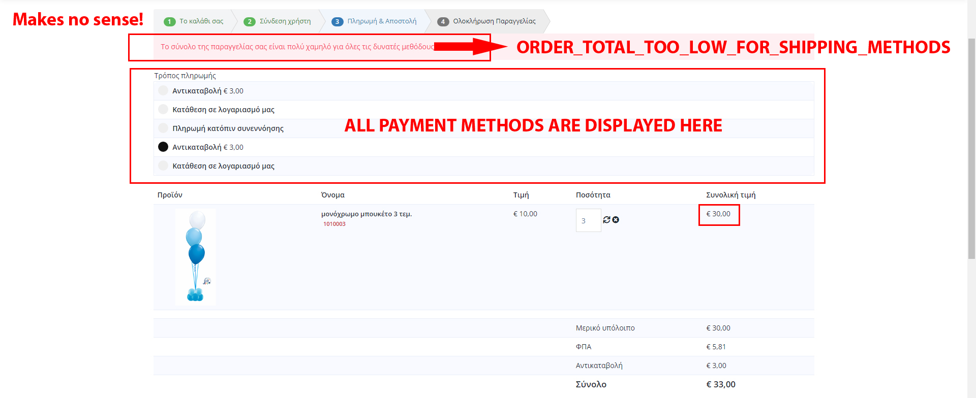

In the screenshot, the product belongs to the "Balloons" warehouse but the shipping address is not within the areas we deliver but in that case as a result i get the message "ORDER_TOTAL_TOO_LOW_FOR_SHIPPING_METHODS" and all the payment methods are displayed. That is not correct.
I'm sending you backend access to see for yourself!
Thank you
What do you mean by "all the payments methods are displayed" ? if that error message was triggered, you should'n be able to complete the checkout workflow.

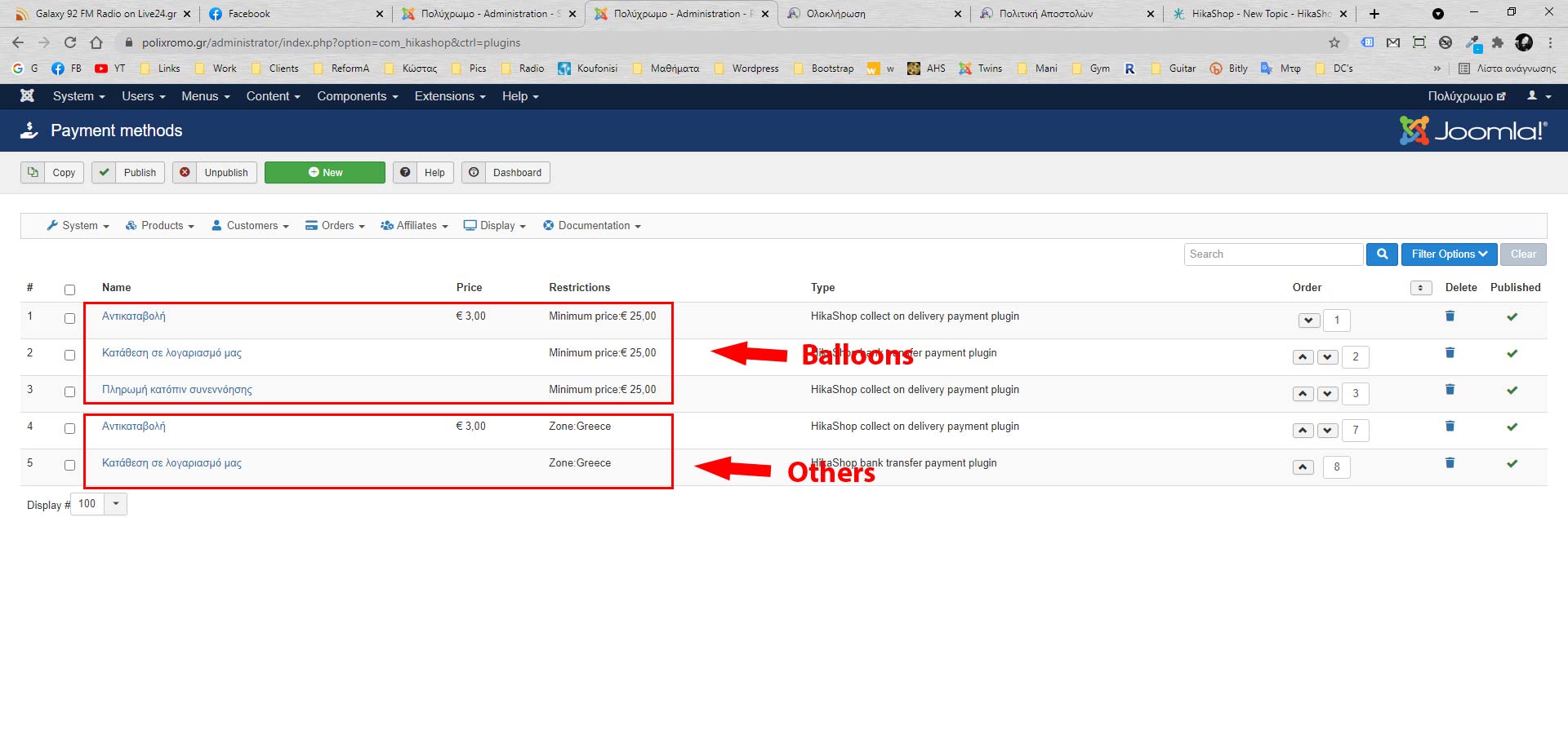

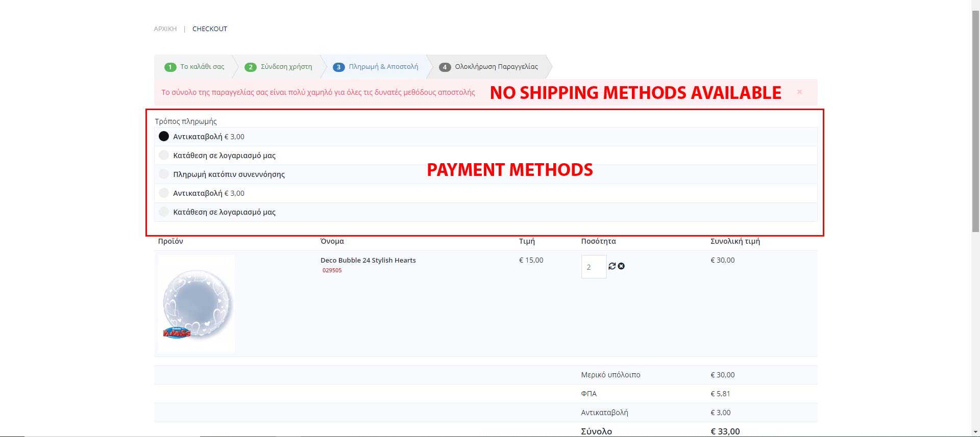

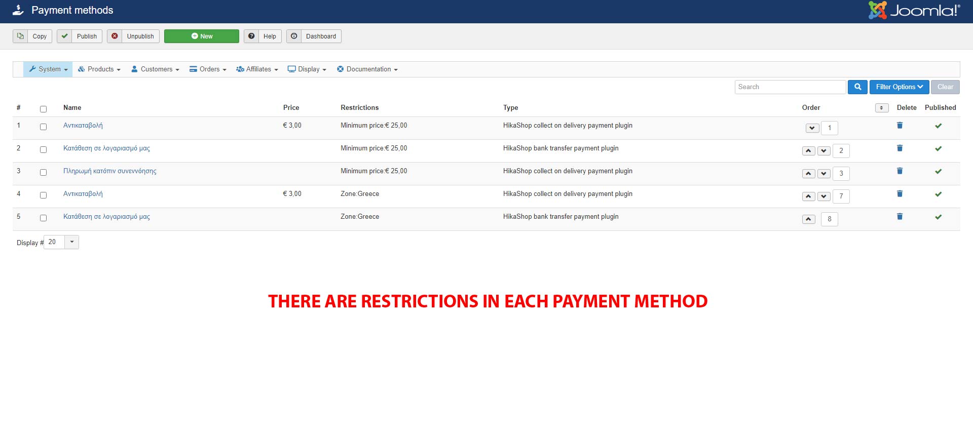

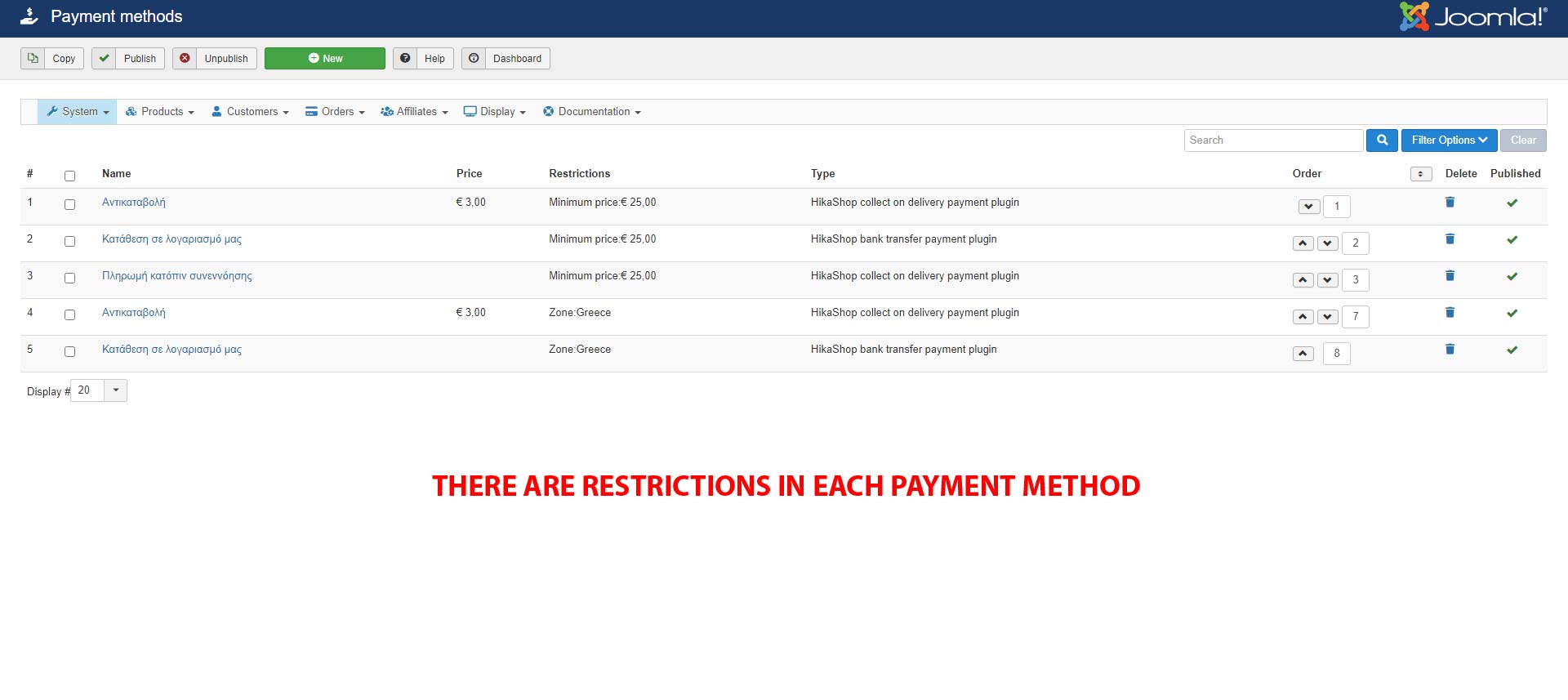

I mean when no shipping methods are available then all the payments methods are displayed inspite their restrictions.
I have made some progress but still need help. If you could test it yourself maybe you'll understand better!

4 years 11 months ago #336098

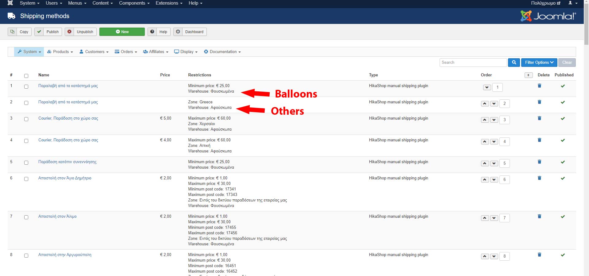

That's weird, I succeed to reproduce your "Payment methods displayed" issue at first, but after re-configuring the "Παραλαβή από το κατάστημά μας" by :
- Setting a currency for "minimum/maximum" prices restriction
- Re-setting the warehouse
It seems to have fixed the issue, so can you test it again ? Thank you.
Kind regards,
Mohamed.
  • Posts: 1184
  • Thank you received: 13
4 years 11 months ago #336124
Hi!
If you select any other state besides Αττική in your shipping address and continue to the next step, you will see that all the payment methods still display. That applies only for the Warehouse "Φουσκωμένα" (Balloons).
Thank you

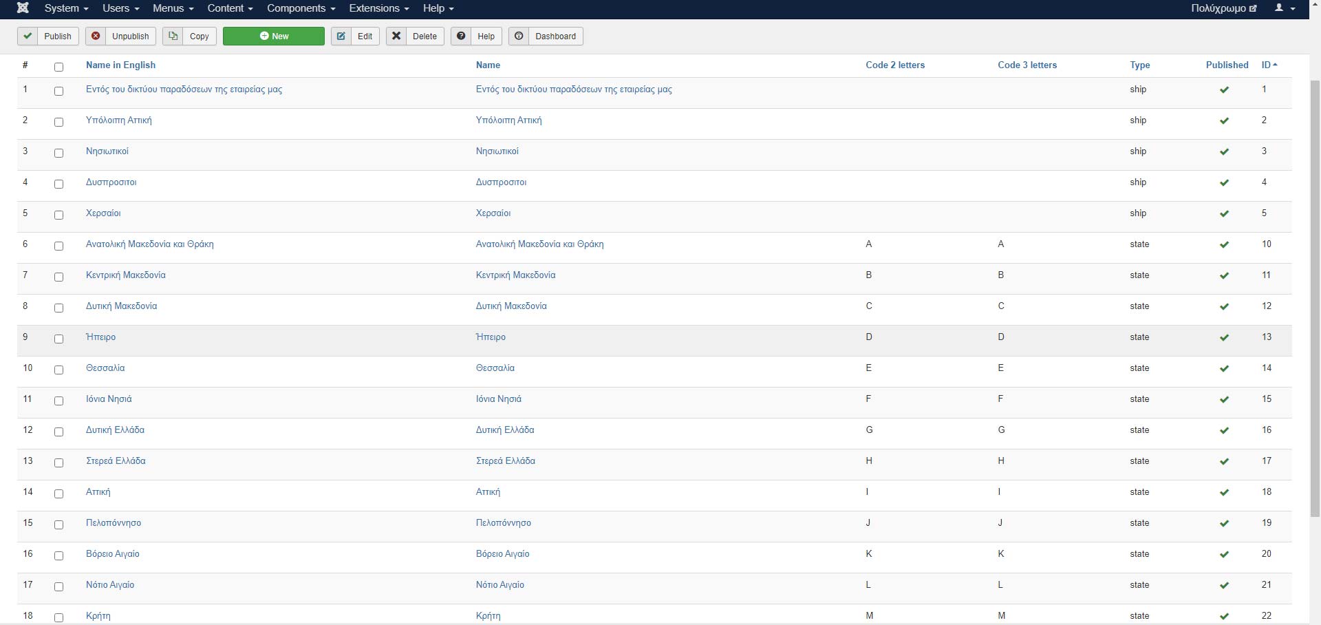

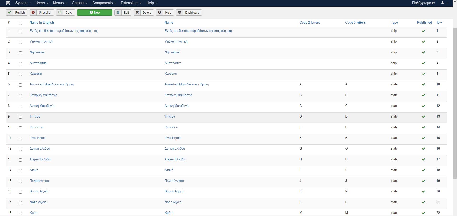

In that case, can you tell us if you have edited your HikaShop zones as we didn't succeed to reproduce it on our and and that the issue can be coming from it ? Thank you.
Kind regards,
Mohamed.
  • Posts: 1184
4 years 11 months ago #336151
Yes i edited and created zones, we deliver only in Greece.
Do you mean that causes the problem?
Thank you
4 years 11 months ago #336161
We actually succeed to reproduce that issue on our end, so we'll test and fix it as soon as possible and get back to you.
Thanks for your feedback!
