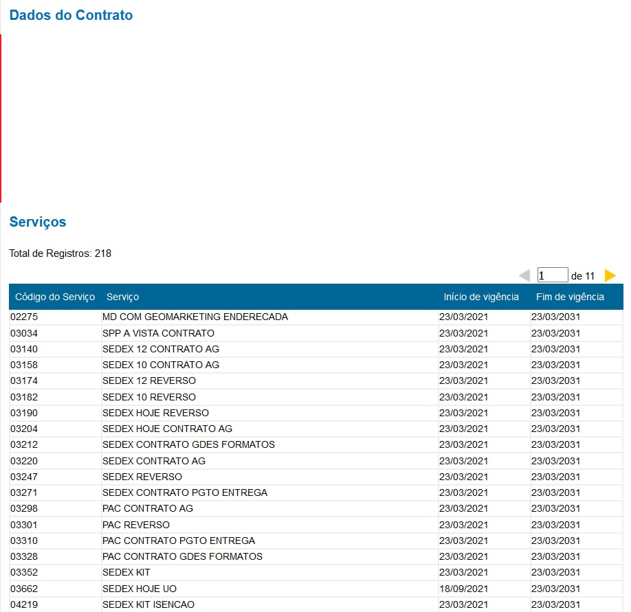

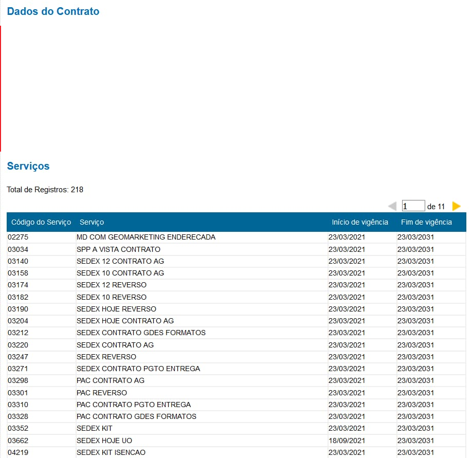

Attached are the NEW Brazilian Postal Codes.
Go to the folder where the PLUGIN(/plugins/hikashopshipping/correios) is installed, edit the files "correios.php" and "correios_configuration.php" and REMOVE the CODES that are no longer valid.
KEEP only the PAC(41106) and SEDEX(40010) code, as they are still valid.
And put the new CONTRACT codes.
