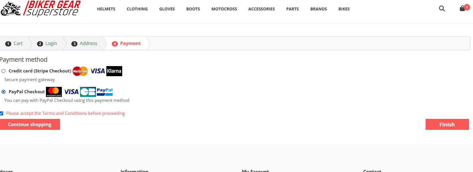

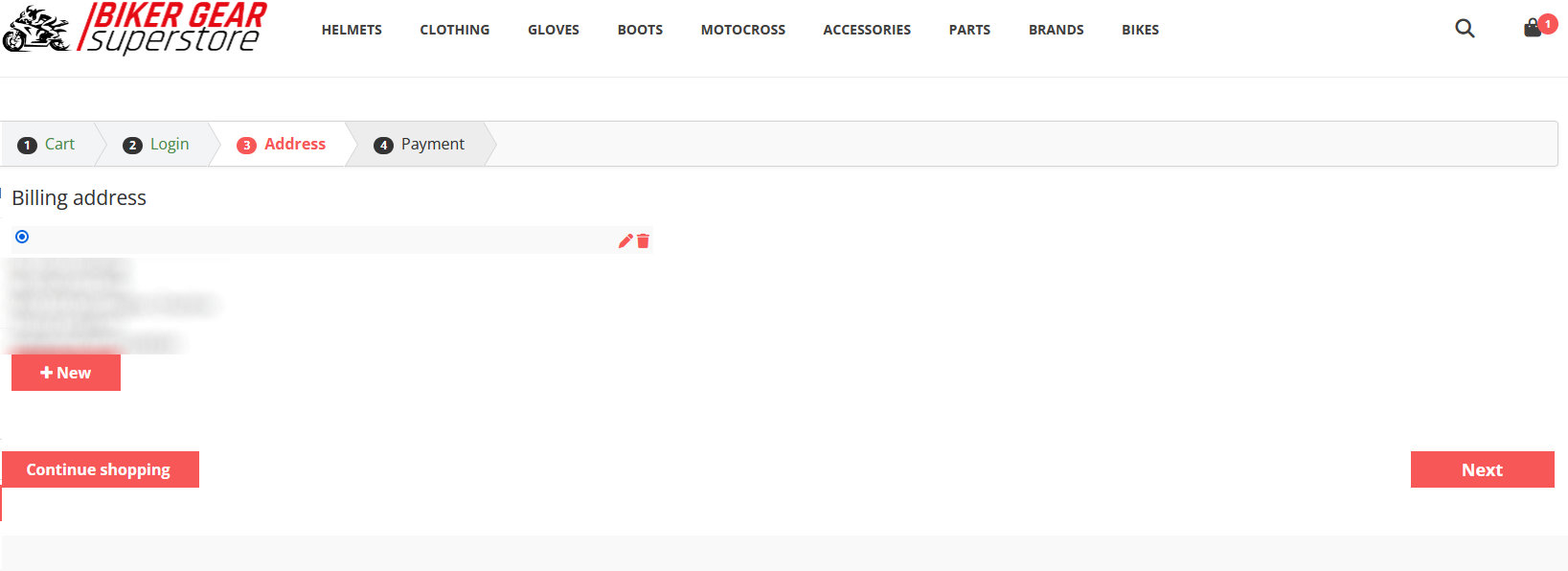

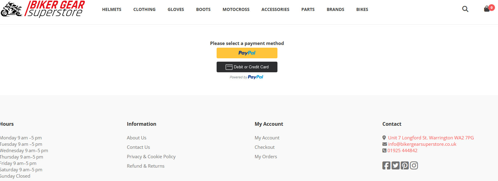

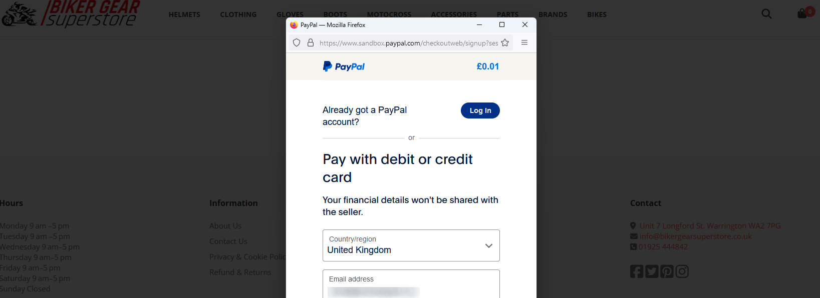

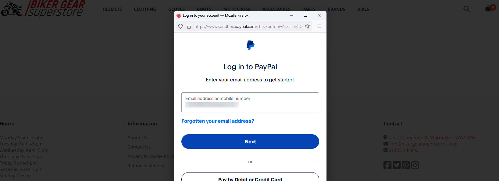

I was instructed to upgrade to the latest PayPal Checkout plugin.

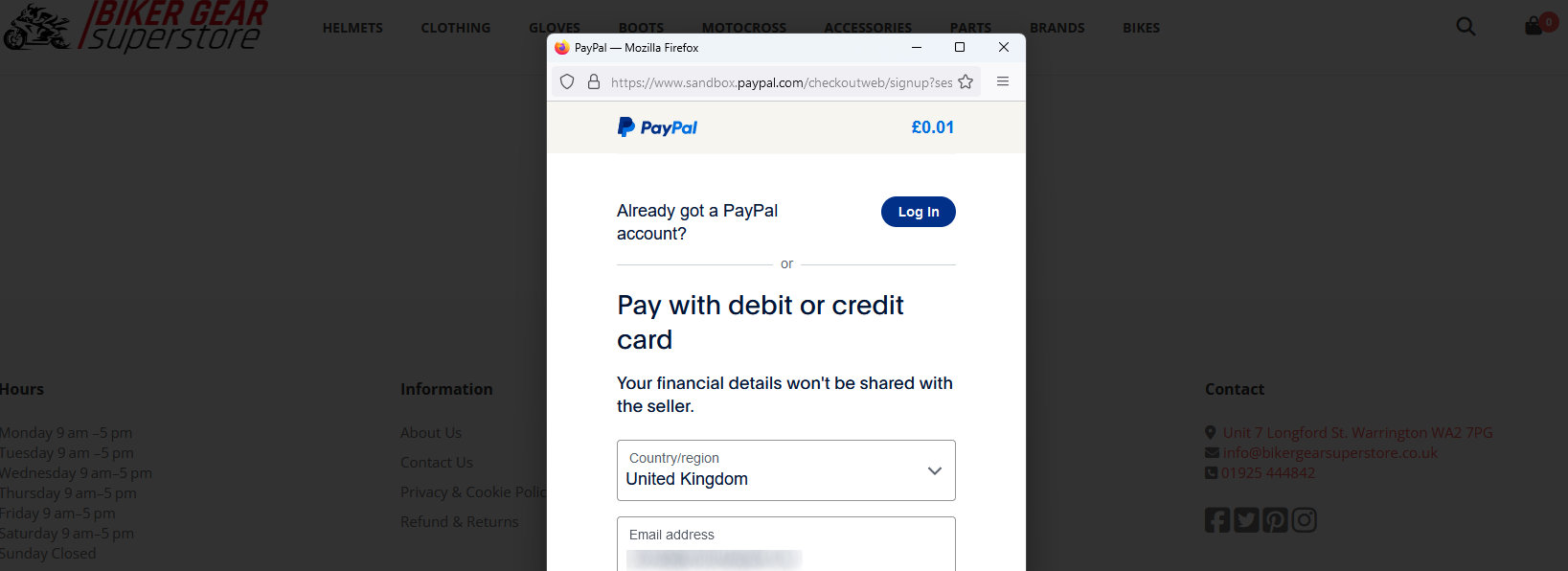

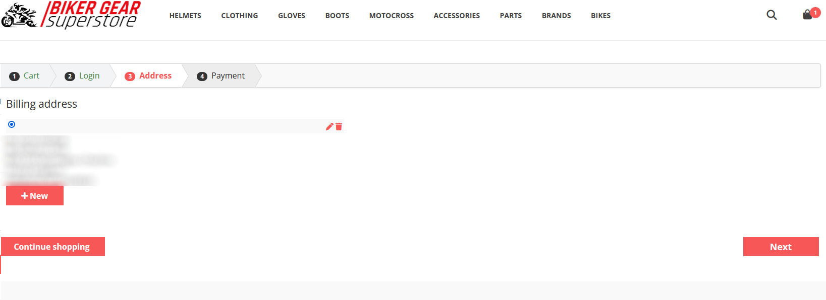

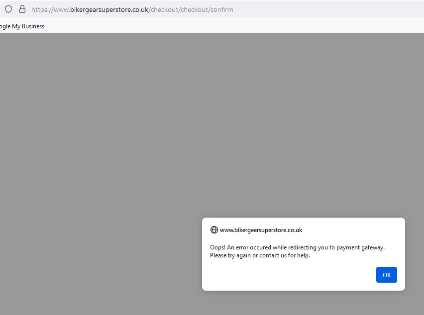

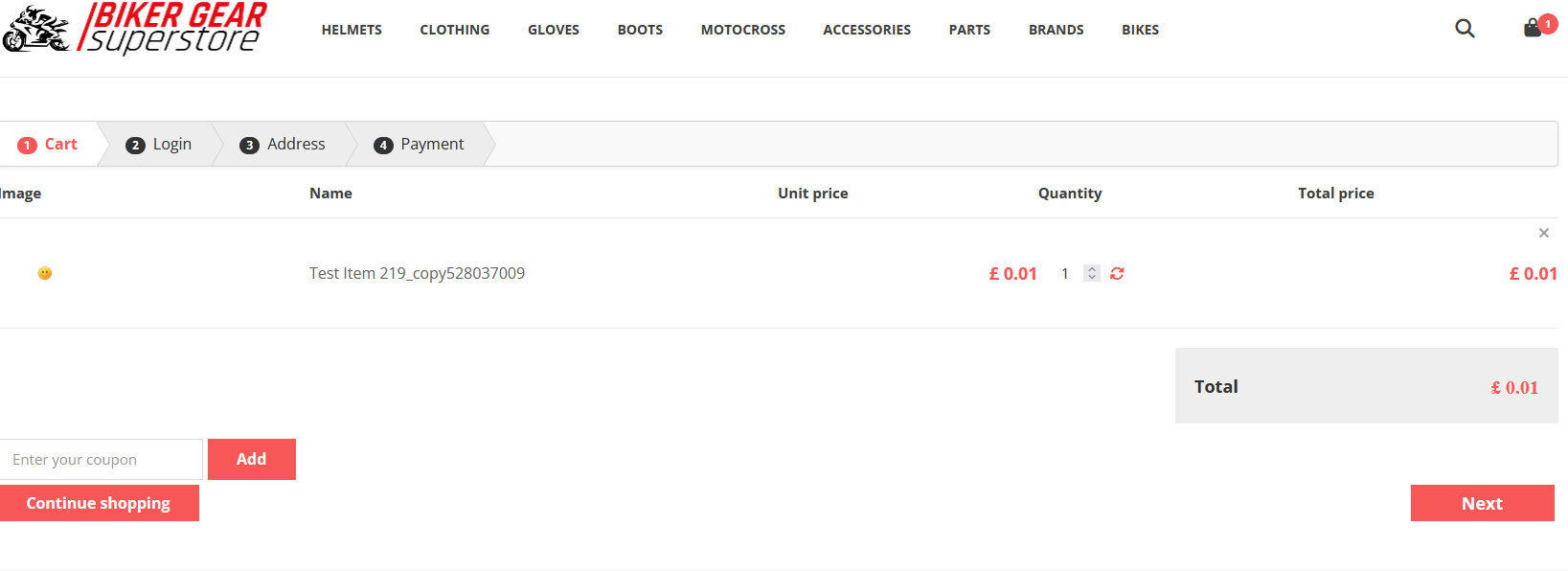

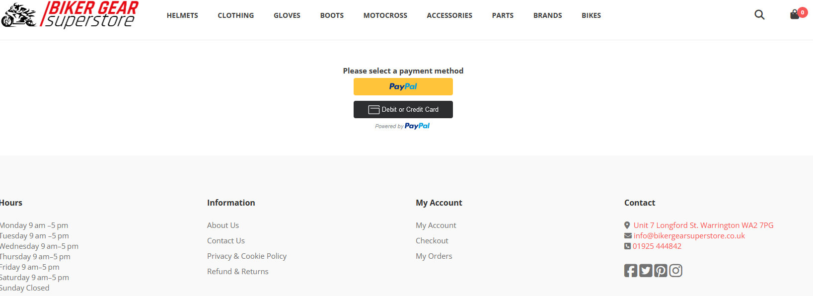

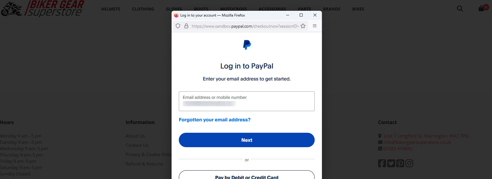

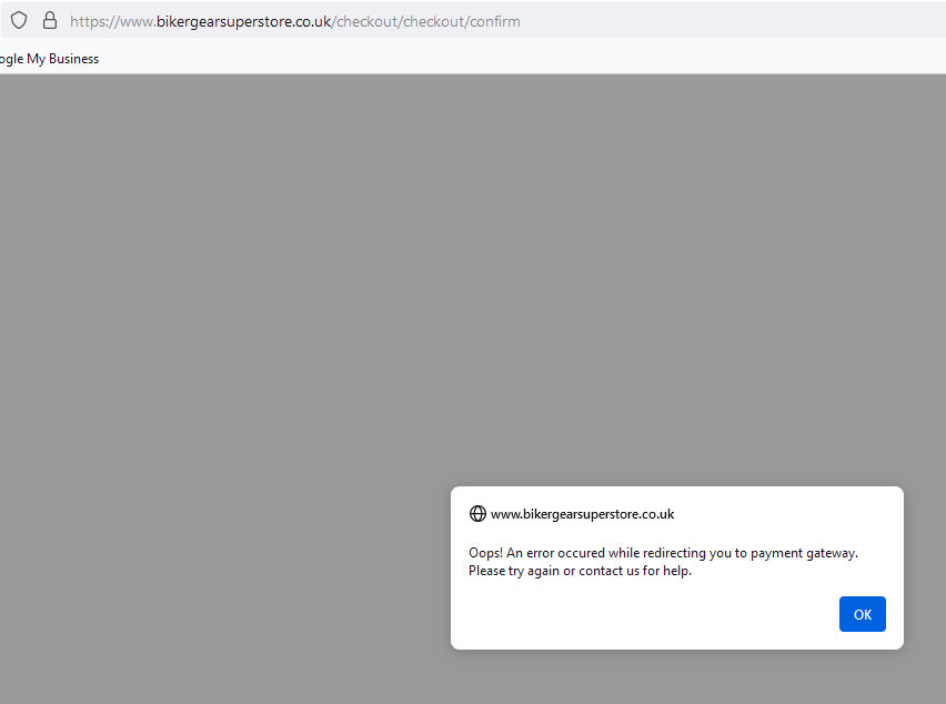

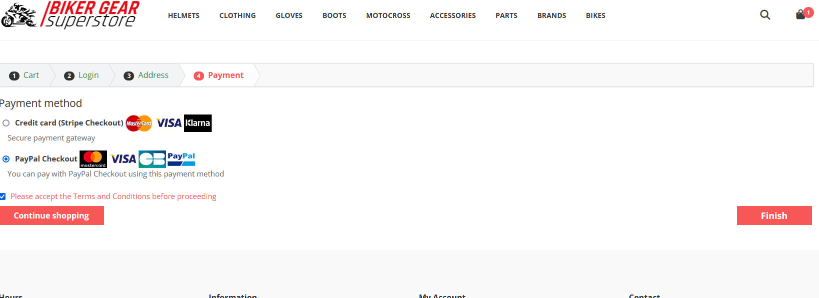

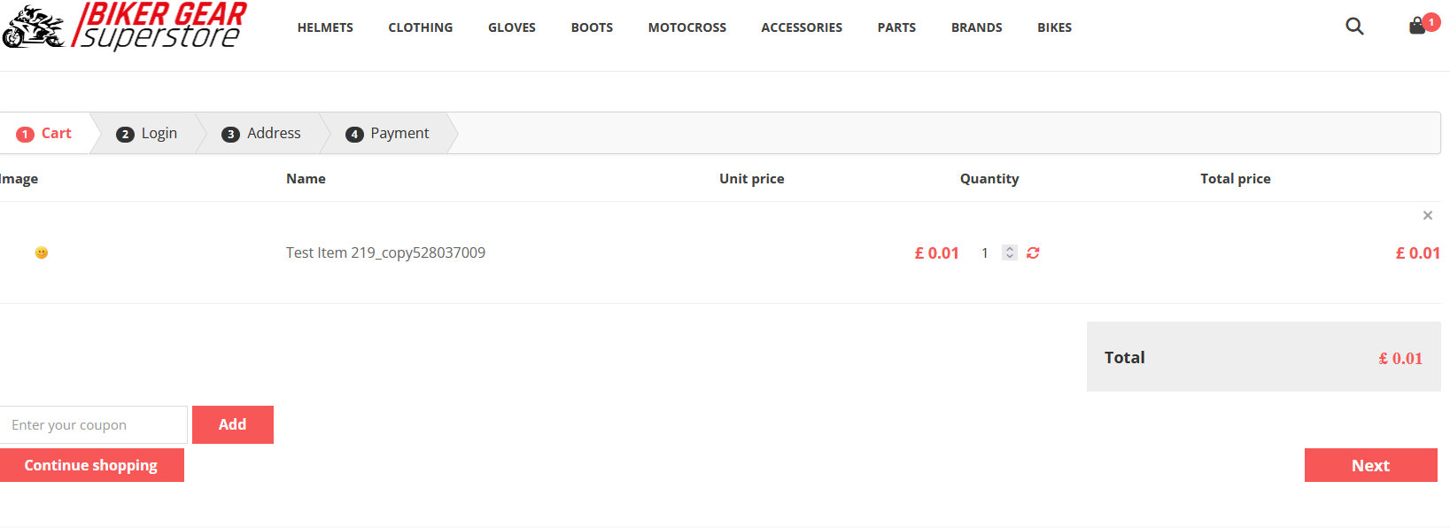

I know have payment issues. Please see screenshots of payment process. Screens 001,002 and 003 seem ok. Screen 004 asks to select payment method, why? .... I have already selected Paypal. If I then select Paypal, I end up in a loop between screens 005 and 006.
Colin.

2 years 3 months ago #361548
The first payment selection on screenshot 003 is to select between the payment methods that you've configured in the System>Payment methods of HikaShop.
The second payment selection on screenshot 004 is to choose between the payment modes offered by PayPal. Here, you can choose to pay with a PayPal account balance with the first button, or with a credit card with the second button.
And you can also add other payment modes with the "funding" setting of the payment method, like iDeal, Venmo, Pay Later, etc which will appear as extra buttons based on whether the payment mode is available to the current customer or not.
The fact that you're looping between screenshot 005 and 006 is separate. The URLs I can see in your screenshots indicates that you've activated the "sandbox" setting of your PayPal Checkout payment method. In such case, you can't use live credentials to login for the payment. You need to provide the sandbox customer account credentials provided by PayPal in your sandbox account:
developer.paypal.com/tools/sandbox/accounts/
What you're describing seems to indicate that you're not using a sandbox customer account for your test.

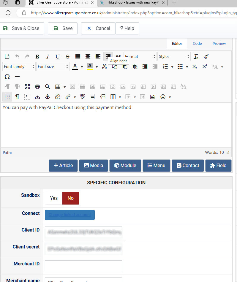

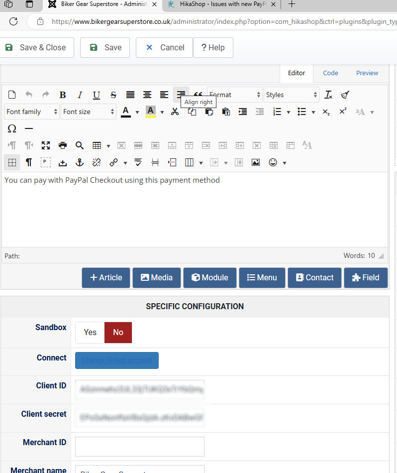

Sandbox isn't activated?

If you turned off the sandbox setting, please make sure that you're using the client id and client secret of your live account.
Also, please fill in the merchant ID.
You can find more about them here:
www.hikashop.com/support/documentation/4...alcheckout-form.html
With the live account, you need to use a real credit card or a real PayPal account for your test. Also, you can't use your merchant PayPal account. You need to use another PayPal account, otherwise PayPal will refuse the payment. Also, if your credit card is linked to your PayPal merchant account, it might not accept it.

Note that you can still use the legacy PayPal plugin while figuring out what's wrong with the new PayPal Checkout one on your website so that your users are not impacted for their payments.
I don't think that the issue is the same with both payment methods. I think these are separate problems.
Try again each one with the console log of your browser open while doing it. It should output error messages which should help us understand what's going on.

So I don't see any errors there which could be related to PayPal or Stripe not working. Maybe you would get more information for PayPal if you activate its "debug" setting. Could you try that ?
I can see however that the PayPal checkout plugin still uses the PayPal sandbox. As you're on a live website, I find this strange.
You said that the "client id" and "client secret" are correct. Does that mean that you were already using them on your website before ?
If so, I suppose that they are for your PayPal live account. In that case, they can't work with the PayPal sandbox.
If you activate the "sandbox" setting of the plugin, then you have to use the client id and the client secret of a sandbox account.
So please check the status of the "sandbox" setting of your PayPal checkout payment method.
