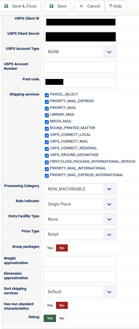

I have the updated plugin installed. I could not find information on the "Rate Indicator" or "Entry Facility Type" in the USPS Publication 205 .
Running into this error:
USPS 2: Failed to retrieve prices.
[400] Could not find working sku from SSF ingredients
Could not find working sku from SSF ingredientsUSPS 2: Failed to retrieve prices.
EDIT: In playing around with "Rate Indicator" setting, I can get rates. Just not sure what is an appropriate selection for that. It was on "3-Digit" when I was getting the error. "Single Piece" looks to give me the rates more in line with what I was expecting.

11 months 2 weeks ago #368415
The log you provided indicates that you displayed a page on the frontend with either the cart or the checkout after installing the new version of the plugin but before saving the settings of the shipping method once to validate the new settings. So, basically, you can ignore this.
Regarding the rate indicator, I do not know what should be an appropriate value for what you're shipping. In your link of the USPS publication 205, check page 114 and following pages. You can see tables of accepted rate indicators for each mail class and processing category.
On my end, I've used "Dimensional Rectangular" as it seems like the most logical for most people and services and it seemed to work fine. However, I'm not sure why "Dimensional Rectangular" or "Single Piece" would be appropriate and I couldn't find precise information about each rate indicator on the USPS website.
Please understand that I'm not a specialist of how USPS calculate its shipping fees. I'm not even in the USA so I've never even shipped anything with USPS. That's something you should check with someone at USPS.
The "Entry Facility Type" depends on how you ship your goods with USPS. Do they come to your place to pickup the packages ? Do you drive to one of their facility to ship your packages ? Is it a hub, a network distribution center or a sectional center facility ? Do you have another type of arrangement ?

11 months 2 weeks ago #368441
nicolas wrote: Regarding the rate indicator, I do not know what should be an appropriate value for what you're shipping. In your link of the USPS publication 205, check page 114 and following pages. You can see tables of accepted rate indicators for each mail class and processing category.
Based on my testing, "Single Piece" provides rates that are closest to what the true shipping rate cost ends up being for what we ship out. "Dimensional Rectangular" ends up being significantly higher rates. We don't want inflated shipping rates shown to our customers, as that might cause them to pass on making a purchase. The rates should be close to what we would charge them (actual shipping cost plus a modest handling fee).
nicolas wrote: The "Entry Facility Type" depends on how you ship your goods with USPS. Do they come to your place to pickup the packages ? Do you drive to one of their facility to ship your packages ? Is it a hub, a network distribution center or a sectional center facility ? Do you have another type of arrangement ?
We either hand the packages to our postman or drop it off at the local Post Office. The only selection that actually provides rates is "None". All others produce this error:

I'm having the same issues as you, GPRaceman, and need a similar setup.
However, I'm still not getting any results, regardless of the configuration I've tried.
gpraceman - I'm curious, have you entered a USPS Account Number? That's the one thing I'm still waiting to get.

11 months 2 weeks ago #368467
I, too, am trying to get this to work, and I have yet to receive a rate returned.
I've updated to the latest version but the only thing in my log so far is
Array
    [apiVersion] => /prices/v3
    [error] => Array
            [code] => 400
            [message] => One or more required field(s) are missing from the request, /prices/v3/base-rates-list/search.
            [errors] => Array
                    [0] => Array
                            [title] => One or more required field(s) are missing from the request, /prices/v3/base-rates-list/search.
                            [detail] =>
Here are my current settings, but I've tried a lot of combinations and nothing has worked yet.

11 months 2 weeks ago #368473
On my end, I used these settings with the production credentials of gpraceman and his zip code in order to reproduce the issue and fix it before making the release :
i.imgur.com/ooHLJLQ.png
I then had USPS services returned for both domestic shipping and international shipping, without a USPS account number and the type to "NONE".
The "non machinable" will remove quite a bit of possibilities, I think.
