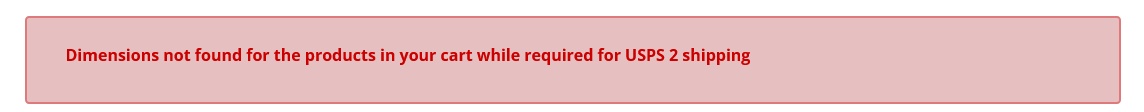

Odd, I wonder why I cannot get any rates to return when just the weight alone is used with the same settings you are.
And once I disable all the other shipping methods, I get the following error on an item without dimensions:
It's really a pain to test this when I cannot do it when any other USPS payment methods are enabled.
It makes the process particularly challenging on a live site.

You need to provide dimensions in your products. The previous API of USPS didn't require dimensions, but the new one requires it. So we couldn't add a similar setting in the new plugin due to USPS, not a limitation of what we did in the plugin.
Last edit: 11 months 2 weeks ago by nicolas.

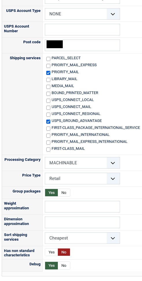

11 months 1 week ago #368546
Sorry for the delay. I looked into it during the weekend and today too.
So, first, note that with this new USPS plugin you can still have several instances of it, if you need to have different configurations for different products based on weight and service. So, the fact that you need to add dimensions to the products should not be a problem.
And yes, I think that some of the confusion indeed comes from the API used in the plugin. It uses the "base-rates" endpoint and reading into it, it doesn't take into account letters and flats (large envelopes). And so, if we were to use this base-rates endpoint, we would also need to implement the letter-rates endpoint that you mentioned for letters.
However, upon further reading, the "total-rates" endpoint seems to be the solution here. From what I could read, it can provide rates for both packages / parcels and letters / flats.
So, I've worked on a new version of the plugin over the past few days. I've tried the "letter-rates" endpoint with dimensions and weight corresponding to normal letters / flats. Then, I switched to the "total-rates" endpoint and I got the same rates for the same letters / flats.
Then, I did the same for the "base-rates" endpoint and the "total-rates" endpoint for packages / parcels, and again I got the same rates.
So, the "total-rates" endpoint seems to be the solution here.
Another advantage of this endpoint is that you don't have to provide the rate indicator, processing category etc. So I was able to remove them from the plugin.
I've just released a new version of the USPS plugin with the necessary changes.

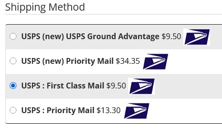

11 months 1 week ago #368547
Closer, but I don't think it is quite right.
I think the processing category might be important in determining which services are returned for letters, because I'm still not seeing first-class mail (among other letter service options, such as flat-rate envelopes).
The last entry is the old plugin, which is the correct amount for the given weight and dimensions.
I'm pretty sure we need the category option, otherwise I appear it is being treated like a package/parcel.
I'm pretty sure about rateIndicator, too. I conducted a test with a non-rectangular package, a tube, which we commonly use, and it was not displaying the correct pricing, even when weight, dimensions, and "Has non-standard characteristics" were enabled. It was way too low, like it was doing a normal rectangular package.
Products that would go in standard rectangular packages seem fine, but not anything outside of that.

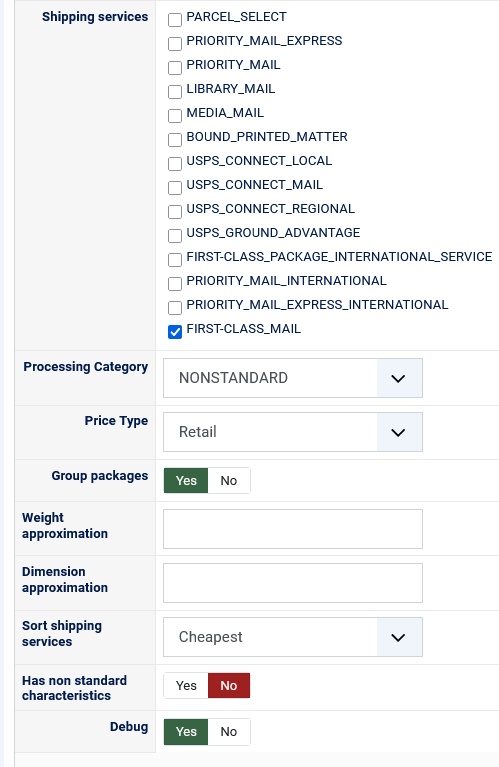

11 months 1 week ago #368556
Thanks for your feedback.
I've made changes in the plugin for these issues and published a new version of the plugin.
Please update the plugin again.
Also, you'll now have a "First-Class Mail" service which you need to select if you want the shipping method to support letters / flats.
You'll also have a "processing category" setting for machinable or nonstandard packages.

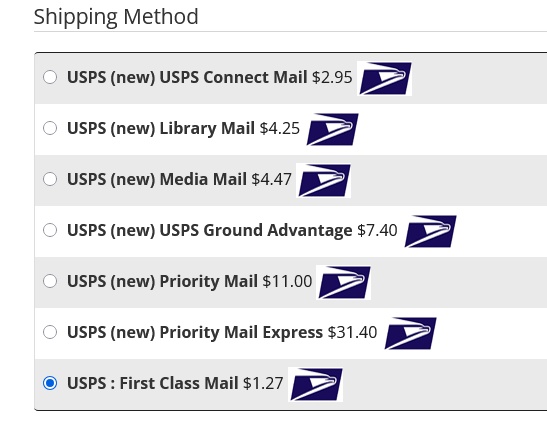

  • Posts: 291
  • Thank you received: 26
  • Hikamarket Multivendor Hikashop Business Hikashop Essential
11 months 1 week ago #368562
I'm fairly certain we need the "rateIndicator" option, not just the processingCategory.
I'm getting inconsistent results, even for standard package prices with dimensions or ones that match our expectations (e.g., those that are even close to either the n value or the correct services listed). For example:
I have no idea why there is a difference between the Priority Mail options in the old and new plugins, while the Ground Advantage remains the same.
There is only one product in the cart, so it should be using the same weight/dimensions. The old one is the correct amount.

11 months 1 week ago #368575
nicolas wrote: - For the name of the services in the email and order details in the backend, I'm not able to reproduce the issue anymore. I don't see why @gpraceman would still have the issue. Could you please double check ? Do you also have the issue @jazzmang ?
Yes, I see the same variable names only in both orders, emails, and the plugin settings - no actual names..
nicolas wrote: Regarding "if you have a "FIRST-CLASS_MAIL" check, you can only receive FIRST-CLASS_MAIL rates", I'm also not able to reproduce the problem. I've tested the current version of the plugin with both package services and the new FIRST-CLASS_MAIL services checked, and when the product in the cart had dimensions and weight of a letter or flat I would get the FIRST-CLASS_MAIL service rate, and when they would exceed the limits of a flat, the plugin then switched automatically to package rates. Could you please double-check?
Currently, I am unable to obtain a FIRST-CLASS_MAIL result under the new plugin (I can with the old one for the same product). It's a .5oz decal, so dimensions are absurdly small and will fit in a standard 4-1/8" x 9-1/2 letter envelope. It should be $1.27 pretty much regardless of where you ship it from/to in the US.
Here is what I'm using for this very targeted set of products (has to be under 1 oz, limit set in the plugin):
nicolas wrote: - Regarding the Priority Mail rate being high, I'm surprised you get these results. I actually have the rate for Priority Mail just a few dollars above the rate for Ground Advantage on my tests. Could it be you have "NONSTANDARD" selected, or the "Has non standard characteristics" checkbox checked on your end which would lead to the high Priority Mail rate on your end ?
Current settings to get the last results shown above. Things are set as they should be for the product type in the cart.
In fact, if I select NONSTANDARD, I get no results at all.
I've tried a few other products with the same settings and get widely varying results between what I get from the old plugin and the new one with the same product in the cart. Sometimes, the prices match; sometimes they are wildly different, as shown above.
The old plugin displays the correct price, exactly as if you went to USPS.com's rate finder and entered the same information.
  • Posts: 86079
  • Thank you received: 14186
11 months 1 week ago #368576
1. Thanks for the information on the translated text. I found the issue. I had made several packages for the previous version during my tests and I had uploaded one with a typo for the translated text, while I was using one without the typo.
2. Regarding FIRST-CLASS_MAIL I think the issue is that the dimensions of your decal product are too small. If I read on the USPS Domestic Prices v3 API documentation page, they say:
To be eligible for mailing at the price for letters, a piece must be:
At least 3-1/2 inches high x 5 inches long x 0.007 inch thick.
No more than 6-1/8 inches high x 11-1/2 inches long x 1/4 inch thick.
And while I made a check to switch to flats if the dimensions are higher, I didn't make a check for the minimum dimensions. So if your decals have dimensions lower than 3-1/2 in x 5 in then the API might not return anything.
So, I've made modifications to the plugin to use the minimum size allowed if the size of the product is below the minimums.
3. Regarding your last issue with the NONSTANDARD rates not being returned, I can't reproduce the issue. Could you provide the debug data from the "payment log file" for that situation ?
For now, I've just released a small new version of the plugin with the different small fixes.
