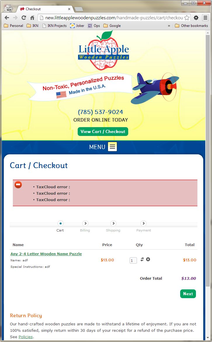

I just added a Characteristic to a products (simple "Colors" with 2 choices) and now I get a generic "TaxCloud: error" any after an address/login is entered during checkout. It just starts appearing any where on the site that com_hikashop is displayed.
I've tried even the default ProtoStar template and it gives me the same error. I find nothing in the web server logs.

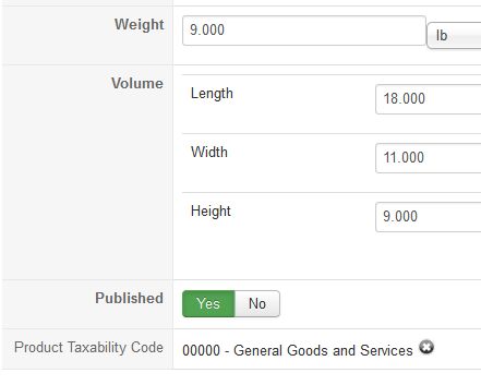

I checked to make sure that the variant items and they do have the Product Taxability Code set.
I tried add just an Option to the original product (without any Characteristics) and there was no issue. So this appears to be specific to something with Characteristics. I tried adding price to the variant (just to see) and no help.
All other products work fine and if I remove the Colors Characteristic, the product is fine.
Not sure exactly what it could be.
I upgraded to 2.3.1 on my internal test server and it has the same issue if I add a Characteristic.
Last edit: 12 years 2 months ago by jazzmang. Reason: Add additional info

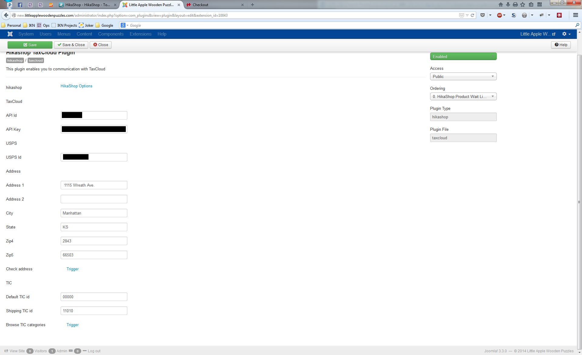

Firstly can you show me some screenshots of how did you configured the "Hikashop TaxCloud Plugin" ?
  • Posts: 291
  • Thank you received: 26
  • Hikamarket Multivendor Hikashop Business Hikashop Essential
12 years 2 months ago #158086
See attached.
