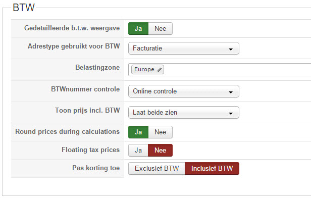

For sure I'm doing something wrong.
I want no VAT if a customer add a VAT number
CONFIGURATION:
VAT TAX zone Europe
VATnumber controle Online controle

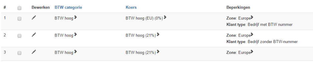

TAXES:
1 BTW hoog BTW hoog (EU) (0%) Zone: Europe Klant type: Company with VAT nummer
2 BTW hoog BTW hoog (21%) Zone: Europe Klant type: Company without VAT-nummer
3 BTW hoog BTW hoog (21%) Zone: Europe

I see several potential problems:
1. Make sure that the "default client type" setting of the HikaShop configuration is set to "individuals"
2. You can delete your first tax rule as it is not necessary.
3. in your third tax rule, you want to restrict the type of client to "individuals" as well.
