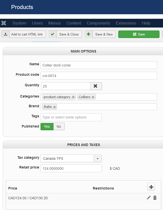

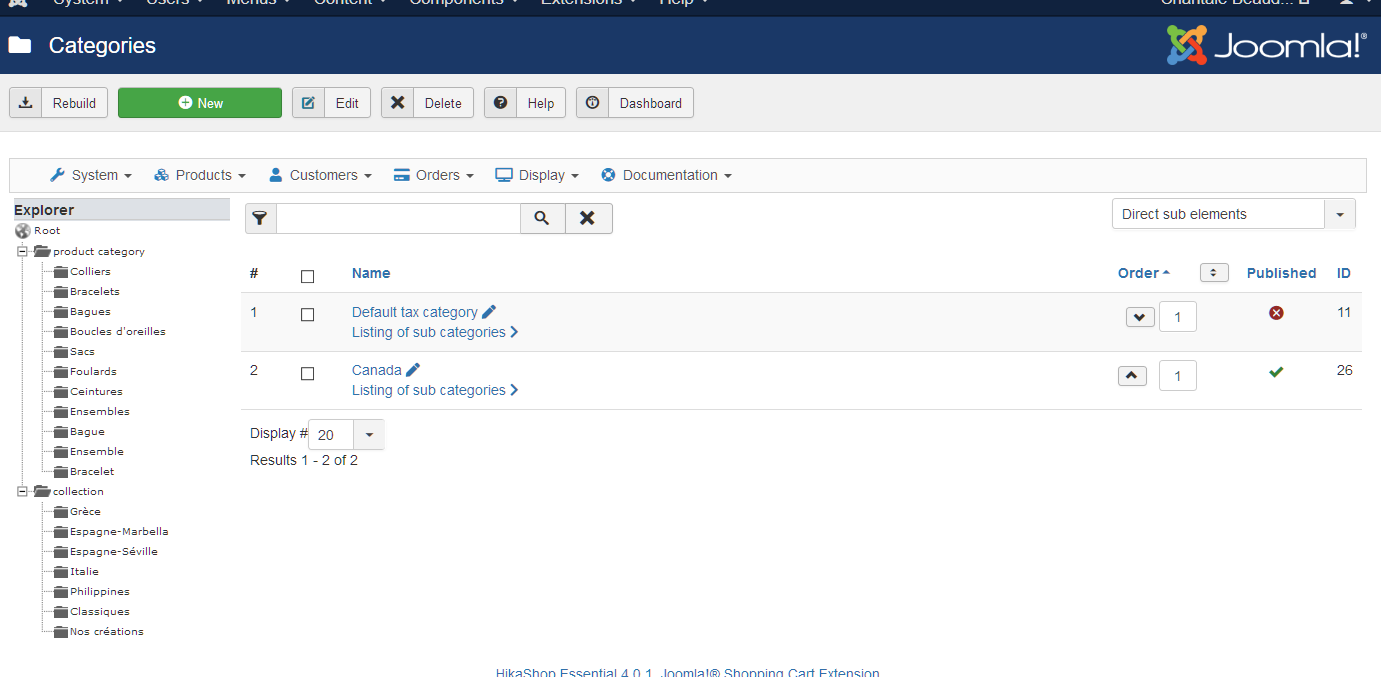

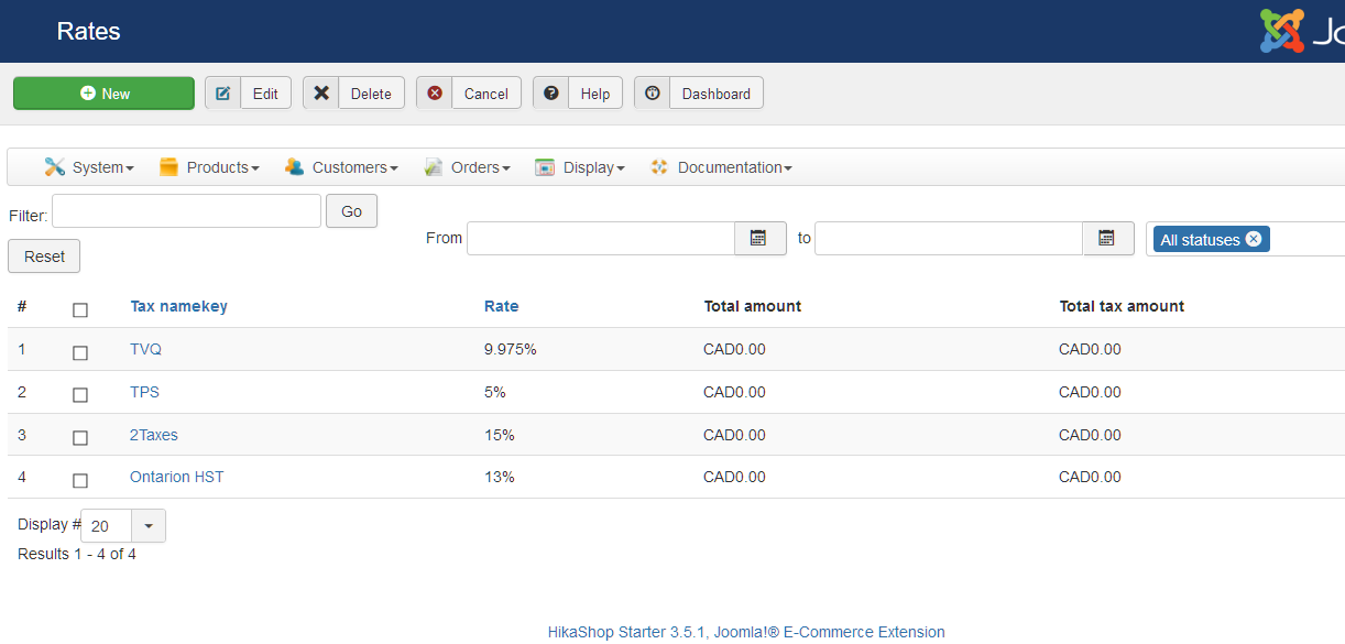

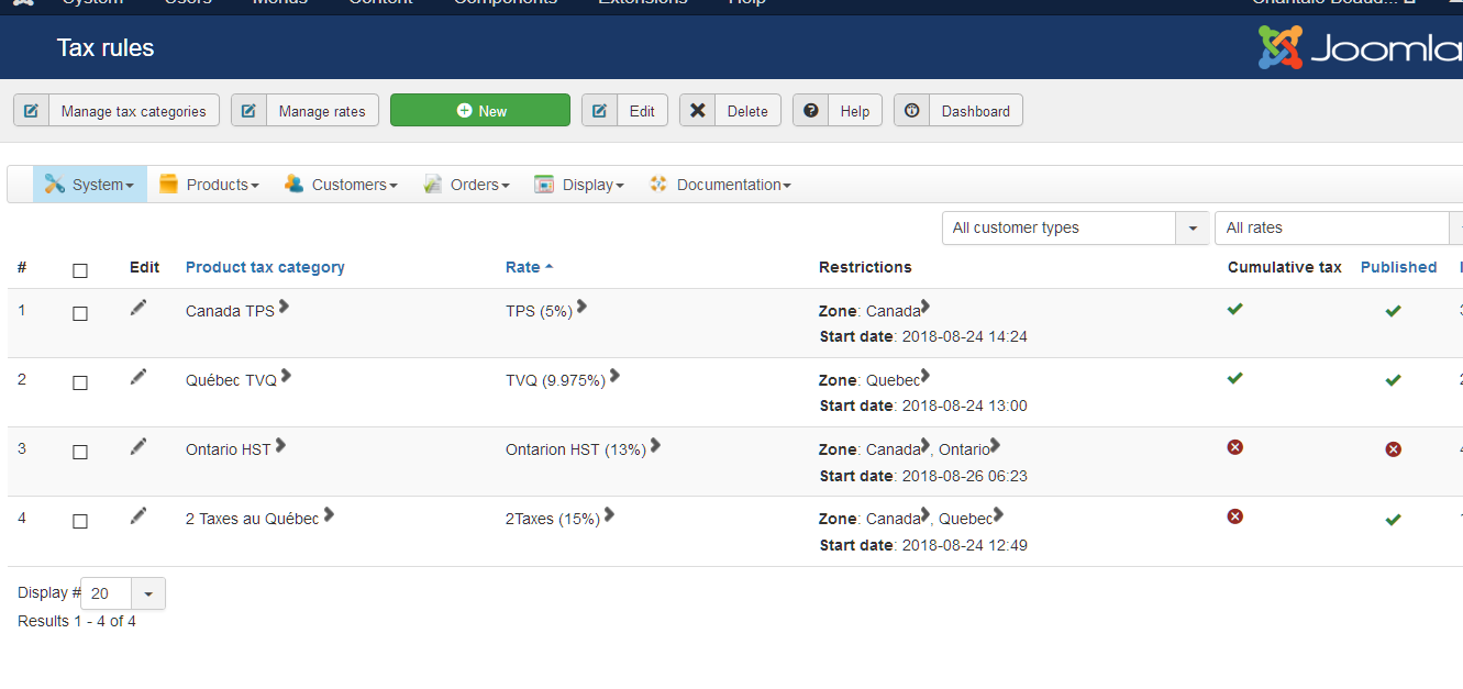

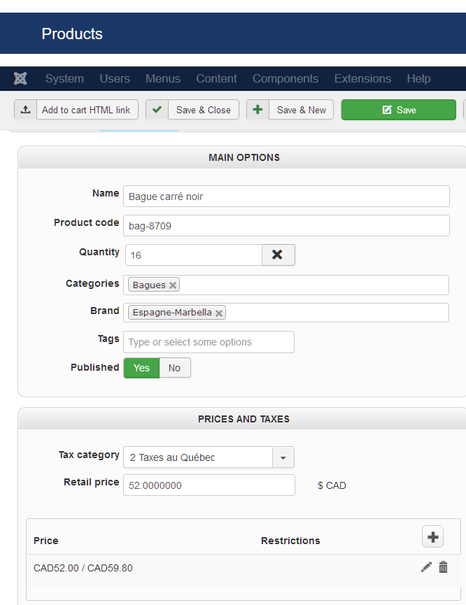

I am creating an e-Commerce site for a business located in Quebec selling to customers in different parts of Canada and I am trying to set up the taxes component.
In some provinces like Quebec there are 2 taxes PST and GST which are cumulative ( GST = 5% x Price + PST = 9.975% x Price to give a total of 15%). In other provinces like Ontario the is one harmonized tax ( HST 13%).
Attached are screen shots of my setup. I tried a lot of permutation without success.

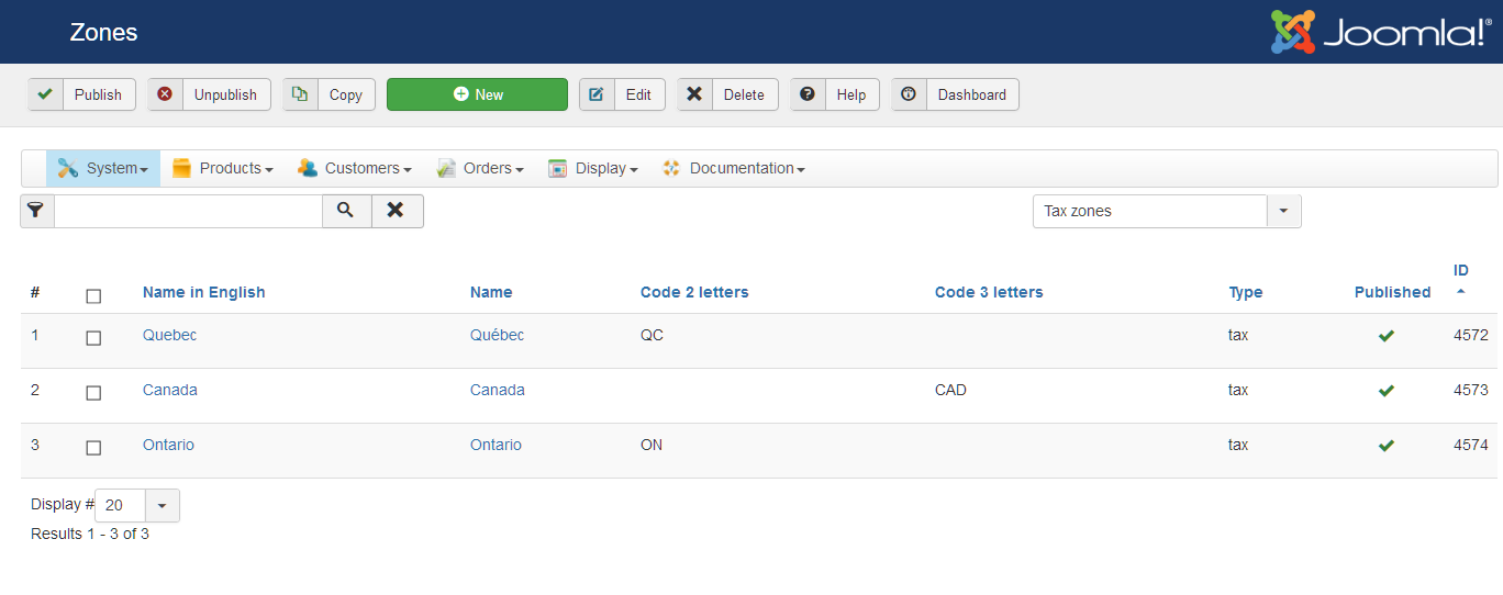

Zones
Rates
Tax rules

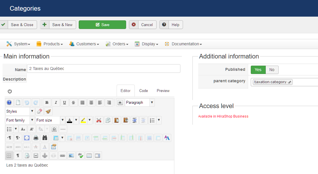

Tax categories
Product with 2 taxes
Product with PST (TPS in French)
I do not quite understand how the cumulative works.
I am not sure I set up the Zones Correctly. I have set up a Zone for Canada with 2 zub-zones one for Quebec and one for Ontario, but I see there are State zones and Tax Zones, I do not understand the difference and when either should be used.
I thought the taxes rate would be applied according to the address of the customer. But if, in the product, I have the 2 Quebec taxes, and the customer is from Ontario, the Quebec taxes are applied. Vice versa, if I have the Ontario tax in the product and the customer is from Quebec, the Ontario tax is applied.
I read the document «Taxation rules listing» where you state that in taxation rules screen «You will have to explain to the system which tax rate needs to be used in which zone for which type of customer» My question is HOW DO I DO THAT?

1. Regarding your zones, you don't need to create tax zones. You can directly use the Canada country zone and its state zones.
That will also avoid issues if you didn't configure properly the sub zones of these tax zones.

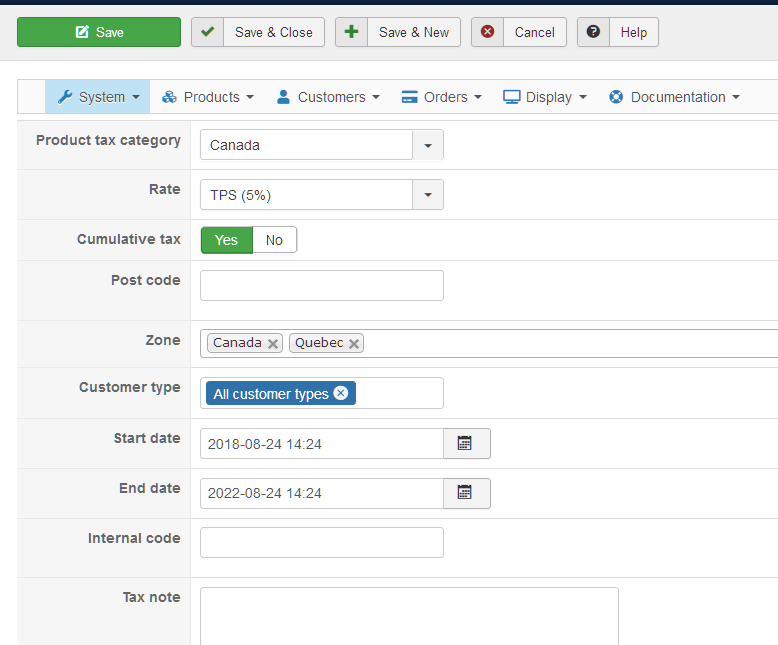

2. The Rates are correct
3. You only want one tax category and assign that tax category to all the products (unless they are taxed at different rates in the same area) and to all tax rules.
Then, in your tax rules, select that tax category, the rate and the zone and turn on the "cumulative tax" setting so that two tax rule can add their tax rate at the same time if they are for the same zone.

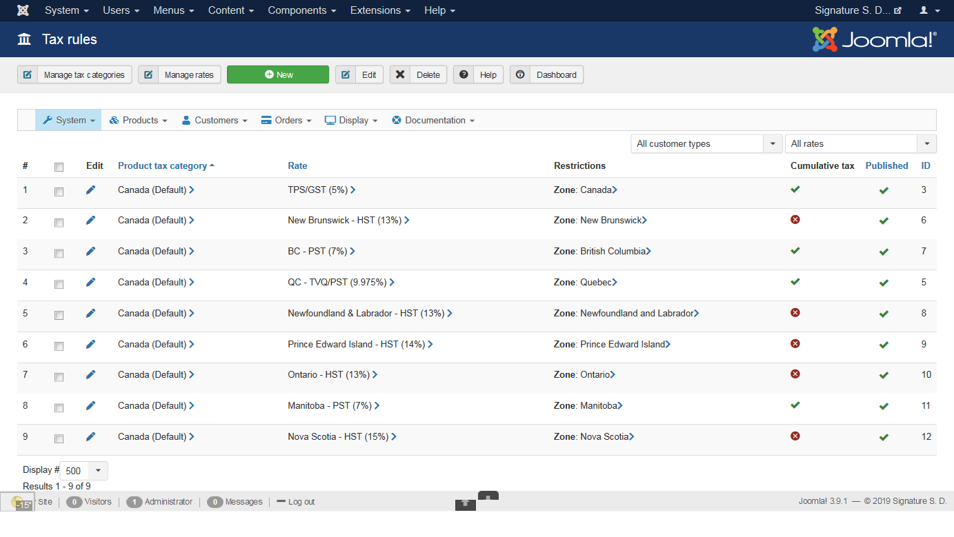

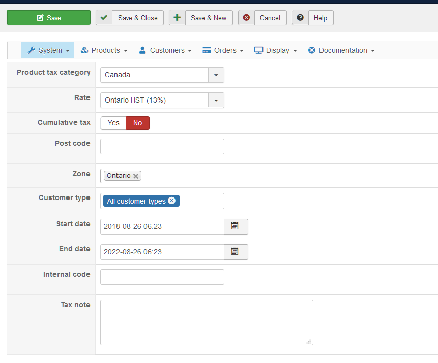

  • Posts: 7
7 years 7 months ago #302217
Thanks for he quick reply!

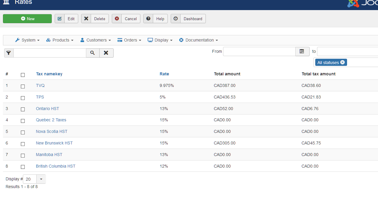

I've attached as screenshot of my tax Rates.
Based on the info you provided I setup 1 tax category (Canada) and applied individual rules for each province. Provinces with GST (Canada) and PST (Provincial Tax) I set as cumulative, whereas provinces with HST (Harmonized tax) that is meant to replace the GST rate I set as non-cumulative.
Is this correct?
Scott
  • Posts: 36
7 years 7 months ago #302223
Hi Scot,
Here is what I dd:
1- In System / Taxes/Tax Rules/ Manage tax Categories
  • I created a new One Canada
2- In System / Taxes/ Tax Rules/ Rates
  • I created rates (Give them meaningful name)
  • You need one for each GST, QST, HST for each province
3- In System/Taxes/ Tax Rules New
  • Product tax Category: Canada
  • Rate One you created
  • Cumulative Tax (Yes for Quebec, No for the others)
  • Zone The Province for which you created the rule
4- In you product under Prices & Taxes you have to put Tax Category : Canada
The system will calculate the correct taxes based on the address
I have attached snapshot of my current settings, hope that helps.

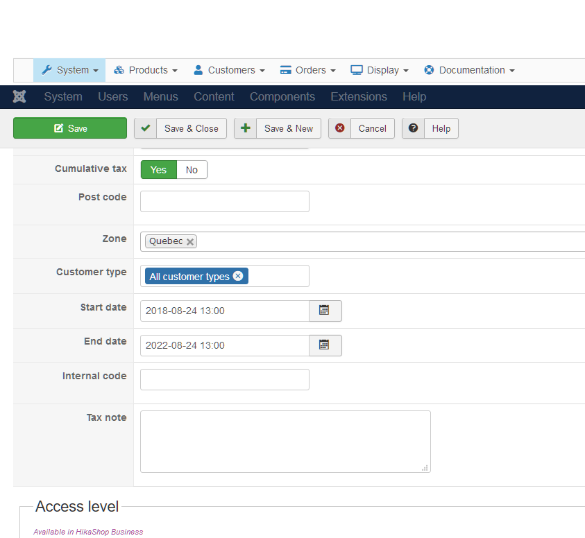

  • Posts: 7
7 years 7 months ago #302224
Thanks for the info, and the quick response!
I think I have set it up correctly but, after reading this article , my tax rates are different from yours. Ex. I have cumulative taxes in 4 prov, not just Quebec.
Does this screenshot look correct to you?
  • Posts: 86050
  • Thank you received: 14178
7 years 7 months ago #302219

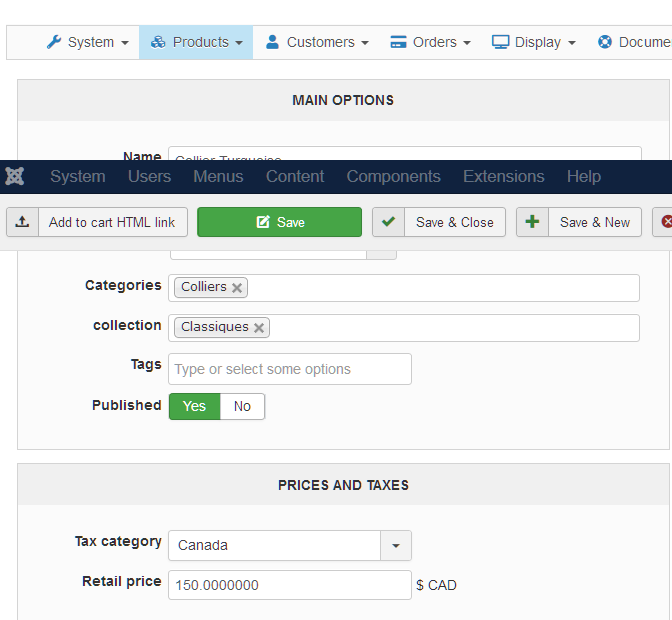

This looks quite good.
Did you also select that Canada (default) tax category in the tax category setting of your products ?
You need to if you want your tax rules to be taken into account.
Also, since these tax rules are restricted by zone, you'll want to be logged in with a user account with an address if your want to be able to see the prices with taxes. You should then see the taxes in the cart view of the checkout.
Let us know if you still have a problem and what problem you have exactly.

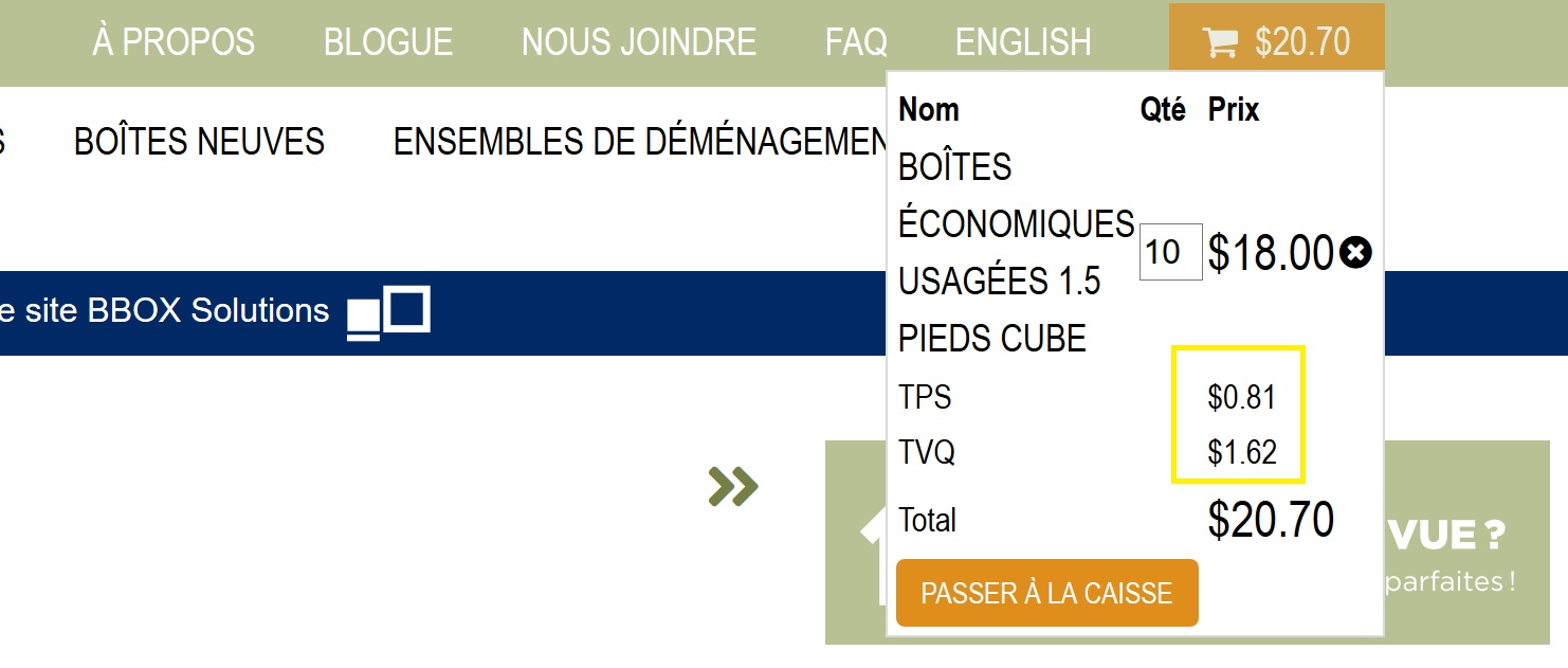

  • Posts: 31
6 years 11 months ago #310822
The recipe provided in this discussion doesn't seem to work.
When I compare the taxes calculation to the official calculator ( www.calculconversion.com/calcul-taxes-tps-tvq.html ), the amounts are different.
Let's say I have a product of 18$.
The TPS (5%) will be applied first and = 0.9
The GST (9.975%) will be applied next and = 1.8
For a total of 20.70$.
In Hikashop, if I associate my product with the option 2 Taxes (which include TPS and GST), the amout of the taxes are 2.43$
Curiously, the Grand Total is the right one.

  • Posts: 31
6 years 11 months ago #310868
I notice in your screen capture that you tested the checkout but the problem is actually at the level of the cart module. I attached a screen capture.
The Tax calculation plugin you mentionned is disabled. There is no discount.
