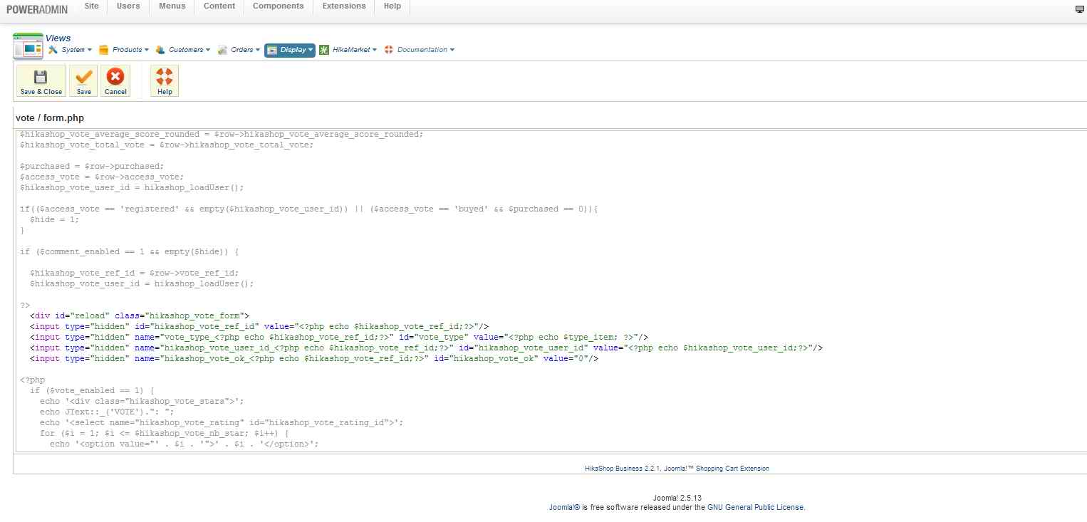

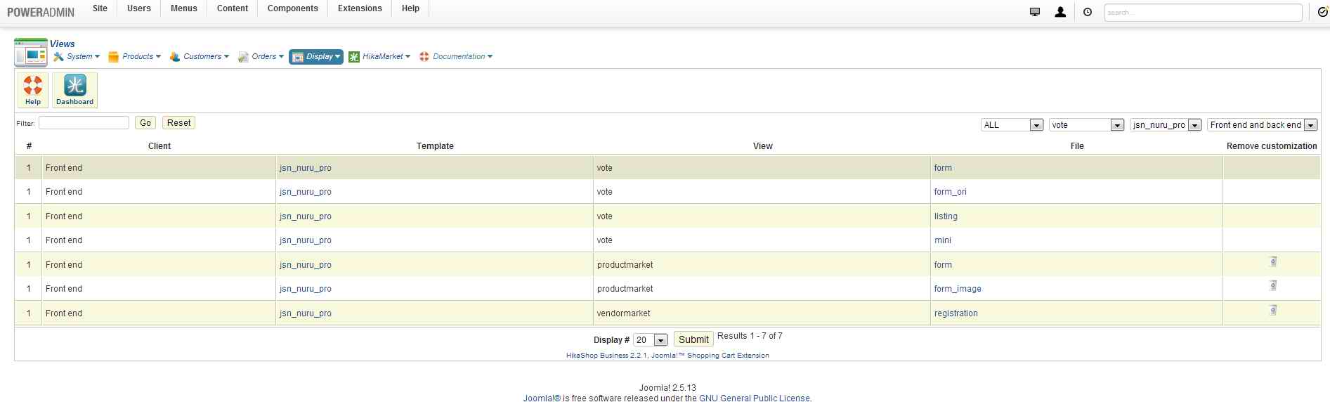

if I open the form ( see file 1
) I do not see the text in the solution description ( see file 2

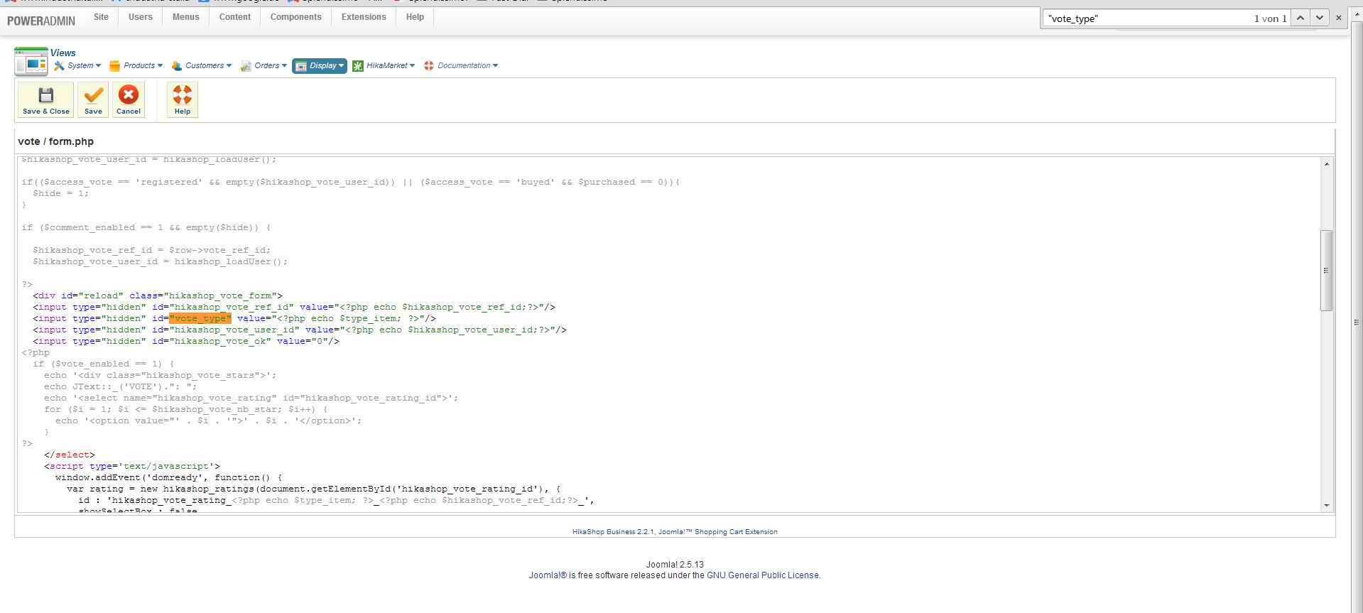

12 years 11 months ago #122424
I can see the lines I'm talking about on your screenshot. You even selected a piece of it in the screenshot.
