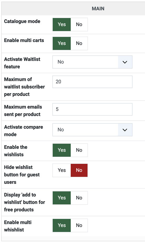

I have "Enable the wishlists", "Enable multi whishlist" and "Display 'add to wishlist' button for free products" all set to yes.
Cart notification plugin is set to popup.
Clicking the "Add to wishlist" button:
... in product listing, free product: "Product not added to the wishlist"
... on product page, free product: "The product XYZ is not available"
... in product listing, $100: "Product not added to the wishlist"
... on product page, $100: "Product successfully added to the wishlist"
So, no matter the main config, it only works from the product page and if the product has a price set. Is it me? Or a bug?

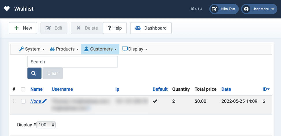

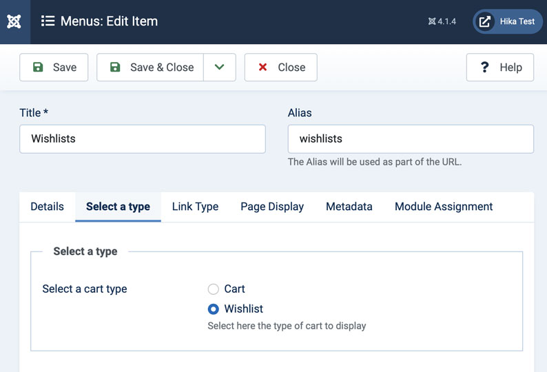

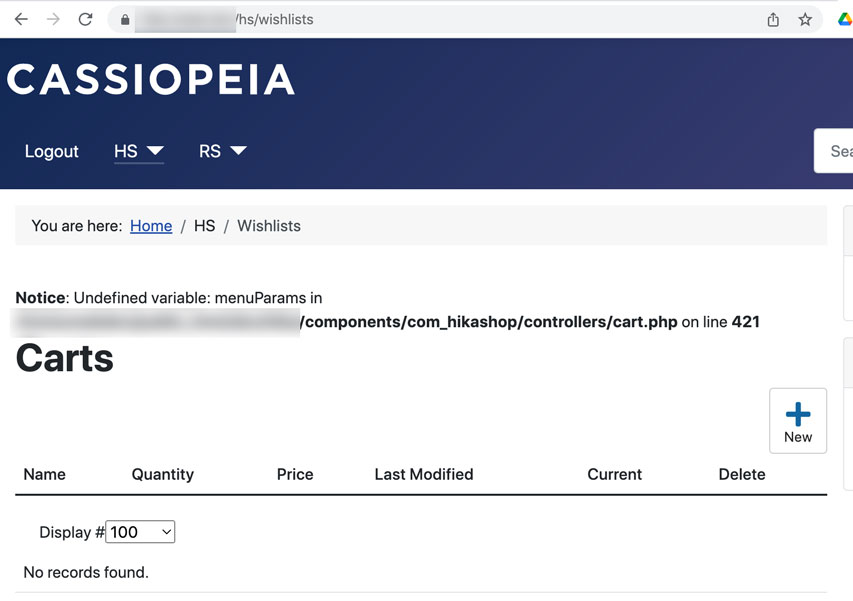

However, there's still an issue -- sorry. The "cart listing" menu item's setting for "cart" or "wishlist" does not matter, the page only shows the same "carts" listing. In my case now & here there is no cart, while a wishlist does exist. Plus there's "Notice: Undefined variable: menuParams in XYZ/components/com_hikashop/controllers/cart.php on line 421" -- the line number appearing to be in the region of the new code you had provided earlier.
Various screenshots attached.

  • Posts: 86080
  • Thank you received: 14188
4 years 3 months ago #341982
The code was still wrong in www.hikashop.com/forum/wishlist/904468-a...problems.html#341941
I've modified there. Please try that new version of the code and it should take the type into account properly.
The following user(s) said Thank You: lousyfool
  • Posts: 2143
  • Thank you received: 747
4 years 3 months ago #341983
YESSSSS, now working!
Thanks again, Nicolas!
