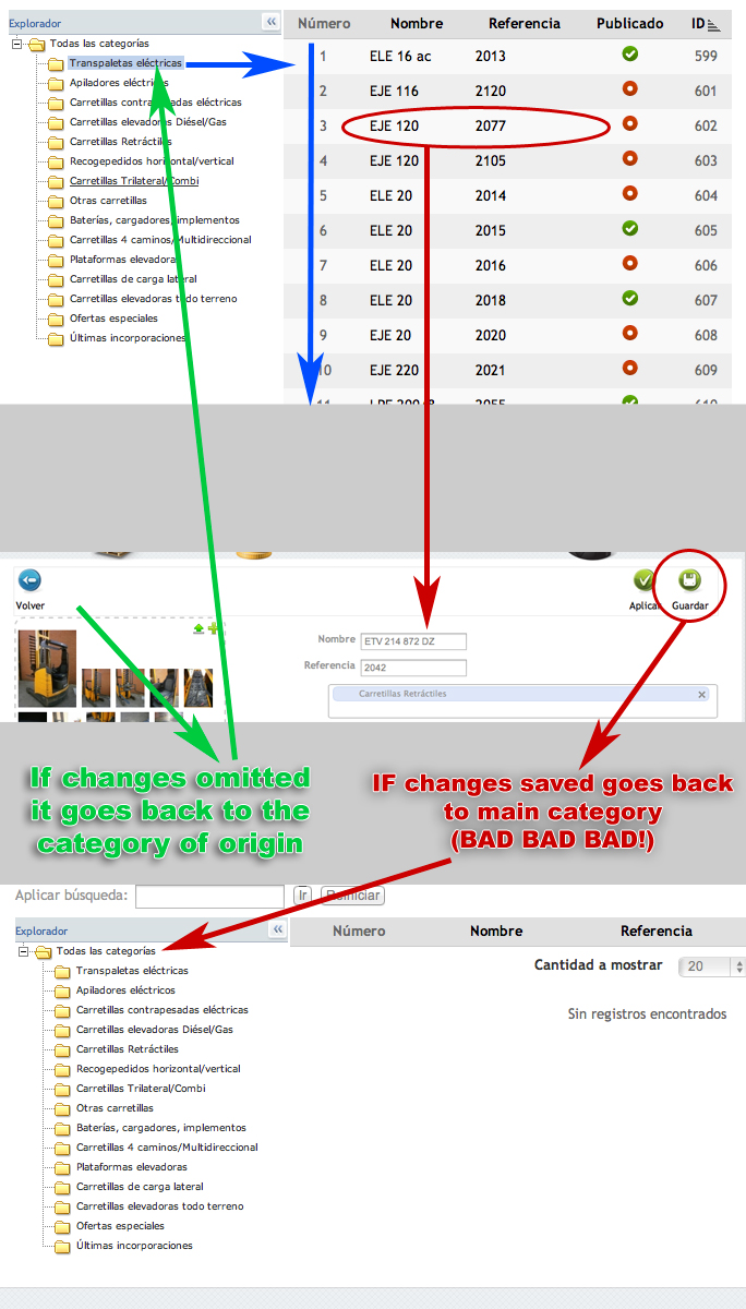

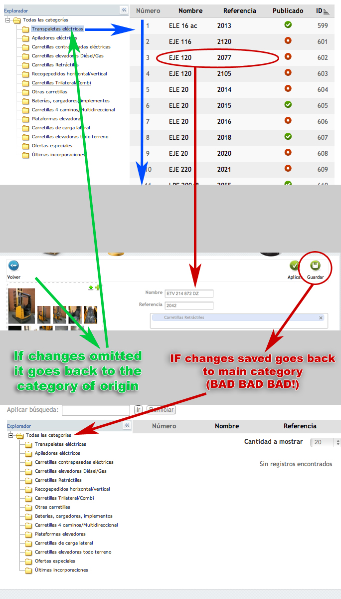

I need to fix an annoying behaviour of HikaMarket Product listing screen.
If I click a product of a subcategory for edit I get two different behaviours:
1. If I don't save contents and click the back button the listing stays in the subcategory I got on screen. THIS IS LOGICAL AND GOOD.
2. If I save changes the listing screen goes back to the main category which is WRONG WRONG WRONG because it prevent me to manage products on an organized manner.

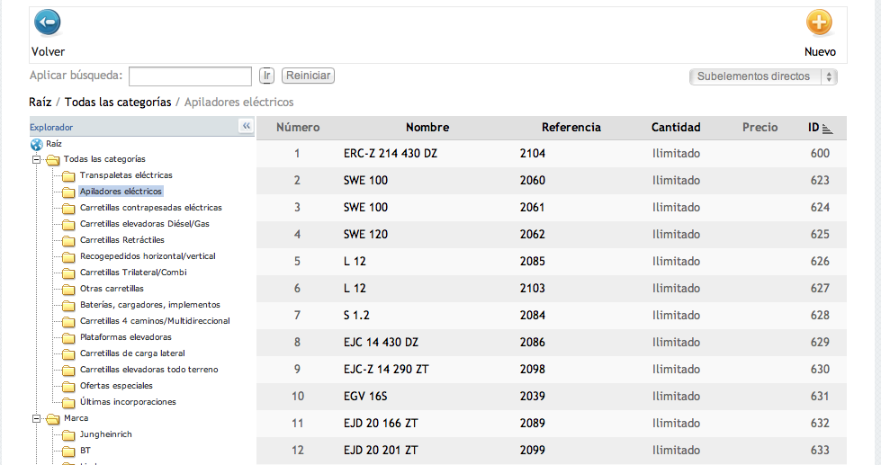

13 years 2 months ago #108634
After updating HikaMarket and HikaShop to their latest stable versions the problem persists.
If I save a product in HikaMarket the listing page comes back to the Main Category and doesn't stay in the last selected category, let's say, where my product was coming from.
This is inconvenient and unrealistic for the daily work as it doesn't allow to make serial review of you catalog.
Please try to fix it!
Thank you.
