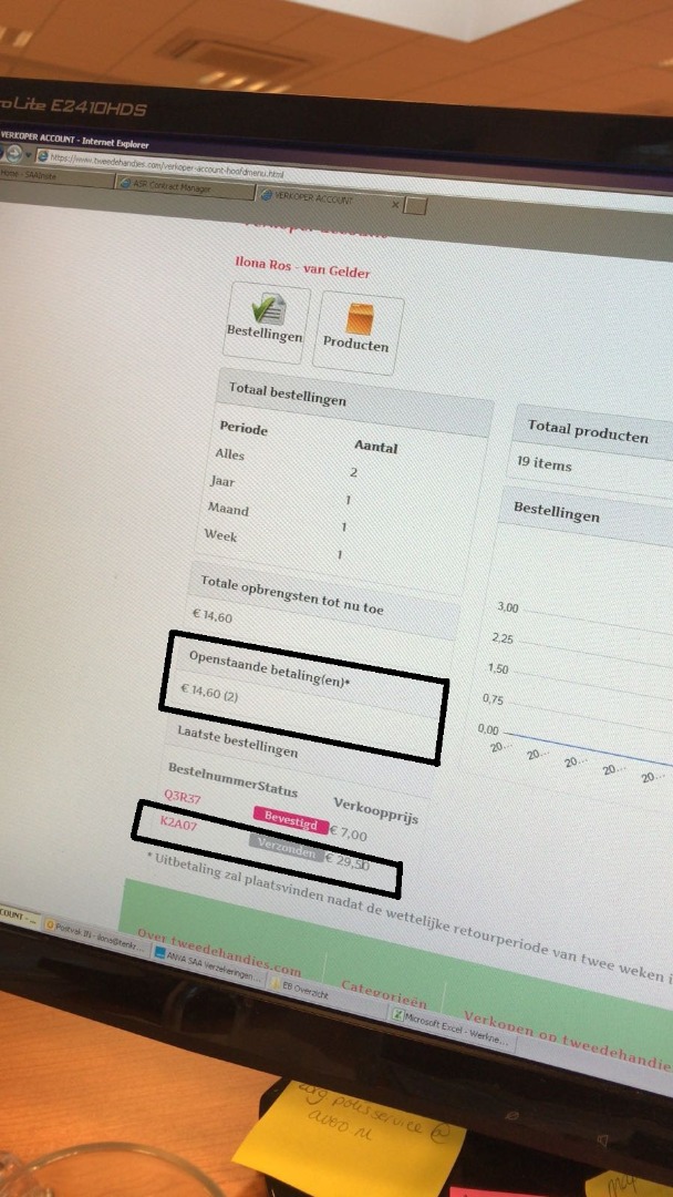

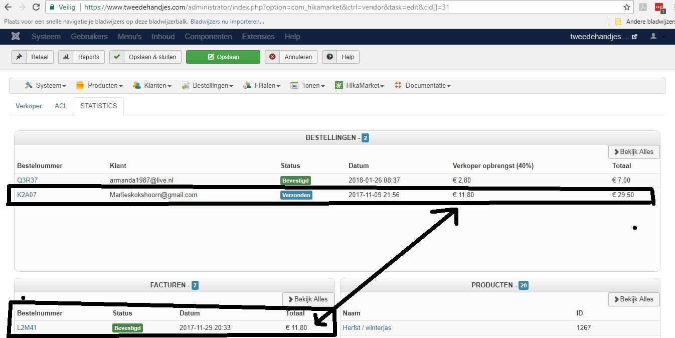

-- url of the page with the problem -- : www.tweedehandjes.com
In the back end I have paid out a vendor, but this payment isis not updated in front end in the vendor account.
The "order total unpaid" statistic is still showing it as unpaid. Please see attached screenshots.
What could be a reason?
Joyce
