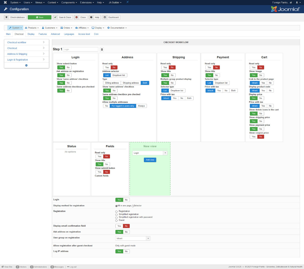

Sure. You just need to remove the view "coupon" from the "Checkout workflow" option of the Checkout tab of the config. More information about that option on:
www.hikashop.com/support/documentation/5...config.html#checkout

More specifically, you just need to hover on the "coupon" view in your checkout workflow, and you'll see the delete icon to delete the view. Here is a screenshot:
i.imgur.com/jII0YtQ.png

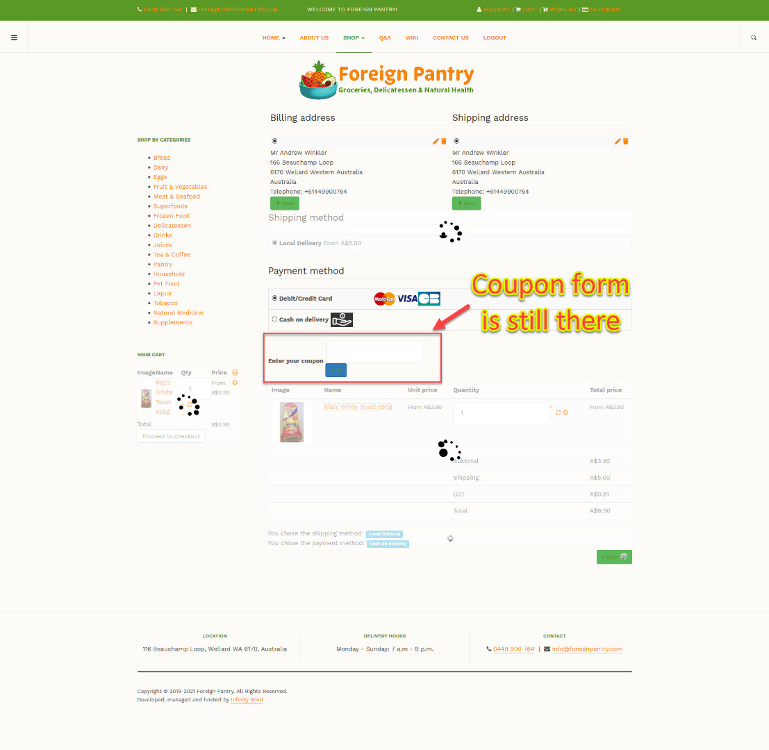

I've deleted the "coupon" column as you suggested.
However, the coupon entry form is still being displayed on the checkout page.
Last edit: 5 years 5 months ago by andrewwinkler.
5 years 5 months ago #330467
Then you have to remove the block coupon in your Checkout Workflow settings.
You can reach these settings from Main HikaShop option => Checkout Tab, then Checkout Workflow part
Hope this will fit your needs.
