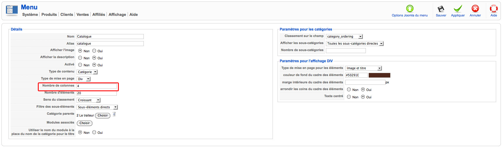

That's what I actually did : I created hikashop options menu for each one on the left side and also created a hikashop options menu for the catalogue ... the only difference is 'catalogue' is a category display ... the others products display
My problem is I would like to have the same display from catalogue than the others ... so products would be shown on 4 cols ... this is working when it displays categories ? but not when it shows products ...
In the default configuration : display option option is 4 cols and all my menus are set up on 4 as well ...
I probably do something wrong ....
screenshot is from the 'catalogue hikashop options menu'
Last edit: 15 years 11 months ago by seb.
15 years 11 months ago #3984 by nicolas
Replied by nicolas on topic Re: questions ?
You need to go in the hikashop menu Display->Content menus.
There, edit each entry's options and make sure that you have 4 columns set in each entry's options.
15 years 11 months ago #3985 by seb
Replied by seb on topic Re: questions ?
this is done allready :/ I'm always trying by myself first ...

15 years 11 months ago #4004 by nicolas
I saw that in the menu Display->Content modules, the two associated modules to the menus 9 and 11 had a number of columns to 3 instead of 4.
I browsed a bit your products and I saw four columns of productsso it seems ok.
Is the problem solved now for you ?
15 years 11 months ago #4022 by seb
Thought I checked everything ... thanks nicolas. Yes it's working fine now !
