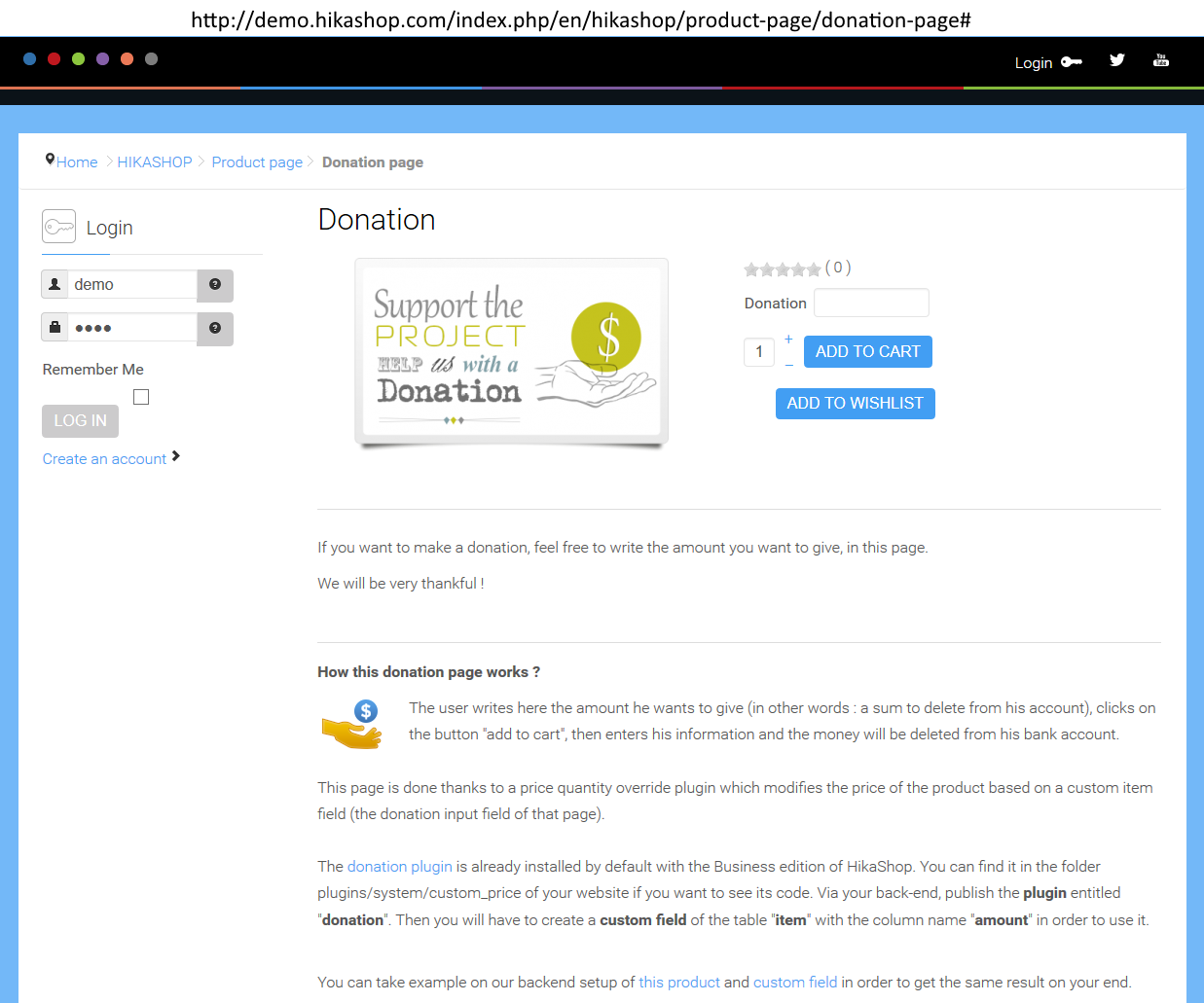

Yes ; You can easily find the new donation page in the demo website ; it's under "hikashop > product page > donation page".
demo.hikashop.com/index.php/en/hikashop/...t-page/donation-page

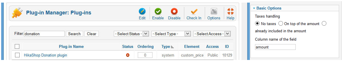

Did you turn on the donation plugin via the Joomla plugins manager ? I don't see any other reason. Your custom field looks like it is configured properly

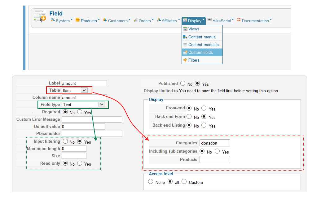

Yes. The Donation plugin requires the creation of a custom field of the table "item" via the menu Display>Custom fields and that is only possible with the Business edition of HikaShop.

Here a composite capture screen that show relation beetween the word amount .

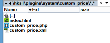

E) This donation plugin is a great way to learn more about HKS plug in API !!! what is the name of the php source file ? ( plg_system_custom_price ? )

I "think" that I did all what I found in all the articles about "donation" in the forum, I have visited the demo site in back and front end...
My new field give me the right preview expected, the plugin " HikaShop Donation plugin" is "on" in joomla plugin and uses the right name of the filed.
But in my front end donation page, I dont see any filed for the amount, like in your exemple.
And it don' take correctly the caracteristics that is use otherwise for classical product with exact price in the same space (but in a different category).
The only "wrong" thing possible, is that I don't see the "HikaShop Donation plugin" in the Hikashop plugin List ?

If you don't see the field for the amount, the issue is most likely with how you configured your custom field.
You probably didn't select the "item" table when creating it, or you restricted it to a category not linked with the product, or you restricted to a user group which your user is not attached to, or you didn't activate the "frontend" display setting of the custom field.
If you could provide a screenshot of the settings of your custom field, it would help tell you what's wrong.
