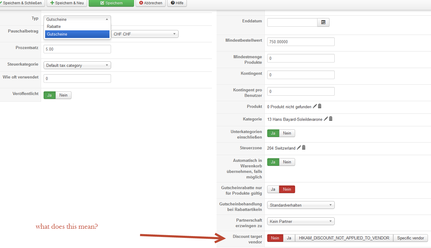

12 years 1 week ago #167091
Hi Jerome
I tryed everything :cheer:
amybe i am doing something wrong.
pls find attached my config.
Markus
12 years 1 week ago #167103
The best is to simply and directly ask your question about the option "Discount target vendors".
Not in the screenshot like you did but just here, in the forum, in the first line of this thread.
* No : The discount won't target products sold by vendors.
* Yes : The discount will target products sold by vendors and will be applied for the vendors.
* Not applied to vendors : The discount will target products sold by vendors but for the vendors, the discount won't be applied (so you're store will absorb the discount).
* Specific : Once selected, you will have a popup to select a vendor. At this moment the discount will target only the products sold by this specific vendor (and will be applied to the vendor).

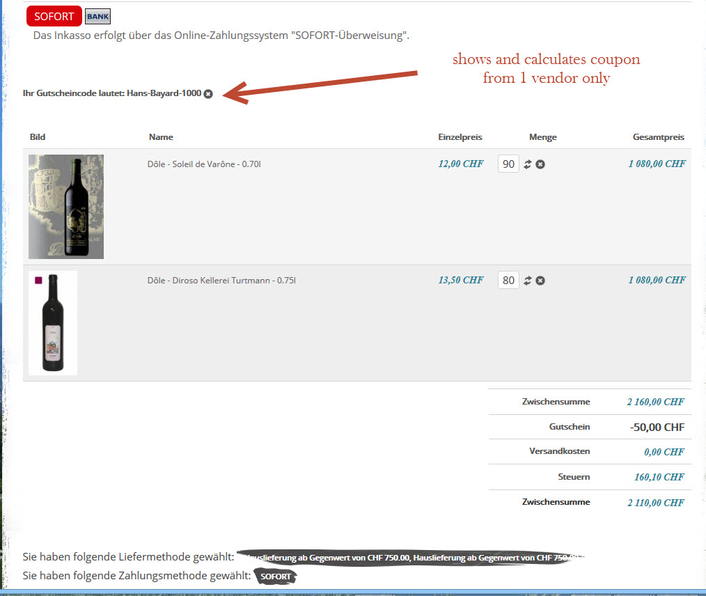

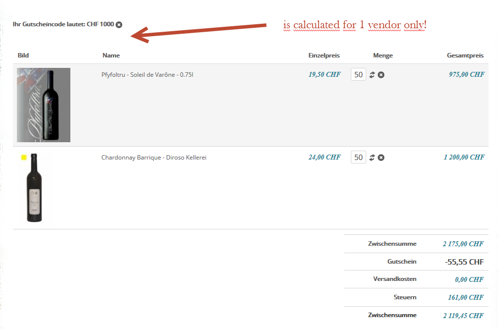

12 years 1 week ago #167550
Hi Jerome
Discounts does not work properly. As you can see in my attachements, the discount gets calculated for one vendor only. Allways just for the first one for which you buy a product.
Markus

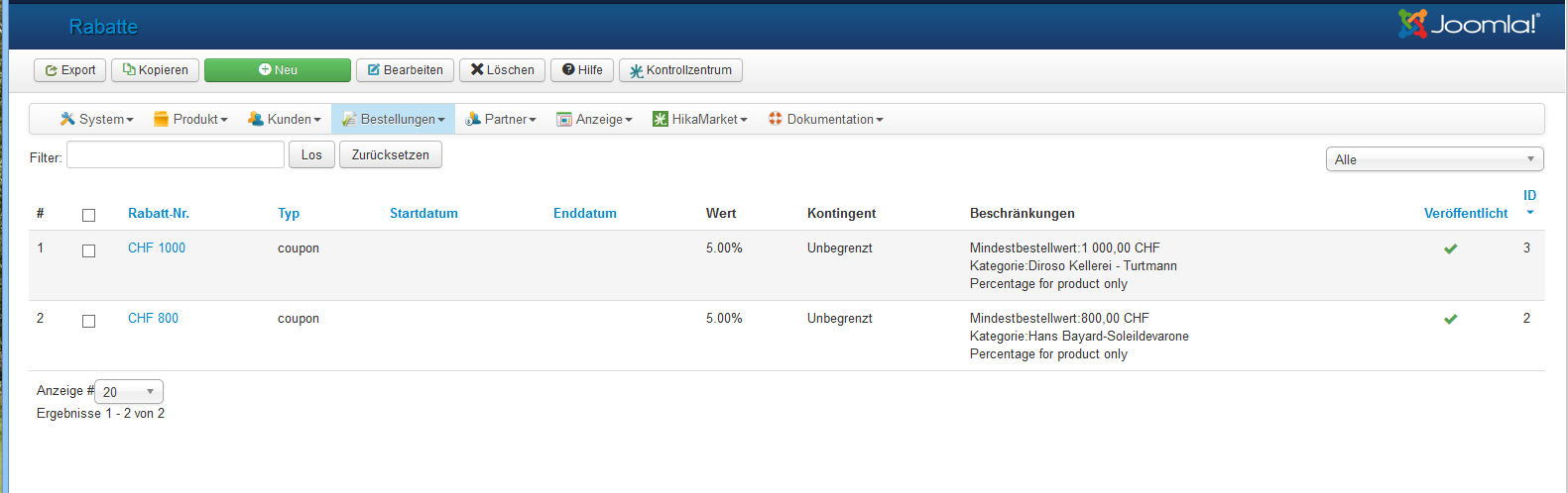

12 years 1 week ago #167581
Your coupon "CHF 1000" is configured to target only the vendor "Diroso Kellerei - Turtmann", so it will be applied only on the products sold by the vendor "Diroso Kellerei - Turtmann".
Because the product "Pfyfoltru - Soleil de Varône" is sold by the vendor "Hans Bayard-Soleildevarone", the coupon is not applied on this product.
Please read my previous post, it explain exactly how it works.

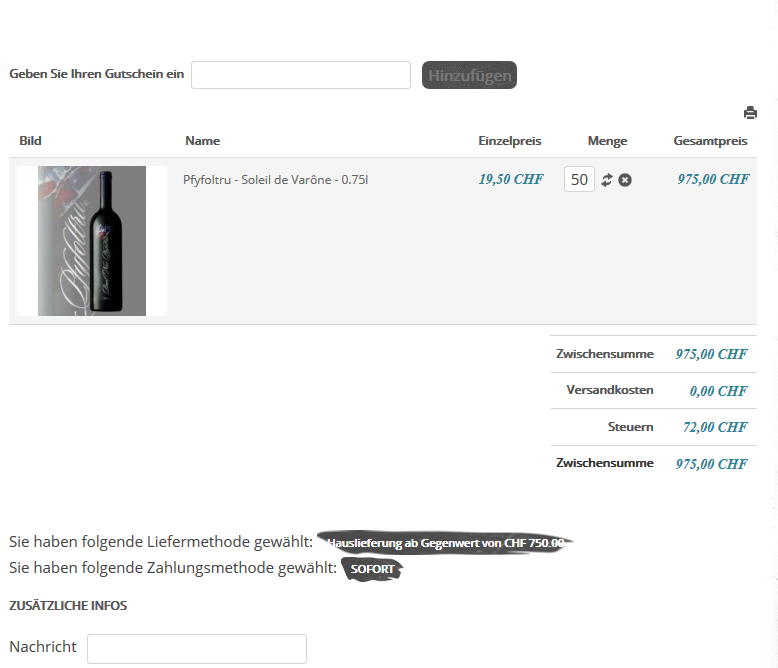

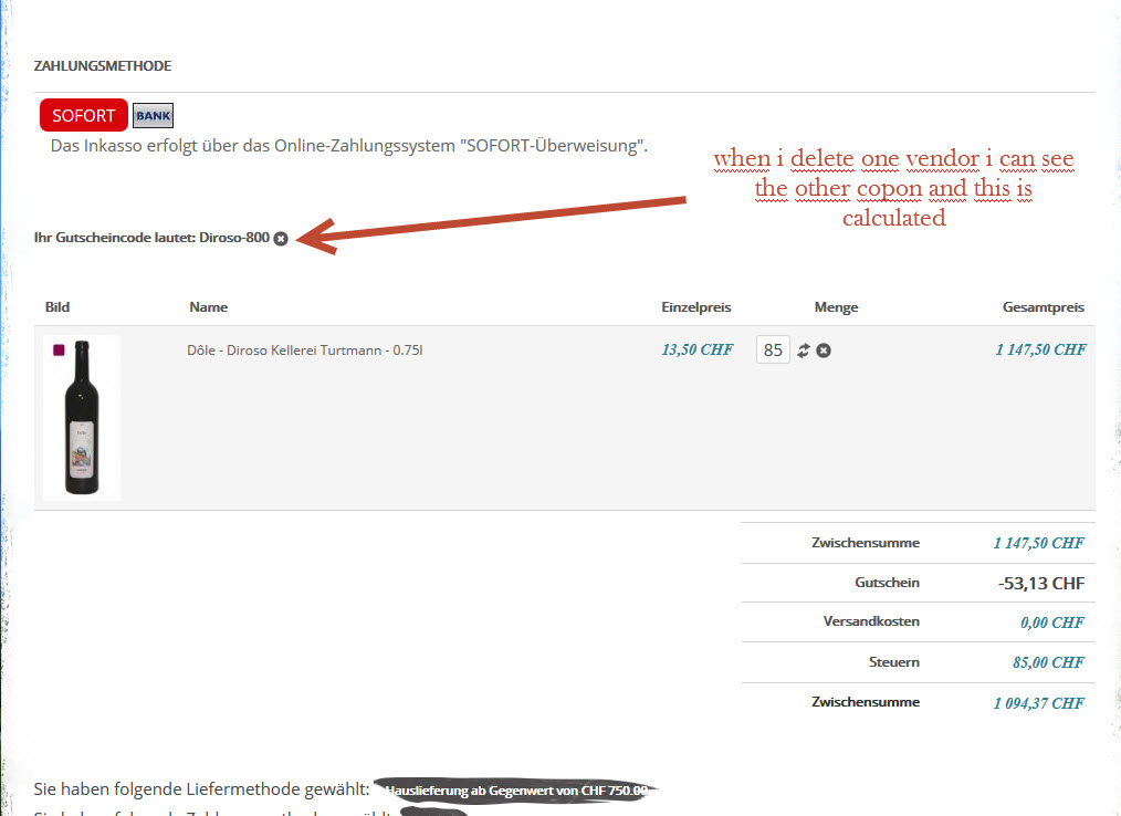

12 years 6 days ago #167748
It s not working properly.
I have deleted the entries and did setup 2 different coupons again completely the same way. As you can see in the attachements, 1 copon is showing up and is calculated. when i delete one of them, the other copon is showing up and calculated.
markus
12 years 6 days ago #167749
I am sorry but I don't understand what you did.
Delete what ? Showing up how ? What is the process ?
What is the coupon configuration ? What do you want to achieve ?
Please provide me more details because I really don't know what you are trying to explain.

  • Posts: 116
11 years 11 months ago #168975
Hi Jerome
II f i define discounts, nothing is showing up.
I have defined a discount 5% for all purchases and a discount for 10% purchases for more then CHF 1'000 for a specific vendor.
None of them are calculated.
When a specify a coupon for 5% for all purchases, it is porperly calulated.
When i specify a coupon for 10% for the same vendor, only this is calculated.
So, what do i have to generate, a discount or copon do be used?
Marku7s
11 years 11 months ago #168992
The discount like I explained in my previous post is working good.
I make some test and I have right discounts (not coupon) for vendors.
I also tried a discount for all products (applied to vendor) and a discount for one single vendor ; working fine too.
which make me think that you are not creating discount.. But coupons.
Because it's not possible to set such kind of restriction for the discounts.
If you want to create a discount, you have to use a discount; for sure.
The coupon is : a coupon code.. Something that the user will enter during his checkout to have the specific discount.
So to apply a coupon, you have to enter the coupon code ; otherwise the coupon won't be use (and like I said, you can have just one coupon code for an order in HikaShop).
