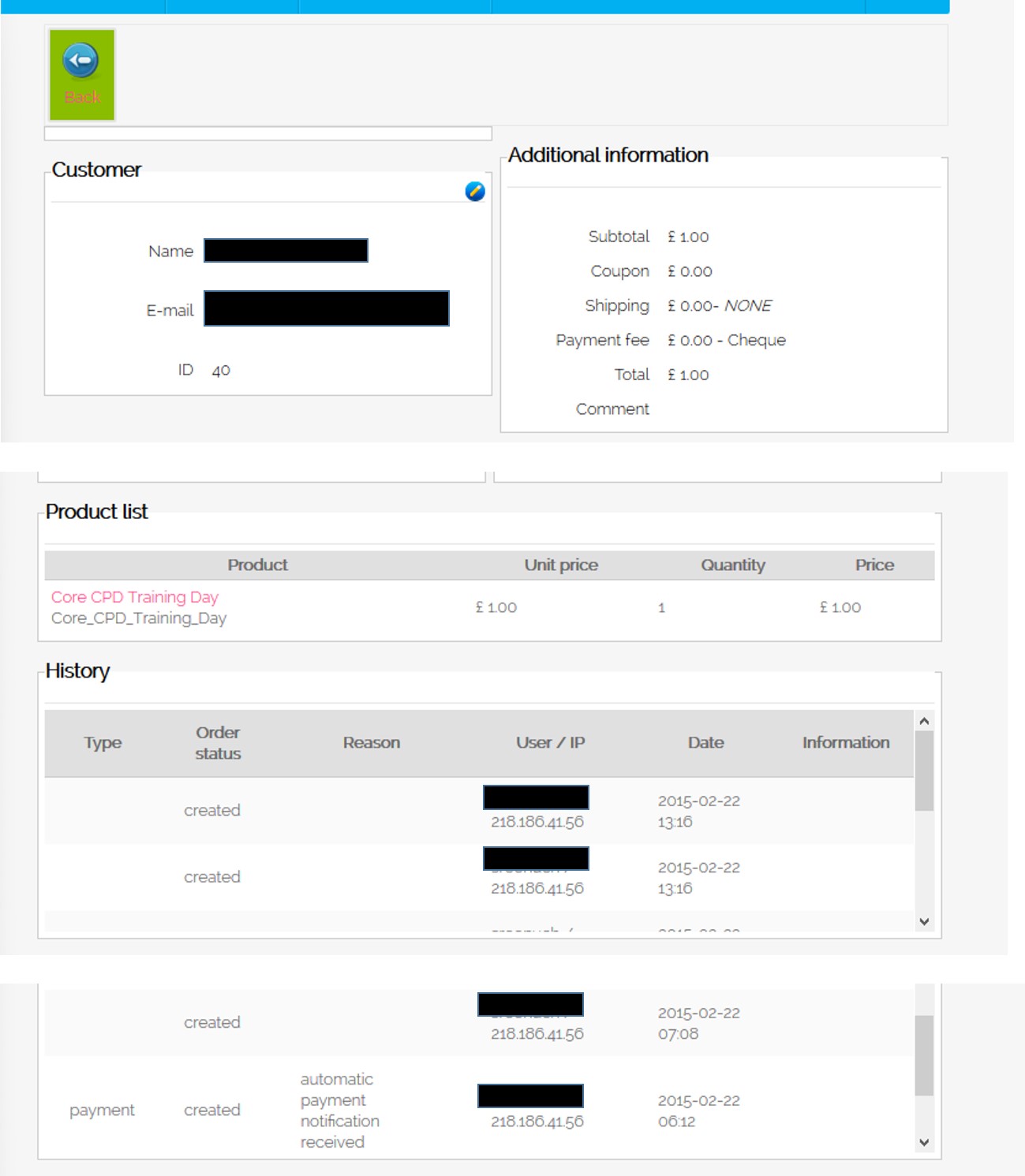

- The first one, screenshot_01.jpg, shows the order that I would like to edit. You can see it in the 'Main Information' box.

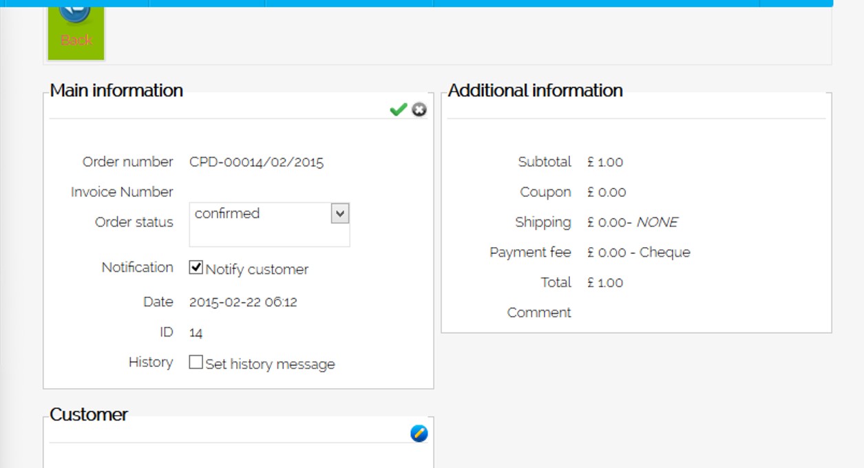

- The second one, screenshot_02.jpg, shows the order status was edited from 'created' to 'confirmed'. Then. click 'save'. The green tick icon.

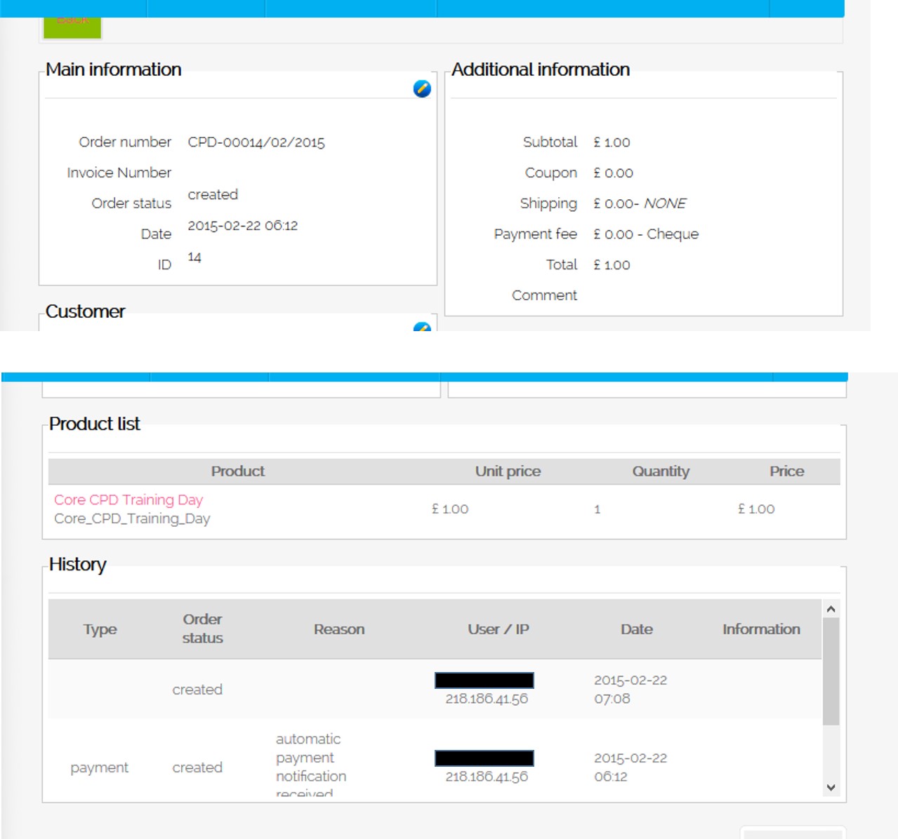

- The thrid one, screenshot_03.jpg, shows what happened after I clicked 'save'. The 'Main Information' box disappeared (not sure whether it collapsed). If you check at the order history, then you can see that it is still 'created'. It did not change to 'confirmed' as intended.
