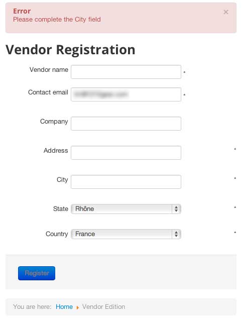

I noticed a few little oddities - nothing critical or urgent, but would sure be nice if you could look into this:
1. Email "Market: Vendor admin registration":
The "To Name" is not the admin or site name, but the vendor's name. So, it's being sent to "Vendor Name <This email address is being protected from spambots. You need JavaScript enabled to view it.>".
2. Vendor registration form:
If validation catches an error in a single field causing an error message and preventing successful registration, the form is reloaded with all fields empty, forcing the wannabe vendor to fill in all fields again.
(I've seen this mentioned in another thread - thought it was about a previous version and was fixed in 1.6.3?)

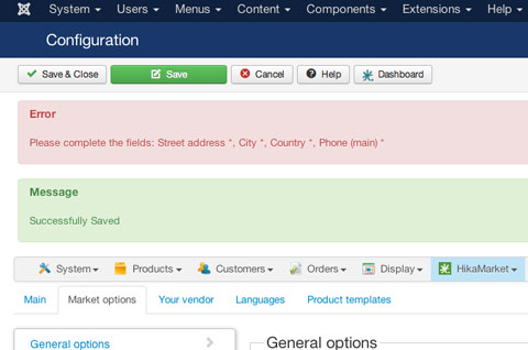

3. Misplaced error message in backend?
If any vendor profile (incl main vendor) has empty but required address fields, the error message as per attachment here appears on every save of the configuration in the backend until the fields are filled. Maybe you intended it as reminder to the admin that some required fields are empty? Otherwise I'd say the message shouldn't show there.
4. "Display limited to" in custom vendor_address_* fields:
Doesn't work. Limited fields are displaying all the time.
5. Not a "bug", but more of a question:
After successful vendor registration, an empty page with only a system message ("Thank you...") appears. Is there any way to define redirection to a specific other link/menu item? Would be sure nice for a different welcome message. One day in the future make it an option in the backend? Meanwhile perhaps a hint on how to (hard-)code it in?

3. It's normal.
I don't want to refuse the save of the configuration (or the main vendor) even if the profile is uncompleted.
The messages are displayed so the user is informed that he can fill the missing elements of the main vendor but I didn't want to make that "critical".

2. Hmm, why does it still happen in my 1.6.3? The field values are empty when the page refreshes with the error message.

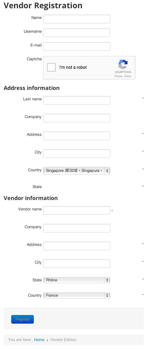

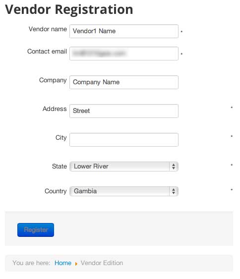

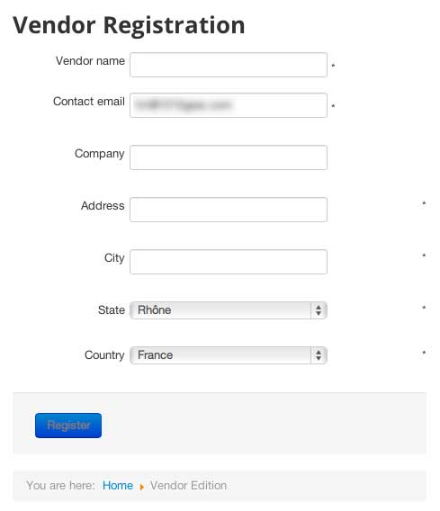

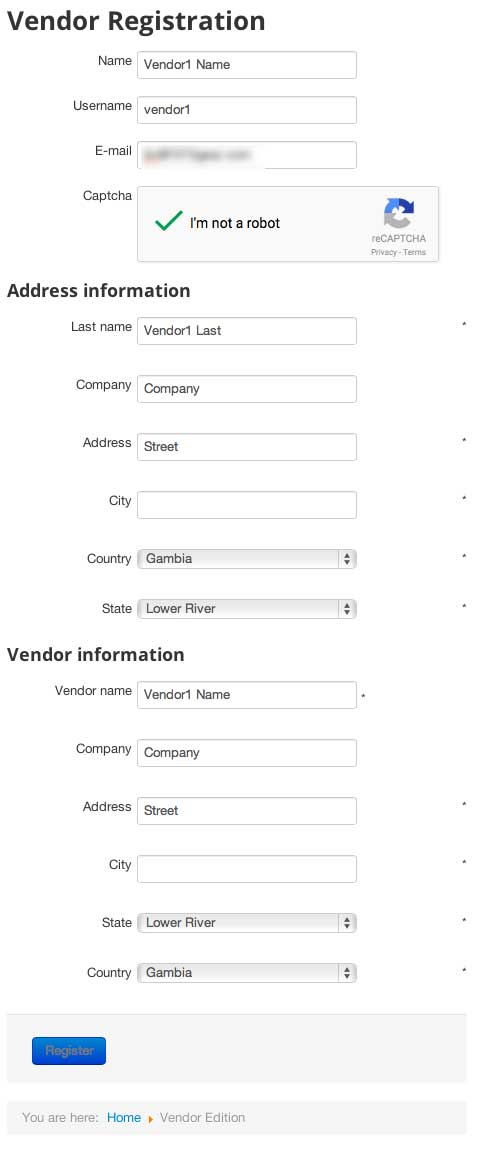

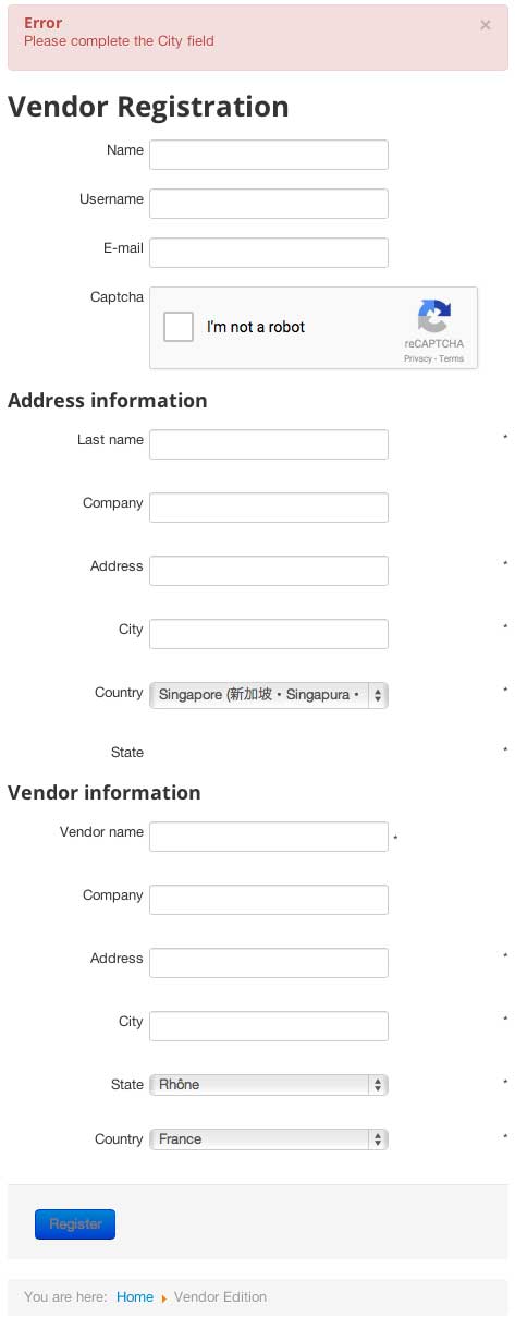

Now, I'm still able to reproduce the "forgetful" vendor registration. It's so plain simple that you must understand why I'm baffled how you can not reproduce it.
Here I hope all you need to finally experience it yourself:

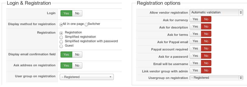

Setup:
Joomla 3.4.1, Protostar
No extensions other than HikaShop 2.5.0 and HikaMarket 1.6.3

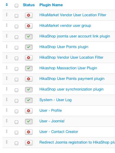

Status of plugins relevant for user and registration:
Relevant options in HikaShop & HikaMarket (as plain and simple as it can get, I guess):
Scenario 1:
Guest registers as vendor.
(Not relevant for me in my case, but anyway.)
Registration form 'before' (Note: I unpublished/unrequired a few default fields to make it shorter for this test):
Registration form 'filled' (Note: the required City fields I forgot - on purpose):
Registration form 'after' clicking button - all fields empty:
Scenario 2:
All the same, but logged-in Joomla user - now decided to register as vendor.
(My default case.)
Registration form 'before' (same unpublished/unrequired fields as above):
Registration form 'filled' (Note: the required City field I forgot - on purpose):
I can't think of any setting wrong or missing which could prevent the form from returning still 'pre'-filled. And again, I can't think of any reason why you were not able to reproduce it, but I hope you are now.

11 years 2 months ago #206772
Okay I got what you're doing.
You do not fill a required vendor custom field that you display during the registration.
And the vendor custom fields are the first element which is checked.
Your screenshots are confusing because you do not fill the "city" for both addresses but the message is just for the vendor custom fields.
And I generally do not display the address vendor fields because HikaMarket automatically copy the address from the user to the vendor.
Okay !

Eerrrmm... guess I should also mention the PHP error that's thrown:
"Warning: Creating default object from empty value in /blablabla/components/com_hikamarket/views/vendormarket/view.html.php on line 624"
Actually, it should be a different line number because I left the old code in and only uncommented it, etc, Anyway, the line in question is
if(!empty($vendor->vendor_params)) {
Hope it helps.
