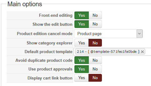

When a vendor adds a new product it is not marked for approval. In the database the 'product_type' field contains 'main' but I think it should be 'waiting_approval'.

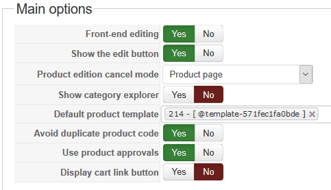

I have 'Use Product Approvals' set to Yes:
regards
Trevor

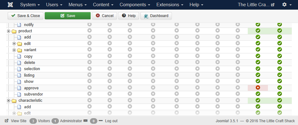

  • Posts: 26355
  • Thank you received: 4068
10 years 1 month ago #238350
Please check the ACL of your vendor ; the setting "use product approvals" is one part of the system.
Because if a vendor have the right "product/approve" ; his products will be directly approved.
(and for users of the main vendor ; it also allow them to approve products of other vendors).

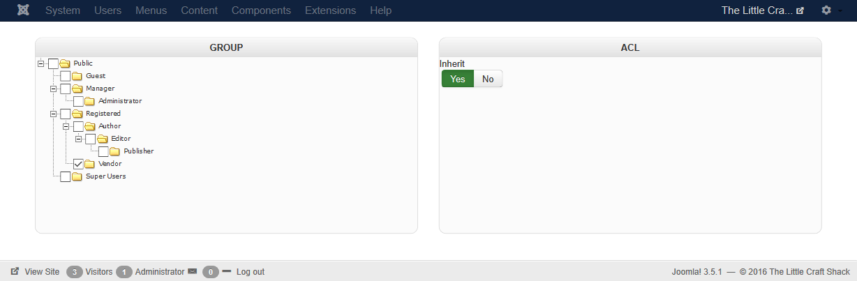

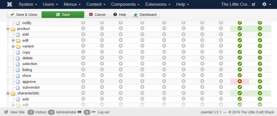

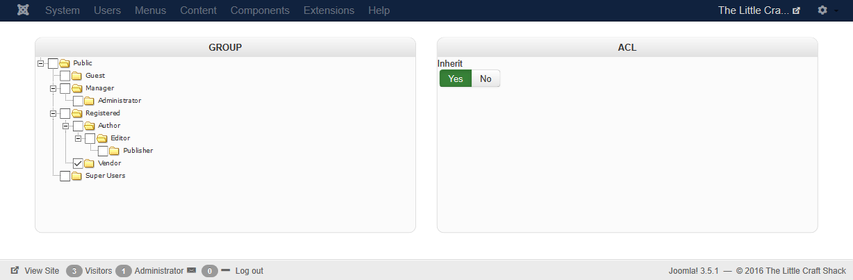

10 years 1 month ago #238390
The vendor has global ACL set:
and in the global ACL, Product Approve is disabled:
I also tried setting the non-global vendor acl settings with the same results.

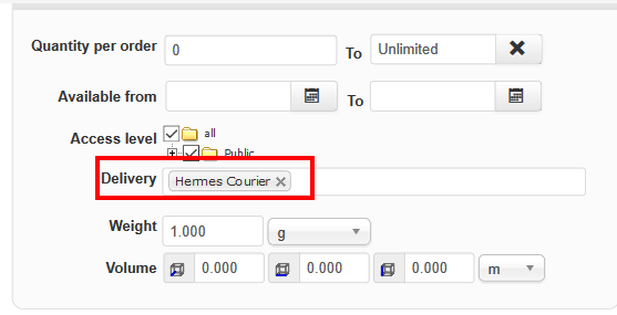

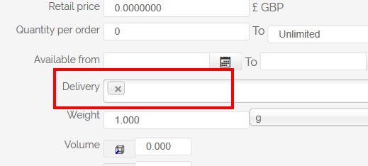

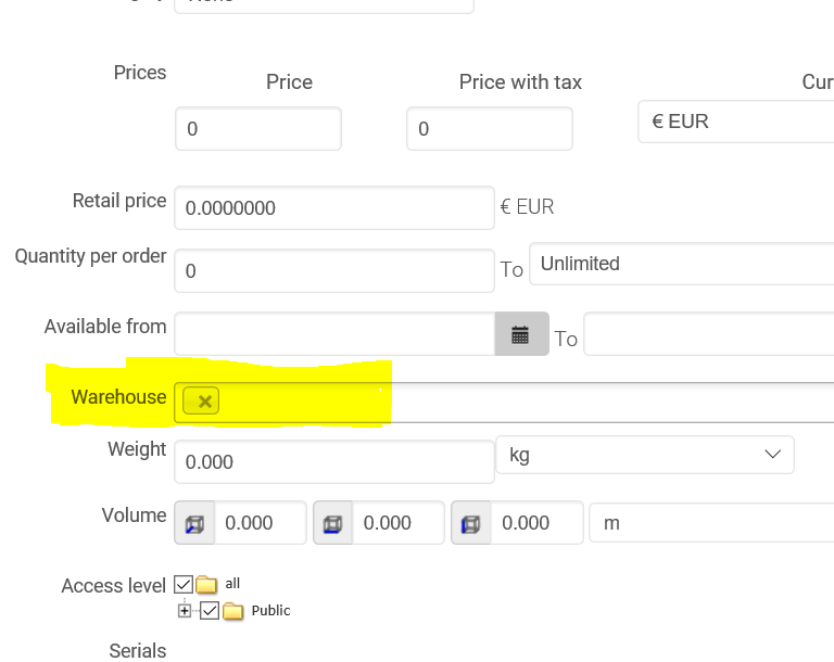

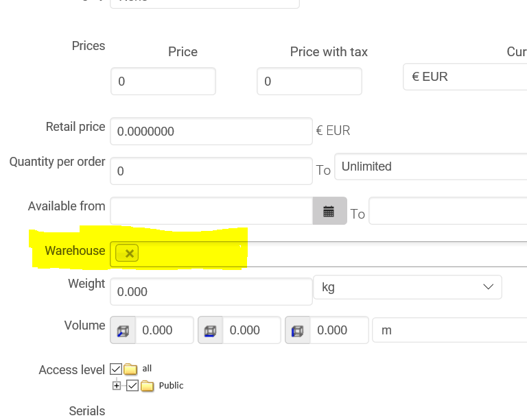

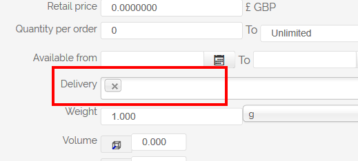

Another issue that I have just noticed is that the Warehouse setting for the product is not displaying correctly if viewed from the vendor control panel. (I have renamed 'Warehouse' to 'Despatch'):
Back end product edit:
Vendor admin view of the product:

Thanks for the screenshots ; I'll try to reproduce your issue in my local website using the same configuration.
I fixed the warehouse namebox with the same fixe which has been added into HikaShop.
That patch will be include in the next release (and I'll update the demo website during the afternoon with the latest dev package).

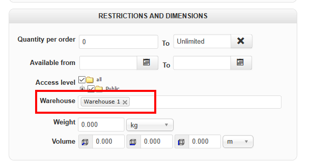

10 years 1 month ago #238511

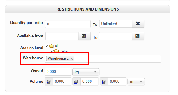

I have tested the problem with the warehouse not being displayed on the vendor's view of the product and can reproduce it on the demo site:
I created a product from the vendor control panel called 'Another product approval test' with a warehouse called 'Warehouse 1'
Product viewed from the back-end admin:
The warehouse is not displayed when the product is viewed from the vendor's control panel:
