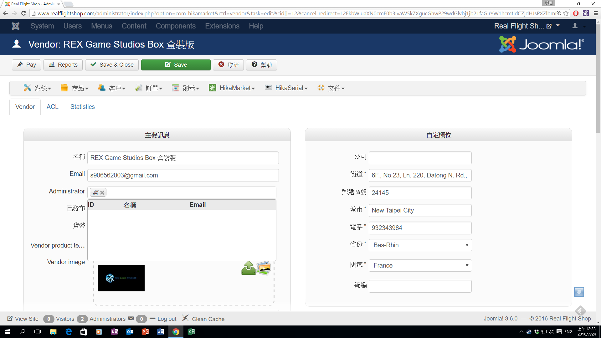

I found I can not select Vendor administrator in vendor create page today.
It was fine yesterday, but today, the administrator selection dropdown menu became empty as picture show below.
Is there any solution for that to come up User for me to select for administrator and Vendor created page
Many thanks!

  • Posts: 26355
  • Thank you received: 4068
9 years 10 months ago #246237
I am not able to reproduce your issue in my local website or in the demo website.
Would it be possible to have an access to your website ?
A backend account and a FTP account would be required in order to test and add some debug trace.
There should have an element which corrupt the data and make the list empty ; but I have to investigate in order to be sure of that and find the appropriate patch.
Please use the contact form in order to send us such kind of private information (with a link to that forum thread so the support team will assign the ticket to me).
  • Posts: 26355
9 years 10 months ago #246271
When I went to the page:
administrator/index.php?option=com_hikamarket&ctrl=update
I got a message telling me
You have the latest stable version of HikaMarket Multivendor: 1.7.0
So, you do not have HikaMarket 1.7.1 ; which means that you have the bug which has been fixed in HikaMarket 1.7.1
www.hikashop.com/support/documentation/1...arket-changelog.html
Fix for the user namebox.
