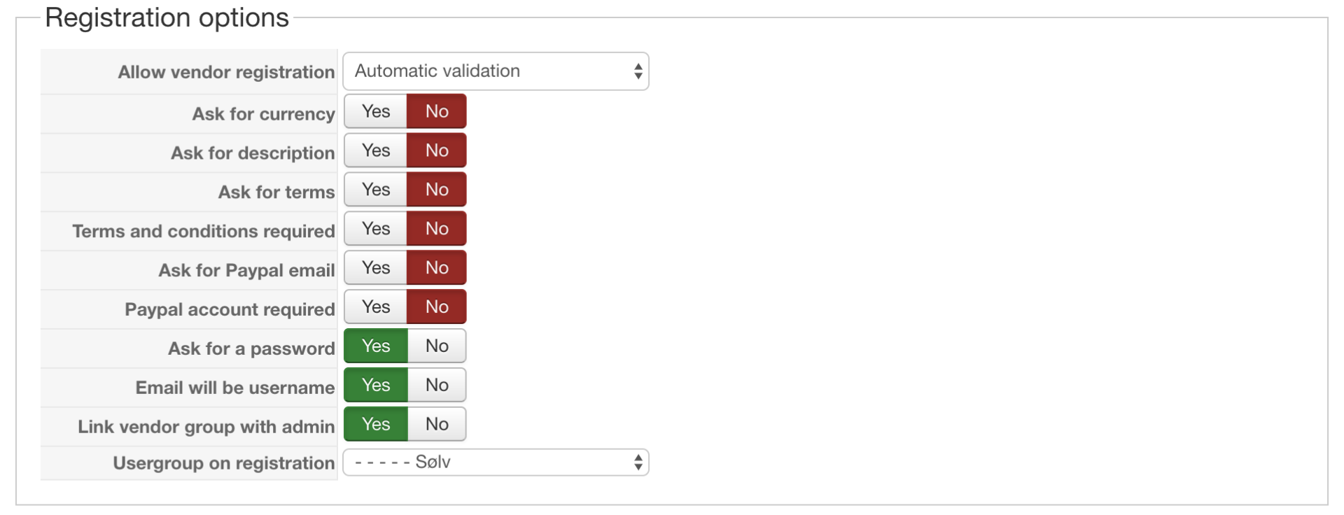

We are facing an issue where newly registered Vendors does not get the correct (any) group assigned.
What happens is the following:
1. Vendor registers

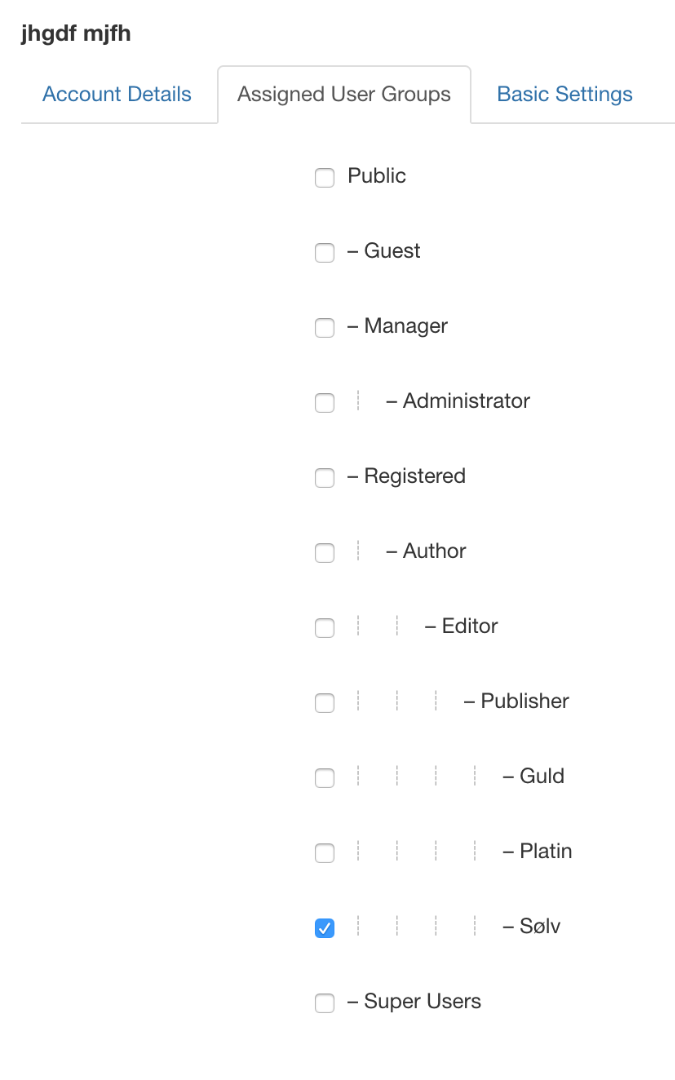

2. Joomla user is correctly created and placed in the User Group: Sølv (Silver)

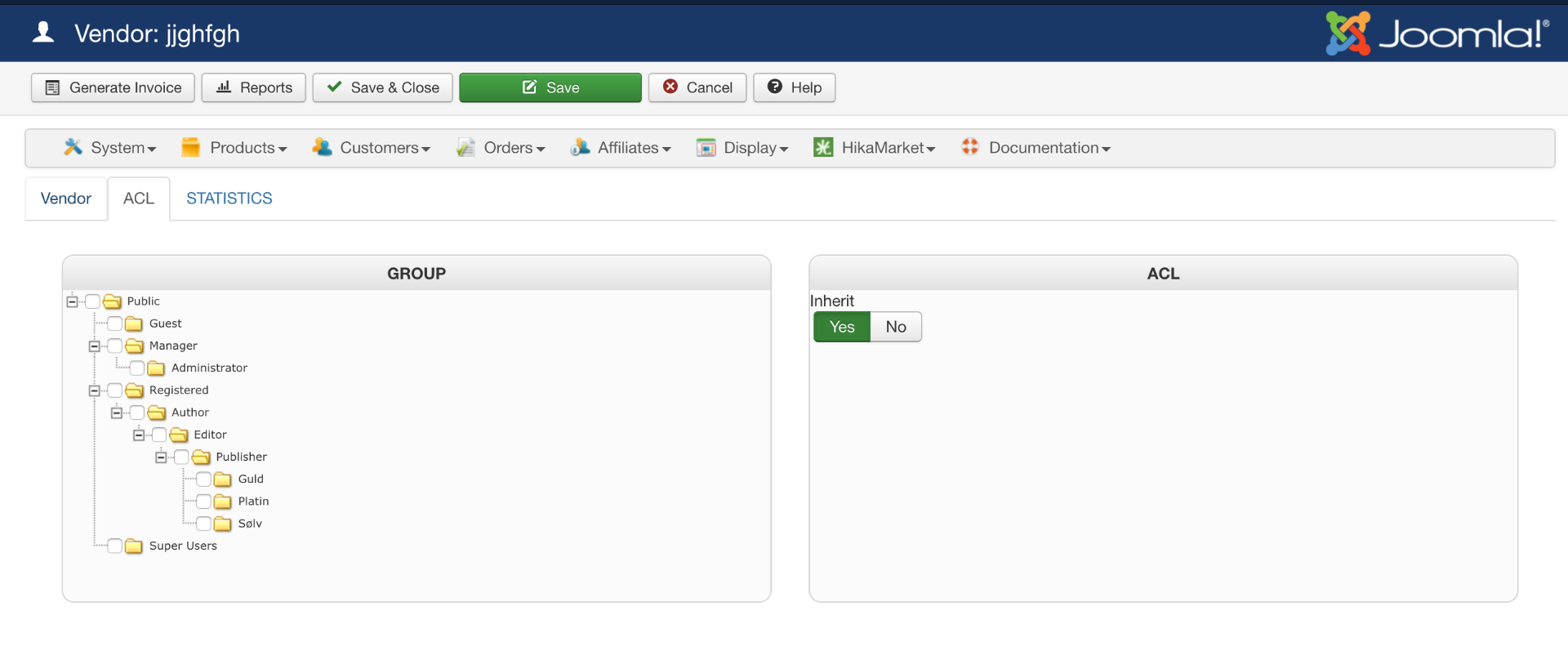

3. HikaMarket vendor user is correctly created but is not assigned any User Group.
If an administrator manually edits the Joomla user of the vendor, then suddenly the User Groups are synchronised.

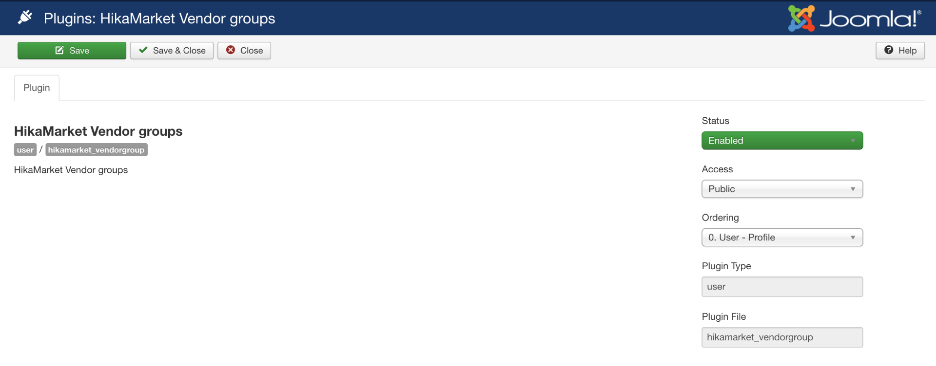

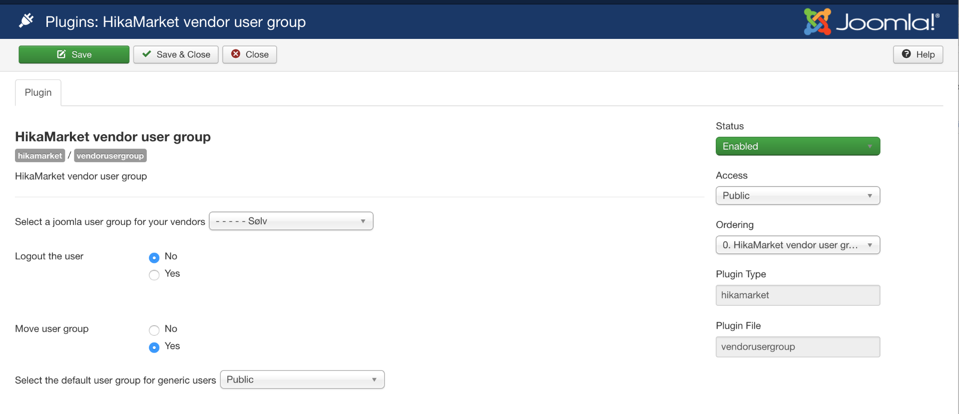

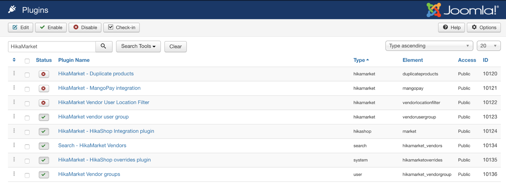

Plugins installed
HikaMarket vendor user group
HikaMarket Vendor groups
HikaMarket Configuration Registration Options
Joomla User Group
HikaMarket Vendor ACL
