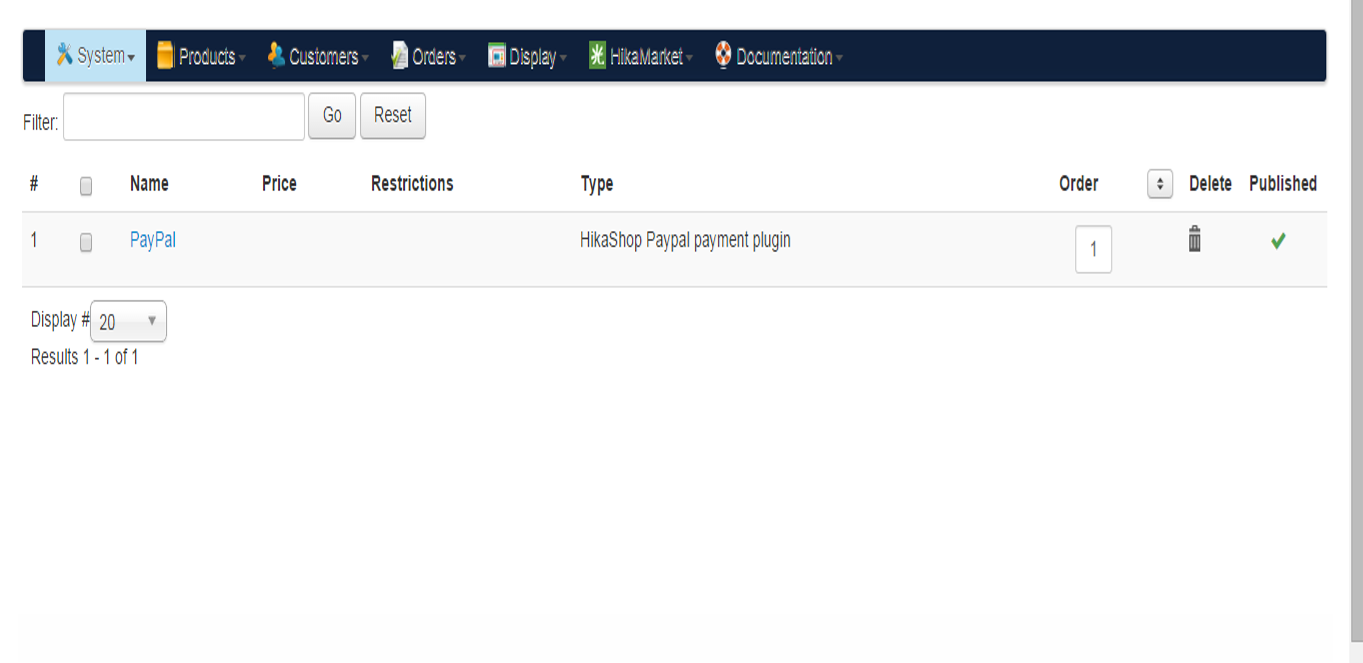

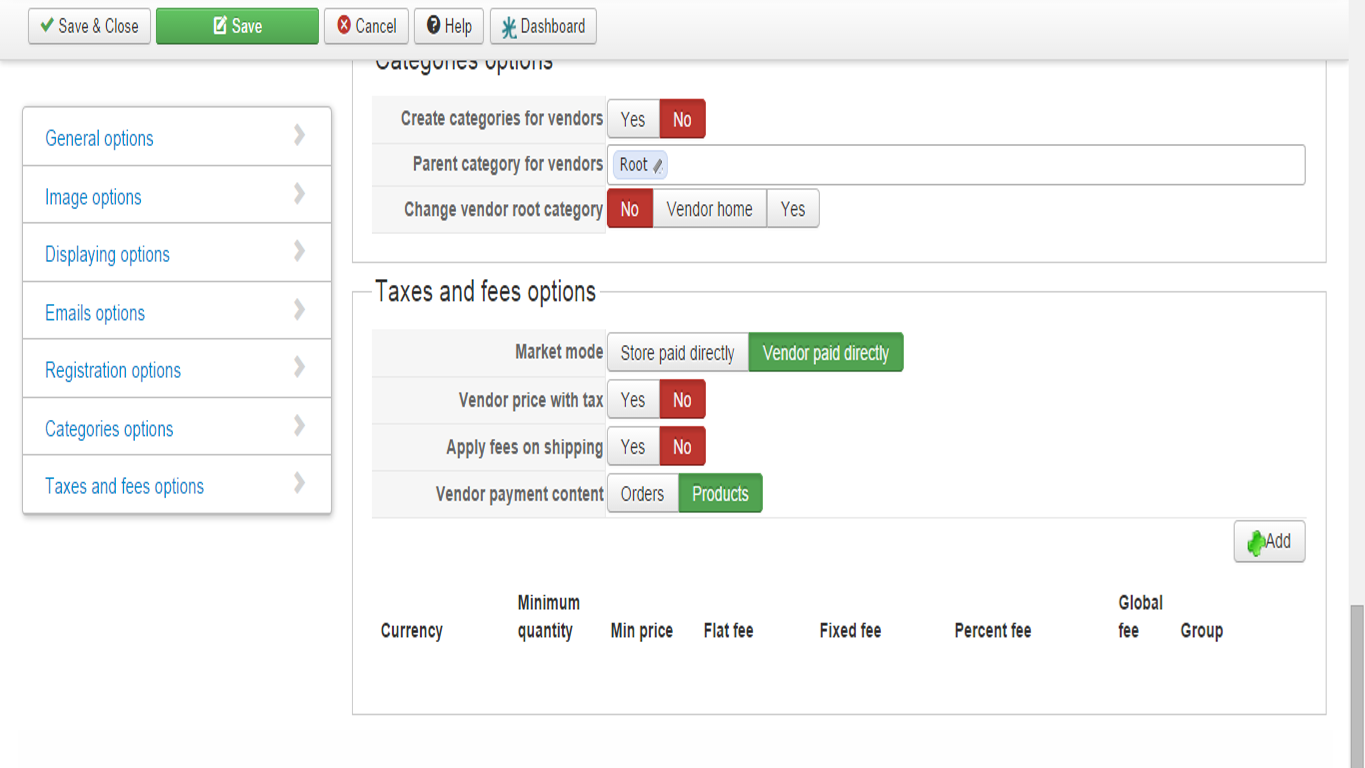

I set the configuration to send the payment directly to the vendor's paypal.
However, the paypal page directed to when checking out is still my paypal.
I am using HikaMarket
Please advise

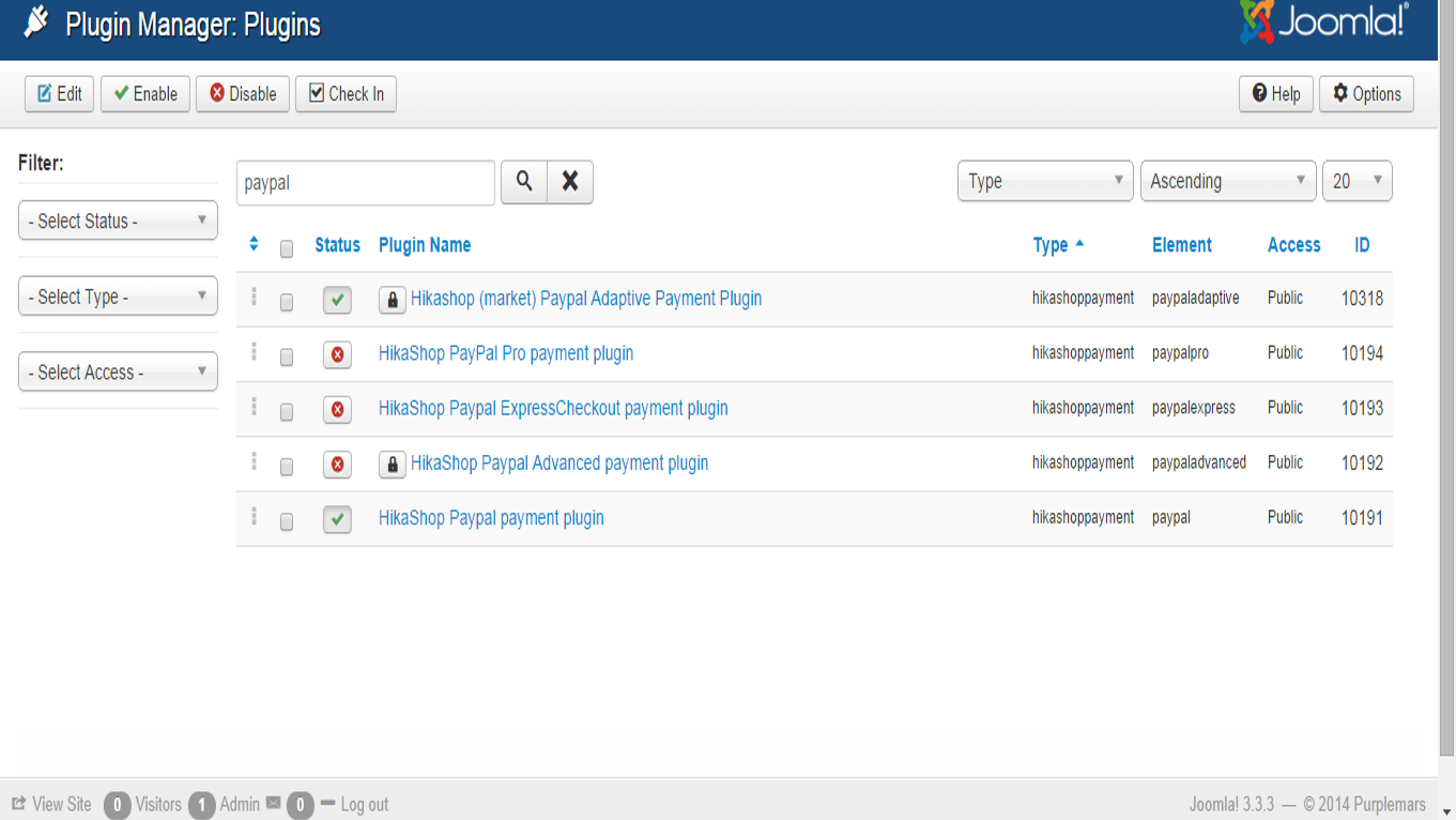

HikaShop 3.2.3 does not exist.
Please provide your HikaMarket version number.
Please provide a screenshot of your paypal plugin configuration (and specify which paypal plugin you're using exactly).
Please provide some screenshot of your HikaMarket configuration (market tab).

You using the plugin "paypal" and not the plugin "paypal adaptive" ; which means that the money will always be send to your store paypal account and it is not possible that your vendors are paid directly.
It means that between your HikaShop configuration and your HikaMarket configuration, they are in opposite and it won't work.
The best solution will be to use the "paypal adaptive" plugin in classical mode.

Otherwise, you can still use the HikaShop "paypal" plugin but you have to change your HikaMarket configuration in order to specify that the "market mode" is "store paid directly" because it will be the case.
