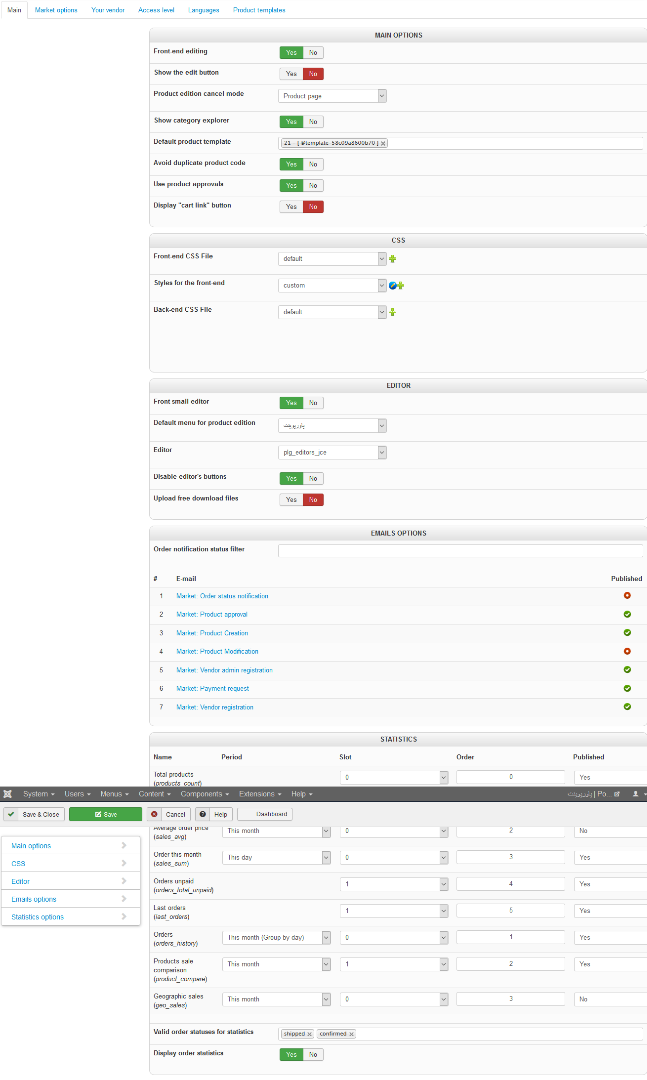

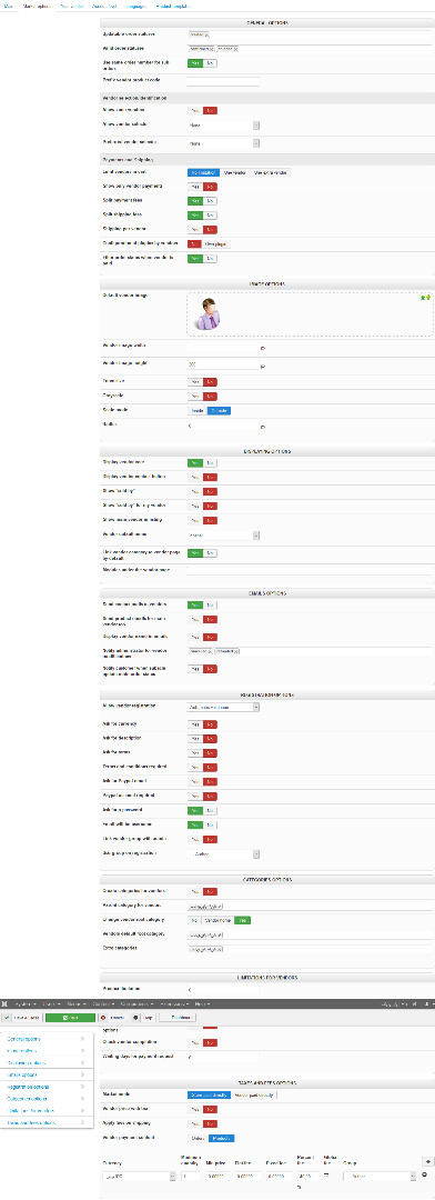

I attached ScreenShot.
I hope you help me, I need to automatically vendor confirmation.

8 years 10 months ago #281850
Thanks for the screenshot.
I can see that your configuration is correct.
You wrote that you had 5 registration and one of them was good.
