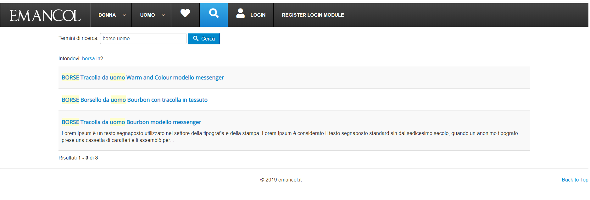

I would like show the product list when user type some key word on smart search Joomla! Now I have the result like the

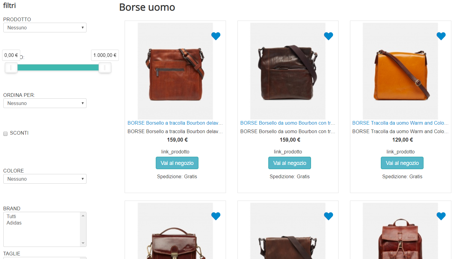

But I would like have this result:

Well, Joomla's smart search is supposed to search among any kind of elements: Joomla articles, HikaShop products, K2 content, etc.
So the results page displayed by it only contains the most basic things.
So you can customize the results page with a view override and PHP coding:
docs.joomla.org/Customising_the_Smart_Search_results_page
Actually, reading this, you can even customize the results per type so we'll look into the possibility of customizing the products search results in the future that way. But for now, custom PHP code in a view override is the only way to go.

Then you can create a filter of the type "text" via the menu Display>Filters. And then you want to configure the HikaShop filter module via the Joomla modules manager to display that filter on your home page.
The result of the filters will display as a products listing so that would look like the listings of products you already have on your shop.

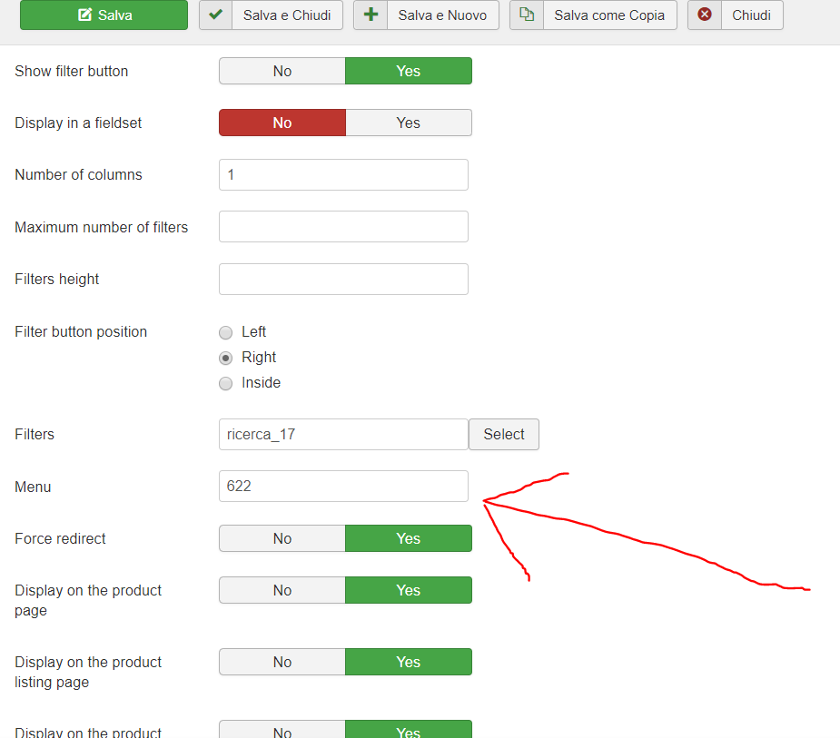

I did as you told me. But inside the module filter in the filed menu I can fill only one id menu?
I tried fill differente id menu with different separator but it looks like it can show me only one Id-menu.
Last edit: 6 years 10 months ago by Coluccini.
  • Posts: 85796
  • Thank you received: 14091
6 years 10 months ago #310345
Yes. You need to enter here the id of a menu item configured to display all your products like the default "products listing" menu item setup by HikaShop your Joomla menu manager when you install it.
That way, the filters of the module will filter the products in that listing and you'll see the filtered products based on what you entered in the filters of the module.
