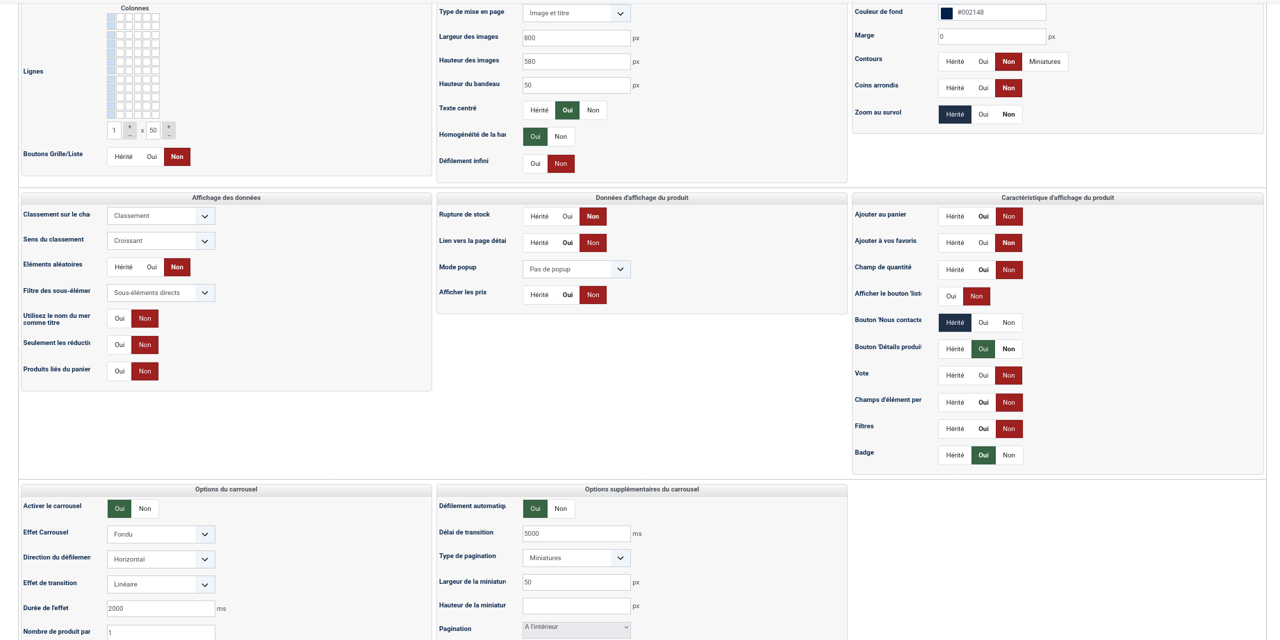

Can you provide these elements :
- An Url link where we can see the context (and with the padding), precise the relative Id module.
- The relative setting screenshot (in the HikaShop options tab).

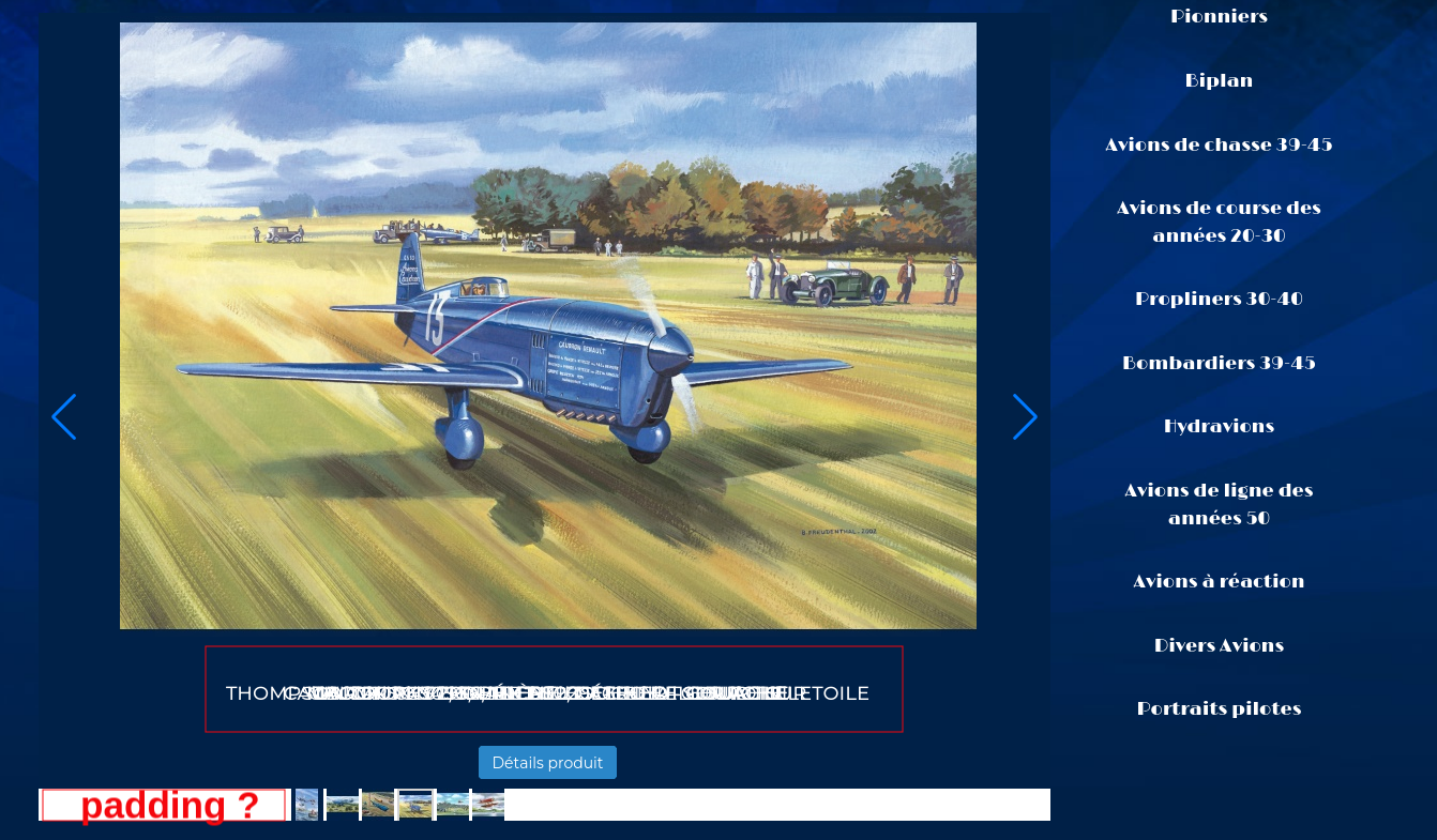

  • I keep havin strange padding on the thumbnail line
  • I've a white background on thumnail line
  • the carrousel don-t work for product title which superposing themselves
Thank you for your help !

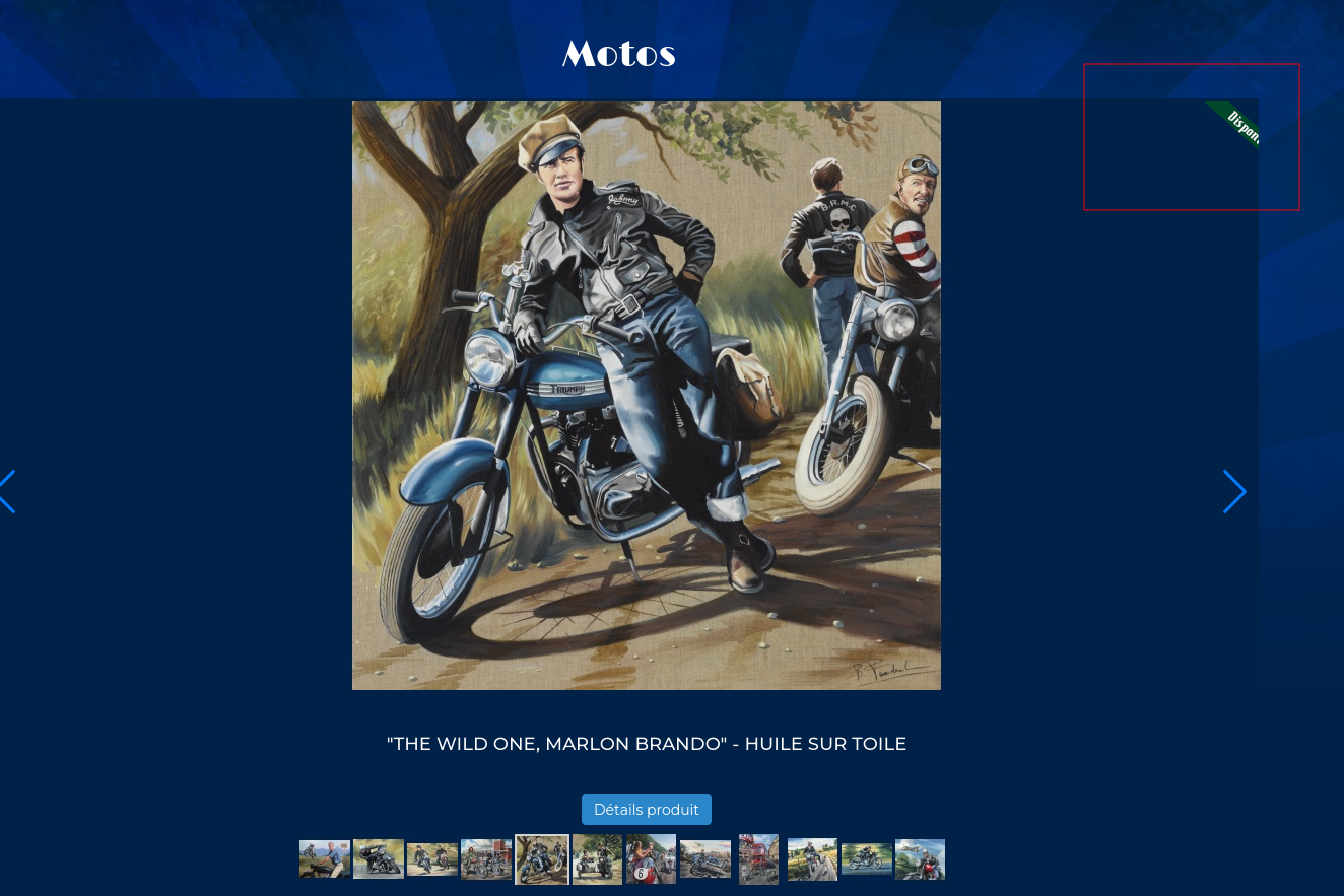

  • Posts: 6
2 years 7 months ago #358636
Thank you for helping ! When I create a new menu item I'm not able to create activate carousel on it (the hikashop option is not displayed - strange ! ) Anyway, I was able to display a hikashop carousel module in my newly menu item. But I keep having the same displaying issues !

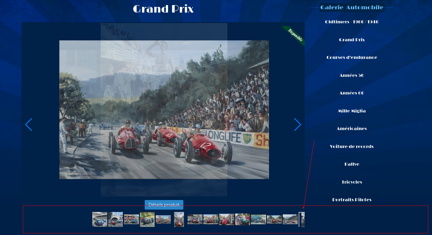

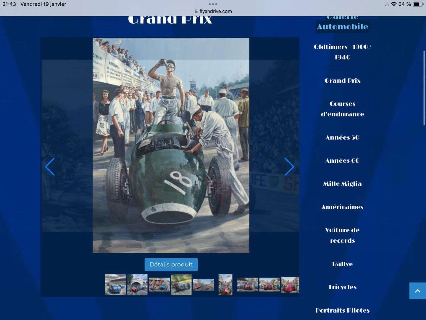

The issue seems to come from the carousel effect :
- "fade" (fondu in french) => image title overlapping issue - flyandrive.com/index.php/fr/galeries-de-...rie-autres-themes-fr (see joined picture)
- "slide" (glissement in french) => padding issue - flyandrive.com/index.php/fr/galeries-de-...iste/galerie-moto-fr (see joined picture)
- navigation thumbnails is cutted - flyandrive.com/index.php/fr/galeries-de-...and-prix-i-endurance
2 years 7 months ago #358645
We can suggest to use some custom css in order to correct your display issue, Documentation to learn how to add custom css to your frontend file, here .
Step by step :
This display option is necessarily limited by the size of the product names (which will vary depending on template) and therefore having a consistently clear result is not easy (or even impossible).
But we can help you guide to dress this, maybe you can use css command :
span.hikashop_product_name {
    background-color: #003C6C !important
This is more a css display issue than a carousel settings, maybe just a custom css command can help you :
.hikashop_product_listing_85 .hikashop_product_image_subdiv {
    width: 90% !important;
where "hikashop_product_listing_85" is to restrict your command to the required context.
There, a bit like before there are limits to the coherence of the display, here you have a lot of thumbnails to display, while the body of your website is limited in width.
So once again, there are possibilities to adjust, but it remains limited, or you have to completely widen the body...
But you can already add this command :
.hikashop_product_listing_59  #hikashop_carousel_thumbs_hikashop_category_information_module_ .swiper-wrapper {
    left: 0;
    right: 0;
Last edit: 2 years 7 months ago by Philip.

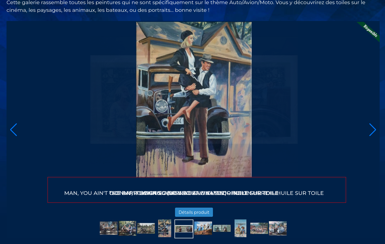

2 years 7 months ago #358999
Thank you again for helping.
I applied the css hack on my carrousel and it fix some of the issues.
I keep having some padding issue on the sliding effect so I've decided to use only "fade" effect which give better results.
I still have one annoying issue, after a while I get image overlapping (see scrennshot) ? Do you know any css which could solve this issue ?
flyandrive.com/index.php/fr/galeries-de-...-oldtimers-1900-1940
2 years 7 months ago #359008
Can't be sure of it, but it seems that this come from your current template, via an override (inline css added).
Now, you can use the "opacity" command like this :
.swiper-slide.hikashop_carousel_item {
    opacity: 1 !important;
