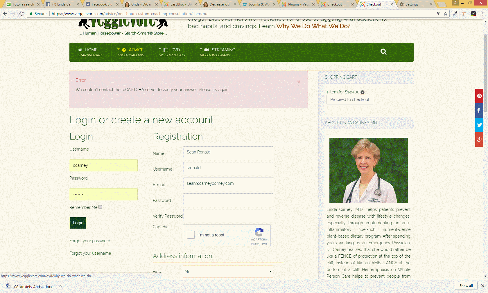

-- url of the page with the problem -- : www.veggievore.com/advice/one-hour-custo...onsultation/checkout
-- Joomla version -- : 3.8.0
-- PHP version -- : 7.1.8
-- Browser(s) name and version -- : Chrome for Windows Version 60.0.3112.113 (Official Build) (64-bit)
-- Error-message(debug-mod must be tuned on) -- : Error
We couldn't contact the reCAPTCHA server to verify your answer. Please try again.
I upgraded my HikaShop and my Joomla and did not test but was just informed that my ReCAPTCHA is no longer working. This just broke. I have logged into my ReCaptcha page and Google and I have the correct public and private keys which have been configured on my HikaShop reCAPTCHA plugin for years. I found some similar problems reported here and found in this forum a link to
www.hikashop.com/support/documentation/7...-with-recaptcha.html
I downloaded the plugin and things got worse. I uninstalled the previous plugin and things are still worse. Basically the reCAPTCHA no longer displays. I wonder if this is because I had two CAPTCHA plugins enabled on my site. I am thinking I only need one.
Captcha - ReCaptcha
HikaShop ReCaptcha v2
Here is a page where the CAPTCHA should be working. It should first display and then second it should work. It was displaying and not working but now it is neither displaying or working.
I have embedded a screenshot of the page when the Captcha was displaying but the Error message displayed.
I would sure like some more clues as to what might have made this stop working. I am happy to give you access.
Also noticed after installing the HikaShop ReCaptcha v2 again that the Version and Date do not display properly in the Extensions manage area:
Version displays: {__PLUGIN_VERSION__}
Date displays: {__DAY__} {__MONTH__} {__YEAR__}
ALSO: I would LOVE to display the ReCAPTCHA once it is working again below the Address Information section. But, when I selected the address option it did not display even the word Captcha which is what is being displayed now.

I have put my site back to where it matches the image I attached. So, now the Captcha box shows. It is an older version of the Hika Recaptcha v2 plugin because the option to display the ReCaptcha after the address is not available. The easiest page to see this is at www.veggievore.com/registration
The ReCaptcha shows again now that I rolled back my Recaptcha v2 software. But, it still does NOT work. The error is still there as follows:
Error
