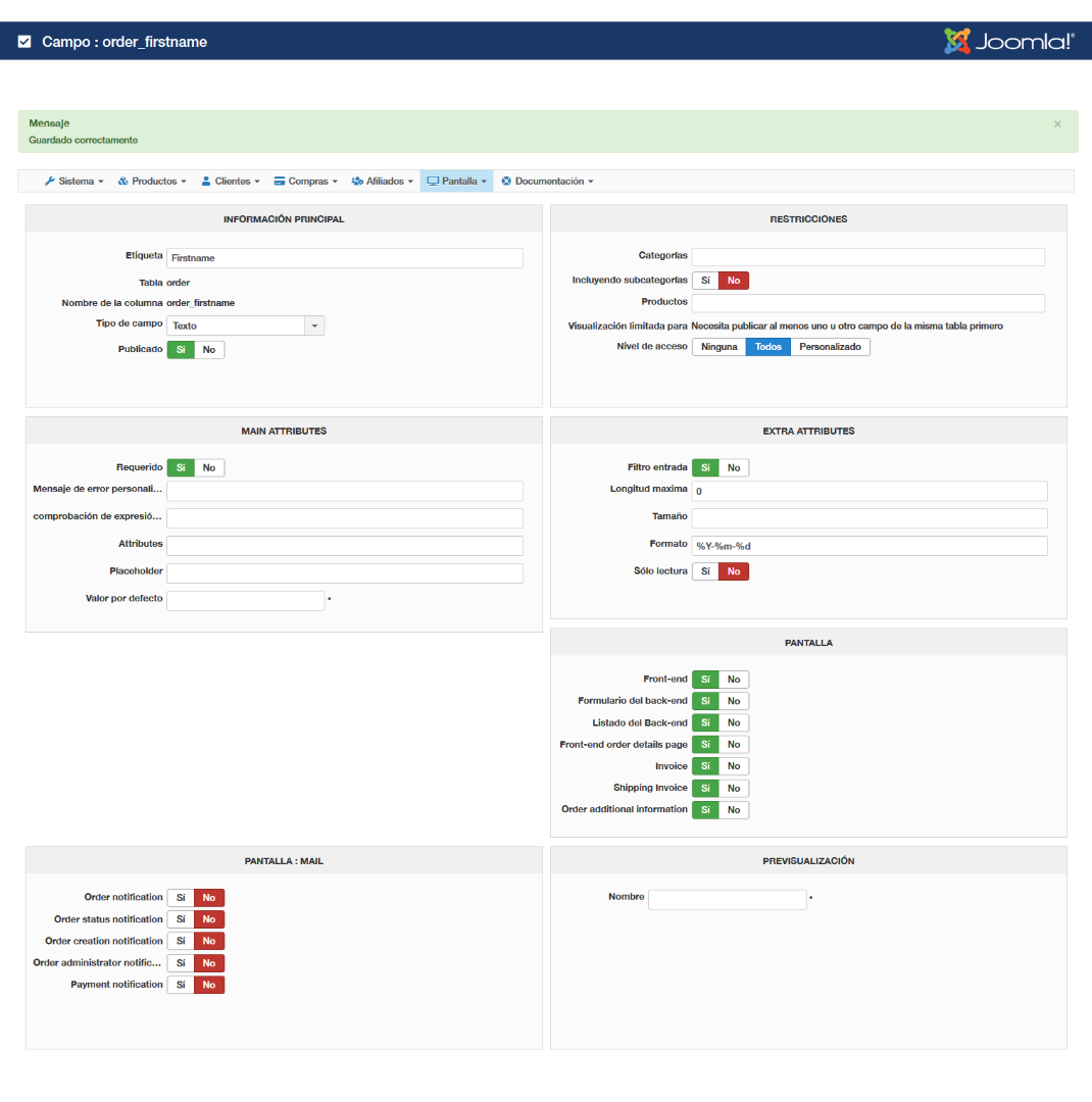

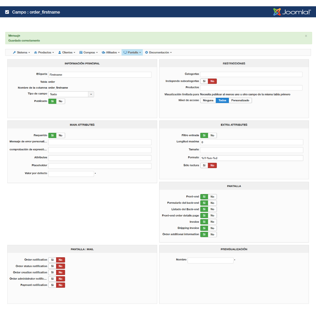

We are trying to configure some custom fields in the checkout process of our shop. We would like to add some fields to collect information about the user who purchase our products (name, mail, and other comments) but we can not set this custom fields.
What we did:
- We have created a custom field (type: text) in ORDER table
- We published the custom field and set to YES all the options in "Display" tab.

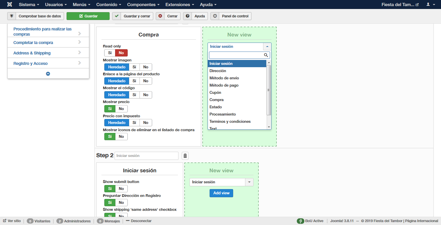

I already try this out but there is no "FIELDS" option ("Campos" in spanish) I would be able to add in.
We also read this: www.hikashop.com/support/documentation/4...eckout-workflow.html
You can see in the screenshots I have sent you which are the options that appear in the dropdown:
- Log In
- Adress
- Shipping
- Payment
- Coupon
- Purchase
- Cart
- Status
- Terms and conditions
- Processing
- Terms and Conditions
- Text
- Hikashop user points
Is there any way to add "FIELDS" to this dropdown? Why this is happening?
Thanks in advanced!!

It could be a translation override issue whereby the text you see is not the text you should have for the name of the view. Please login in English and check that dropdown in English, it might help.
Otherwise, it would need that you don't have the Business edition installed as that view is only available for the Business edition. But normally, in that case, you shouldn't be able to create custom order fields either, so I don't see how that could be the case.

It was the translation! Actually this option appeared but not with the real translation, that is why we had not found it. We finally solved it!
