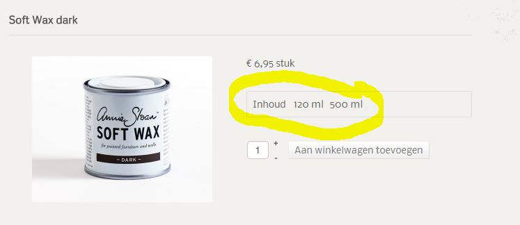

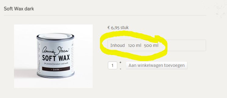

I went through the documentation but I have one problem and one question about it.
1. The problem is that if you set the Characteristics selection method to Radio Button and you change the css as in your example.
Then all other products that have characteristics (without image selecting) are no more user friendly. Because the dropdown or radio buttons are gone. See image: "dropdown-is-gone.JPG"
I Hope you have a solution for this, like a product class or something? But I see no option for that in Hikashop.

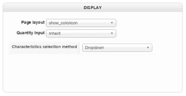

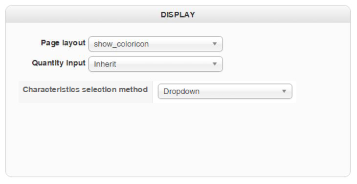

The problem is that if you set the Characteristics selection method to Radio Button in the configuration.
All other products have to use radio buttons. But we like to work wit drop-down function for the other products.
How can I fix this issue?
Or is it an idea that you can choose the characteristics selection method for the choosen lay-out on the productpage in the back-end?
Like the option to choose for the Quantity Input on the display area. See screenshot
Hope to hear from you.
