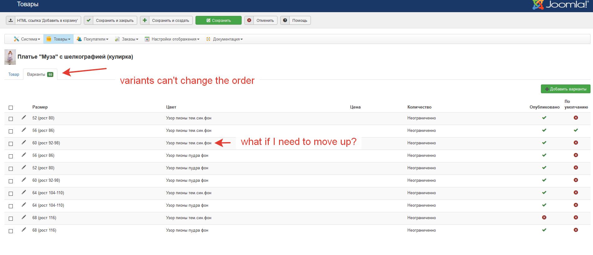

Hi !
When I add variants to product I can make a mistake or need to add one variant later...
What if need to change the order of variants? (for me - the sizes of clothers)
I think that this feature will be very helpful!

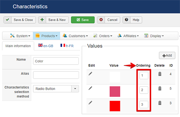

9 years 1 month ago #276045
You can sort your variants in your characteristics configuration page, in Main HikaShop configuration in Products dropdown select Characteristics, and click on your required Characteristic to edit order like this :
Hope this will fit your needs.

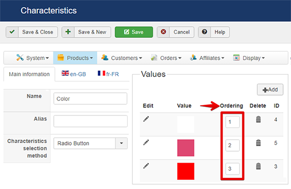

9 years 1 month ago #276174
Hi, Philippe - Side question:
Do you have a link to a forum thread or documentation page that shows how to set up the radio button color block custom fields, like your screenshot in this thread? I remember seeing something like that a long time ago but am not sure what the recommended method is for HikaShop v3.x to do this.
We are currently using colors + names in dropdowns but for a lot of colors it looks nicer to have a grid of color blocks. (As long as when you hover the name shows up). cl.ly/2A3e0c2a3O1E

9 years 1 month ago #276177
you can find it under the Tutorials, still works fine for Hikashop 3:
www.hikashop.com/support/documentation/2...isplay-by-color.html
