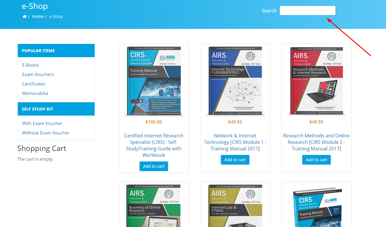

we received many request from customers asking to add search field that will make them find the product quicker instead search the catalog, any ideas how to do so within Hikashop, thanks

I did search on the forums, and comes with Joomla search Module,
www.hikashop.com/forum/filters-search/88...y-search.html#258268
but i thought there is a module specifically for Hikashop, that shows the search by icons like this idea,

Ok this is my question is there is a way to integrate the Joomla Search Module with Search products Plugin Hikashop? and if so we need instructions how to do that, thanks

If you activate the HikaShop products search plugin and configure it via the Joomla plugins manager, it will be connected with the search module of Joomla and the results of the module will contain HikaShop products.
If you want the search results page of Joomla to display like a products listing of HikaShop, then you'll have to customize the search results page of the search compoennt of Joomla. Here is a start:
www.joomshaper.com/blog/how-to-improve-s...s-page-in-joomla-3-4
