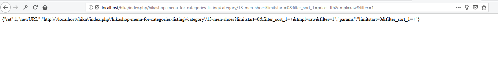

2. Sometime when filtering we get blank page with url params in it.
Here is the example which was done like this.
1. Installed Fresh Joomla 3.9.10 and Hikashop 4.2.0 with demo content. Created sort filter with radio. Filtering seems working but after pressing delete button i get this page:
All test are done on protostar template with no modifcations.
