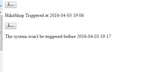

10 years 5 months ago #235126
Hello Mohamed,

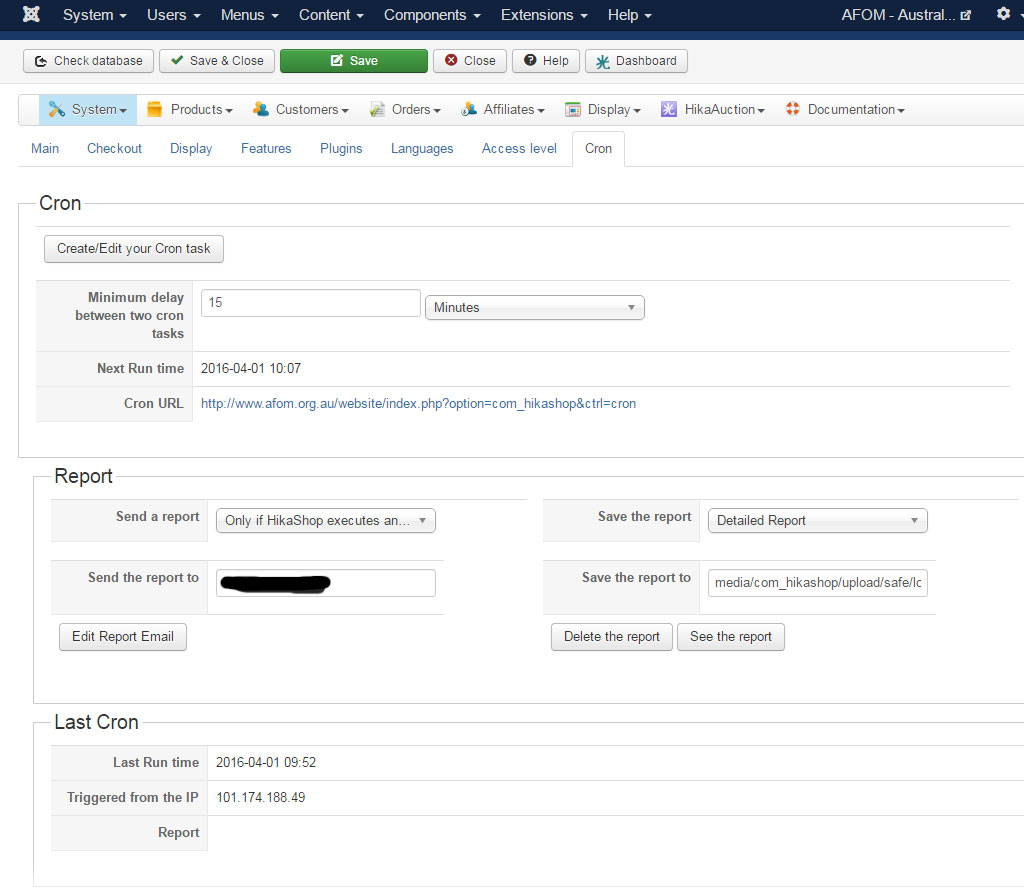

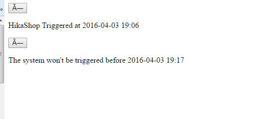

I did test the link (index.php?option=com_hikashop&ctrl=cron) from the frontend, and in the backend it shows that the cron task was run and the IP that triggered it. Sorry, but I don't know much about cron task and I don't really know what to do. But I do need to get this fixed very soon as my client is waiting for this website to go live now.
I have attached an image of the screen from the cron task link (triggered twice).
I hope you can help me out here.
Thank you
Kind regards
Lene
  • Posts: 86104
  • Thank you received: 14204
10 years 5 months ago #235146
You need to configure your cron task, following our documentation:
www.hikashop.com/support/documentation/5...ashop-cron-task.html
Once that's done, it will work.

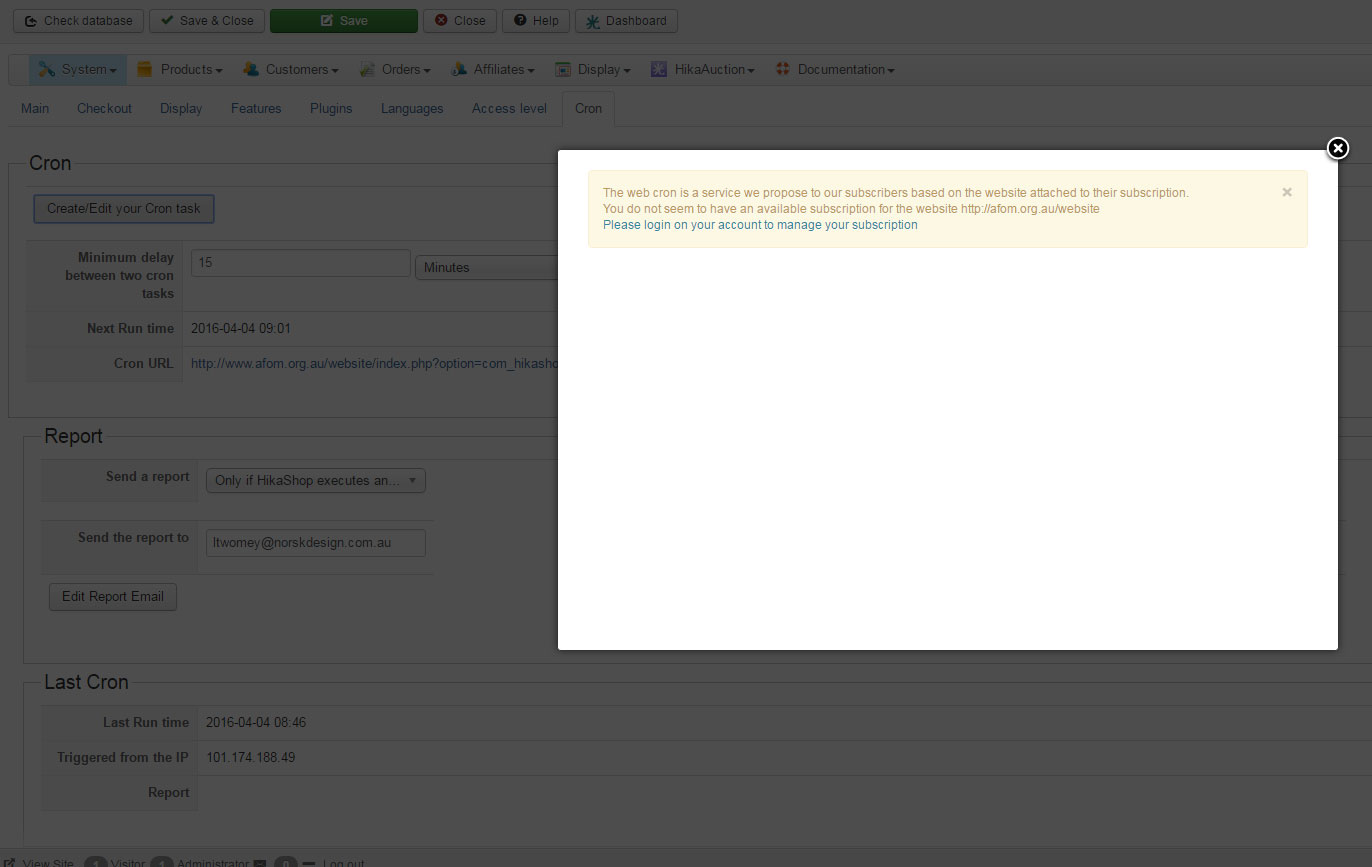

  • Posts: 191
  • Thank you received: 5
10 years 5 months ago #235173
Hi Nicholas,
Do you need to have an active account (which I do) to use HikaAuction?

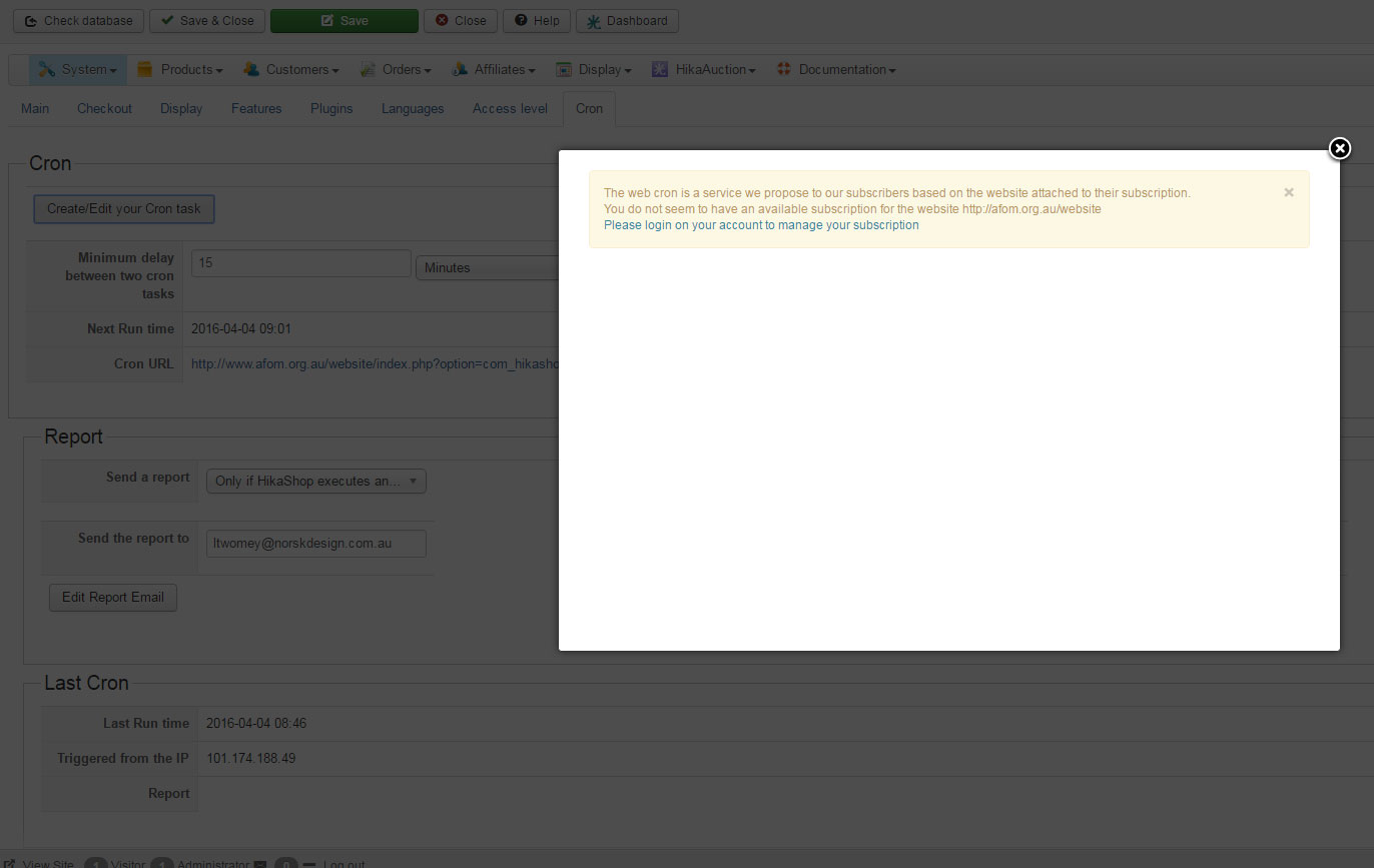

I tried adding afom to both the auction subscription and the hikashop subscription but that does not make any difference when I click on the 'create/edit your cron task'. I have attached an image.
Is it possible to setup a cron task on the hosting server instead of using your server, and if you need an active subscription for the auction to work, will this make a difference? I just to know so my client will know if they have to keep subscribing to HikaAustion.
Thank you

10 years 5 months ago #235215
No, you don't need to have an active account. You can instead configure your cron using your own server.
The cron using your own server will work even if your subscription expire.
The documentation link I gave you explains briefly how to setup a cron for your own server: www.hikashop.com/support/documentation/5...ron-task.html#server
Regarding the error you have with the popup, it's because the URL you entered in your subscription and the URL you're using to access your website are not the same. So please use the same URL.
But if you set a cron on your own server, it won't matter.

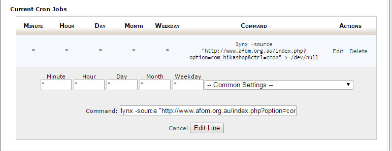

10 years 5 months ago #235295
Is there any settings that needs to be changed in Hikashop/Auction when you set the cron task on your own server?
This is getting really frustrating, there is no sign of life from the auction other than the ticking down at the front end and bids. No sign of activity in the backend, no emails sent. Even a closed auction that had bids on it show with zero sale.
Lene
  • Posts: 191
10 years 5 months ago #235298

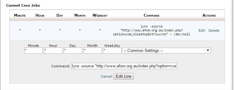

I have been communicating with the hosting company again, they looked at the server activity and the cron task, this is their reply:
Just to confirm our phone conversation, your best option would be to have Hikashop give you the exact command to put in to your cron. From the cron that's been ran it's likely there are some errors in the command you have.
Lene
10 years 5 months ago #235313
Hello Lene,
Then it just means that your cron isn't correctly triggered.
Regarding the command, you'll find it on the documentation page that Nicolas gave you :
lynx -source " www.yourwebsite.com/index.php?option=com_hikashop&ctrl=cron " > /dev/null
wget -O /dev/null " www.yourwebsite.com/index.php?option=com_hikashop&ctrl=cron " > /dev/null

10 years 5 months ago #235384
Hello Mohamed,
The command for Linux is the exact command that I have used, except for changing of course the domain name.
I tried changing both subscriptions to the domain, including sub-directory, still not working.
It is a bit embarrassing for me as I now have had to go to my client saying we can remove the auction part to a hidden menu so I can keep testing and we can go live with the website. But I can't really test either as I cannot see what changes I have to make.
Lene

10 years 5 months ago #235392
Hello Mohamed,
I added the second command, and I also added the command for main directory (needed when we go live) and sub-directory (which will be removed) and I am now receiving the cron email with this message for the sub-directory:
HTTP request sent, awaiting response... 200 OK
Length: 337 [text/html]
Saving to: “/dev/null”
0K 100% 27.0M=0s
2016-04-06 08:18:03 (27.0 MB/s) - “/dev/null” saved [337/337]
But I am still not receiving any system emails, like the outbid notification.
From somebody that has never added a cron task to a server before, can I please suggest that you put a bit more detailed description to your user documentation? Even just that you have to add two commands and also which is the recommended setting for the delay between tasks (I don't know what difference the delay will do to the auction process/emails).
Lene

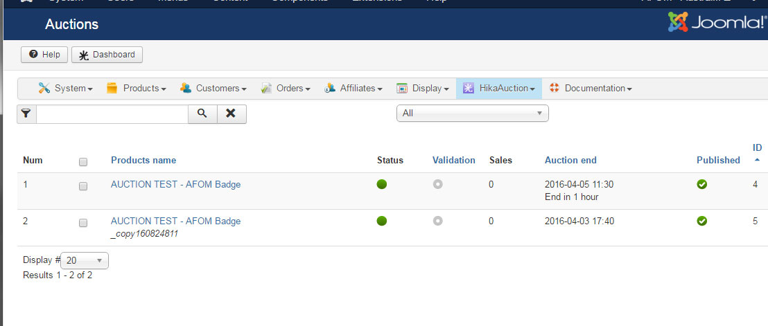

An update on the new auction that i created this morning. I set it to finish at 8:15am. The person that was outbid just received the outbid notice at 12:32pm and I received a system email with the following:
HikaShop Triggered at 2016-04-07 12:30
1 mail sent
No winning email received yet.
I have the server cron task set to run every 15 minutes, I will change this to every minute later, but it looks like Hikashop has its own trigger for how the emails are being sent and it does not make sense. One bidder received one outbid email at 8am, only email received even though the bidder placed a couple of bids. A duplicate of this email was also sent to the other bidder. The other bidder received 4 emails at 7.30am, 2 being copies (exactly the same), and 2 at 8am, one being the one addressed to the other bidder, and the last outbid notice at 12.30pm.
Any idea of what is going on??
Lene
