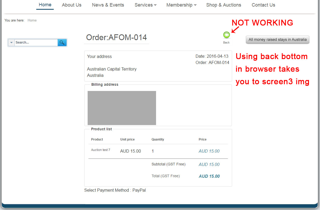

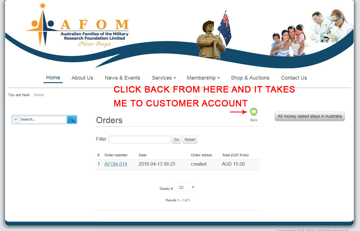

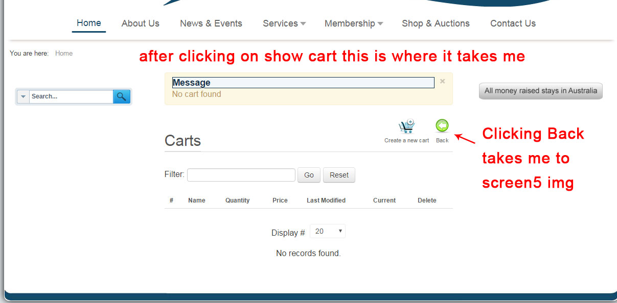

10 years 4 months ago #236435
Hello Mohamed,

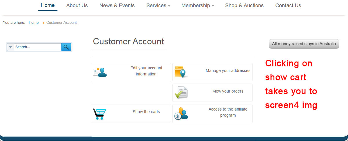

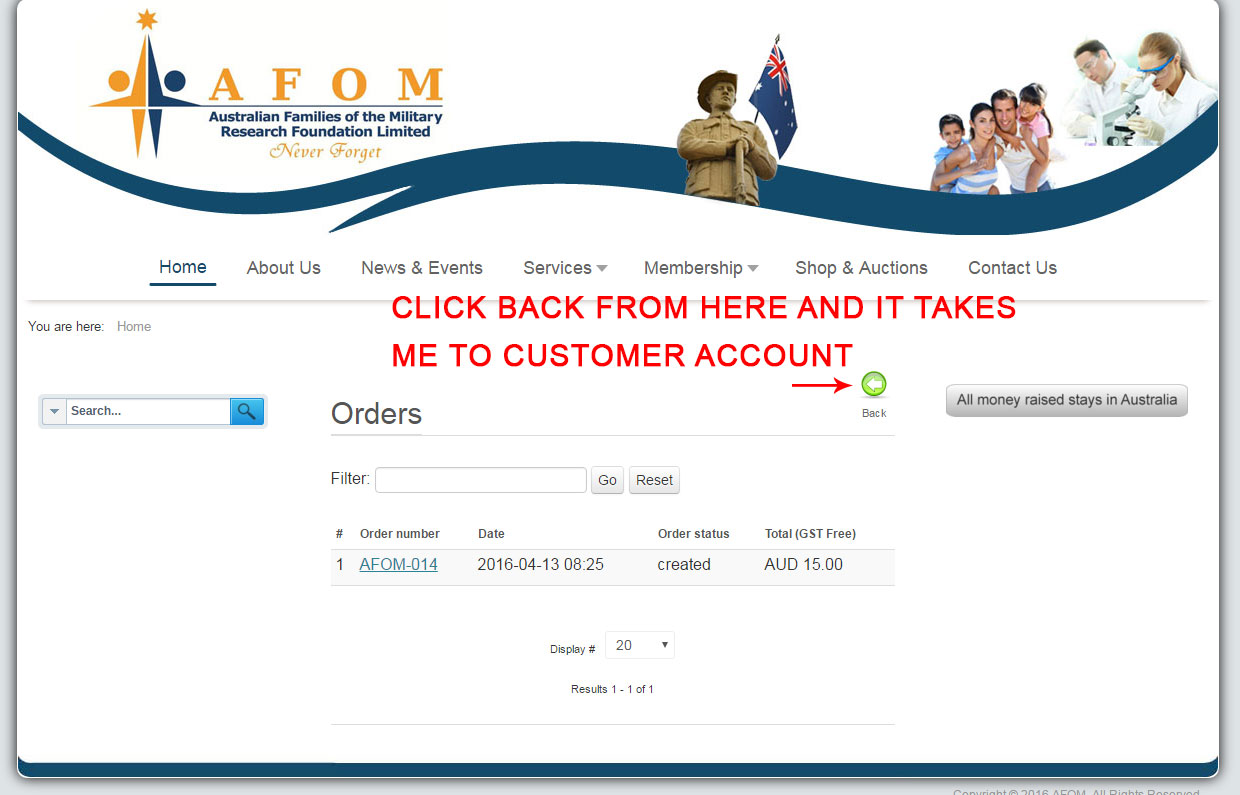

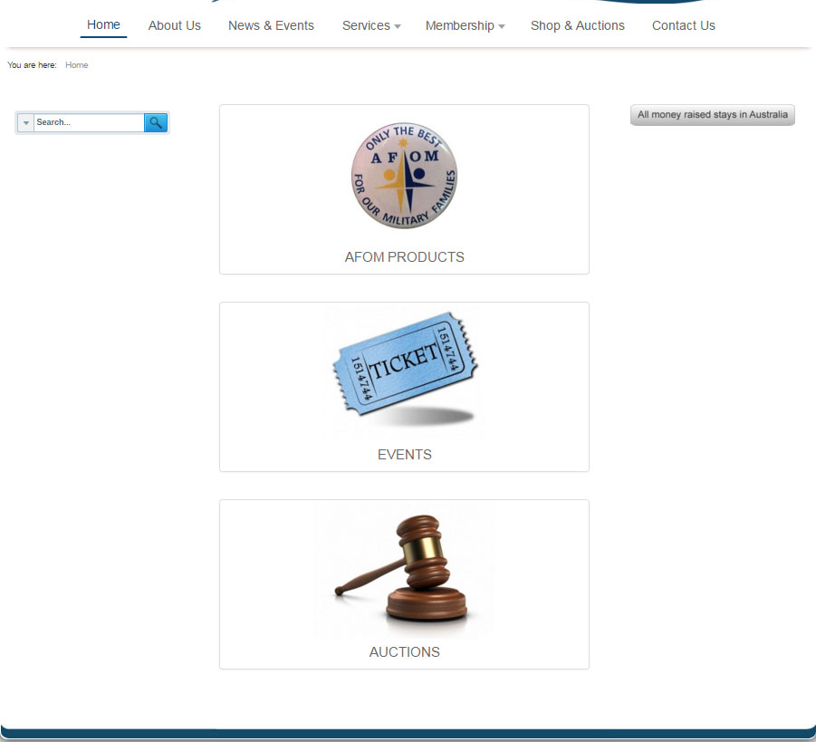

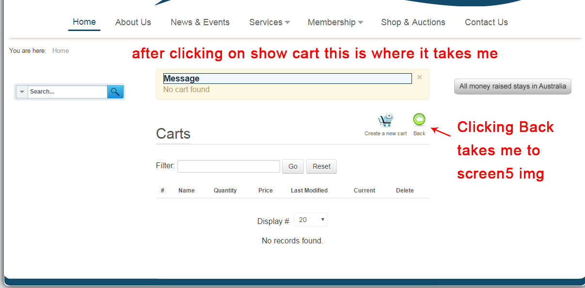

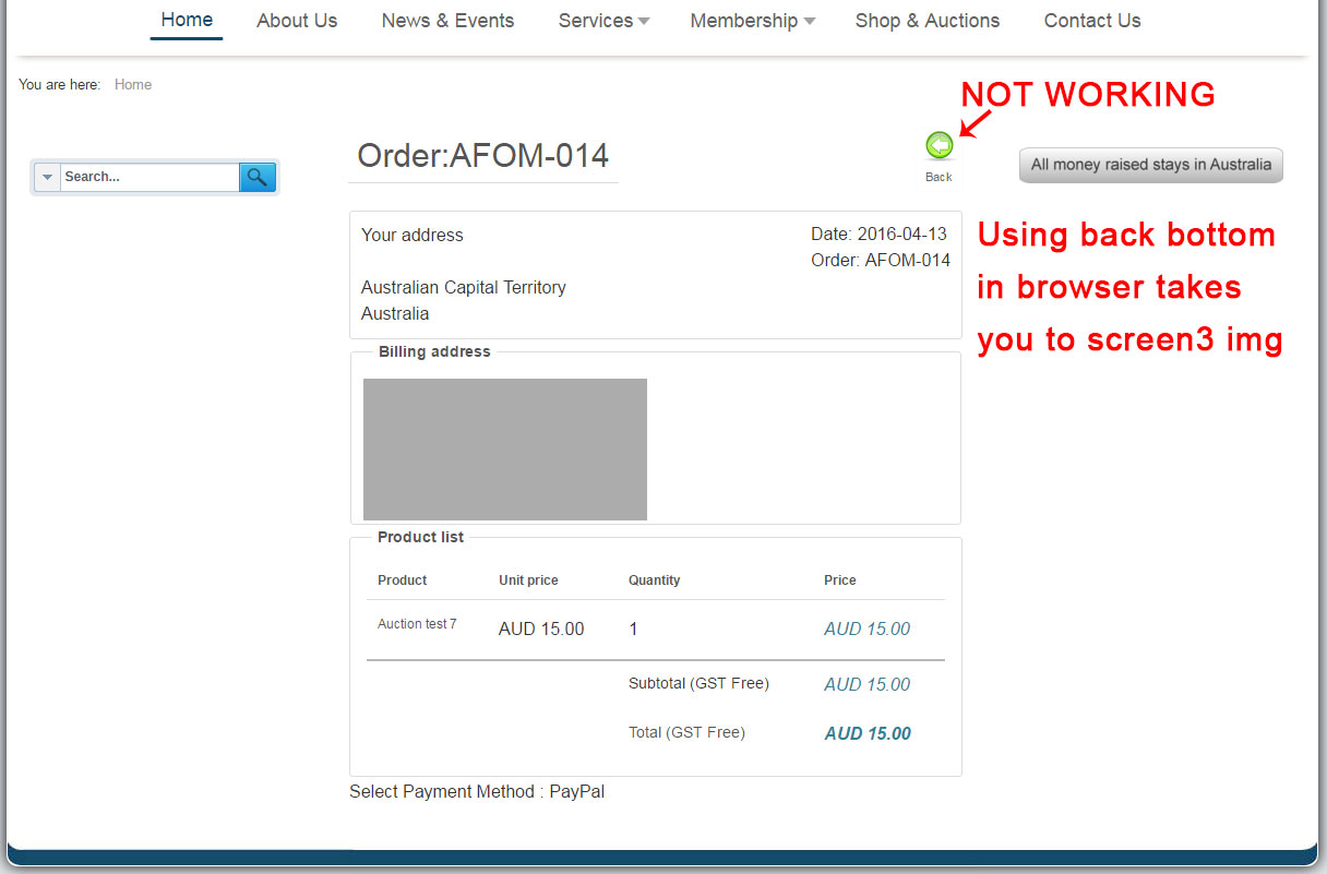

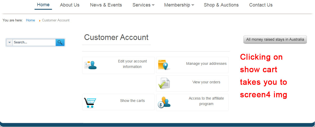

I just completed an auction and clicked on the link to complete the purchase. This is the summary of the process (screen images attached):
If I click on the order link it takes me to screen2.jpg - back link does not work
I then use the browser to go back and it takes me customer account, screen3.jpg
I click on 'show the carts' and it takes me to screen4.jpg - there is no cart
Clicking on back button takes me to screen5.jpg - dead end
After all that I receive the order email but there has been no postage added to the order. The order says that payment method is PayPal but I never went through the checkout and confirmed payment in PayPal so the order would not have been paid.
There is something seriously wrong. I was expecting the same quality as Hikashop. I cannot get the Auction working. We have been back and forward for about 2 weeks and I am now apologising to my client having to tell them that the auction is not working as it should and we cannot go live with it.
Lene
That's actually an Hikashop issue so creating a new thread about that "back" button will probably be better.

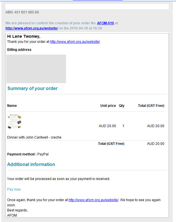

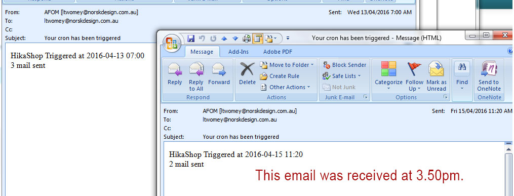

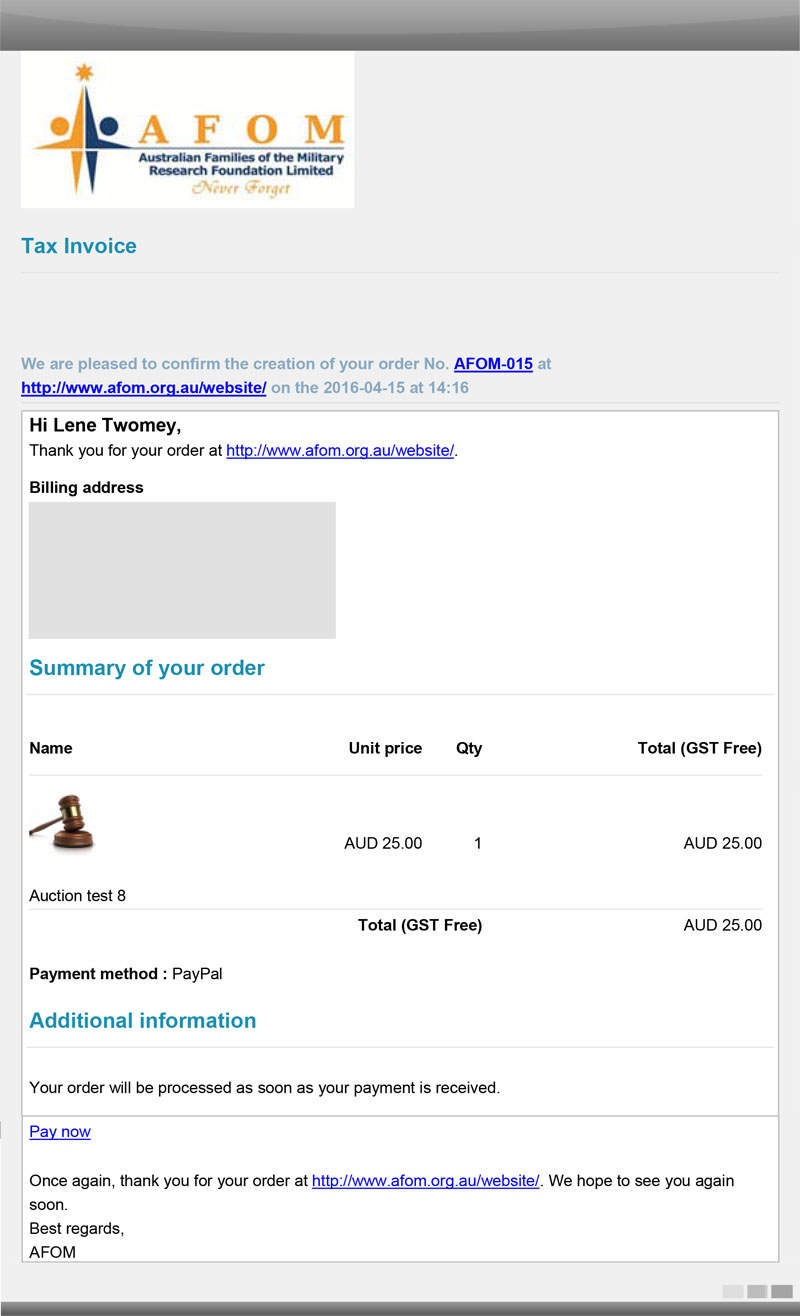

10 years 4 months ago #236830
Hello Mohamed,
One step closer... The PayPal button now shows so I can click through to PayPal and pay.

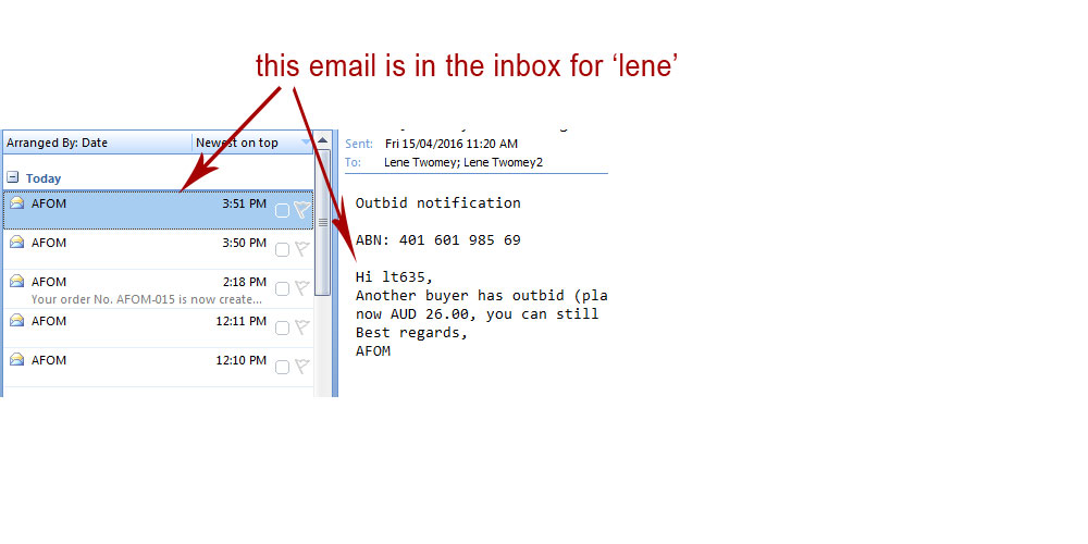

I have attached an image of the incoming emails to winners inbox (being lene). As you can see this inbox is also receiving emails addressed to lt635.
The auction finished at 12.10pm. The order was paid at 2.18pm. As you can see there is a big delay in emails being sent. The two emails with the time 3.50pm and 3.51pm is outbid notifications. A bit late when the auction finished at 12.10pm. The server is set to trigger the cron jobs every 5 minutes.

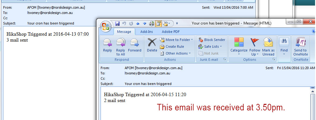

I have attached an image of the last two 'your cron has been triggered' emails from Hikashop. First was at 7am the second at 11.20am but not received before 3.50pm.
It does not look very good when the customers receive outbid notifications a couple of hours after auction has been completed.

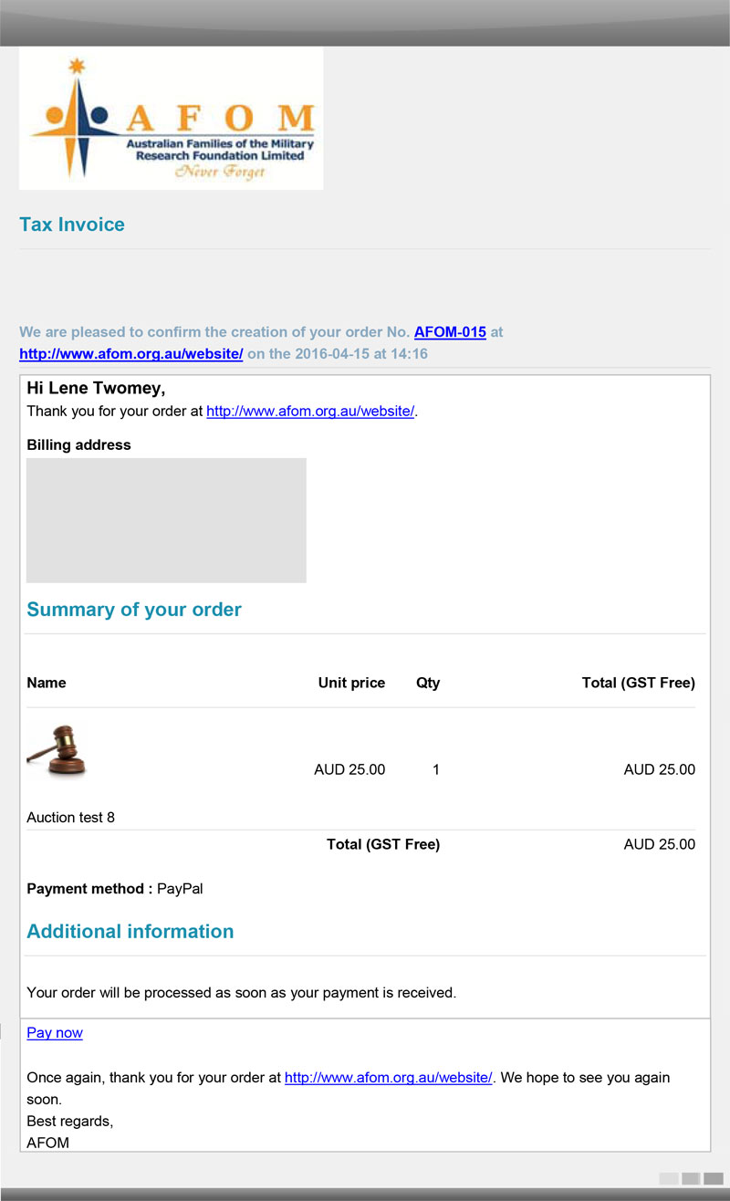

I did go through to PayPal and Pay, but as a buyer I received the summary of order email with 'Your order will be processed as soon as your payment is received.' and 'pay now' instead of payment confirmation.
As you can see from the email image attached all emails apart from the summary of your order email is just in plain text. I have tried both html yes and no in the email configurations.
Lene
Last edit: 10 years 4 months ago by lt635.
10 years 4 months ago #236890
Hello Lene,
1. I have lowered the "Cron queue Period" value of the HikaAuction plugin so can you test it again to see if it was coming from a queue period which was too high ? or from the call to the Cron through your server ?
2. I have Actually succeed to reproduce your email HTML issue, I'll fix it as fast as possible and give you the fix.

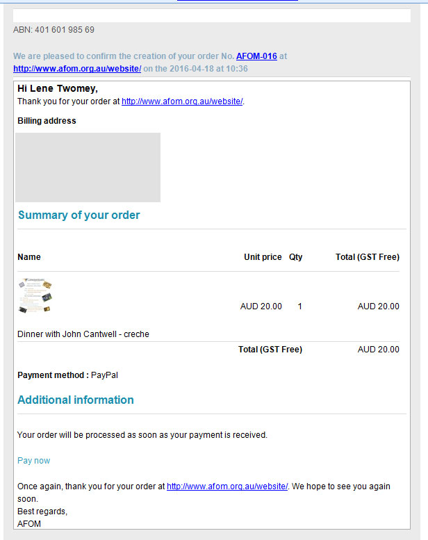

10 years 4 months ago #237059
Hello Mohamed,
I am sure my client is about to give me the sack now....
The shop was working perfect, including digital downloads.... I tested this a long time ago.
I just thought I do a quick test on purchasing an events ticket which has been setup as digital download. On checkout I noticed that the shipping step was showing (it was not before), so I clicked next and proceeded to checkout paid with paypal test account. After payment was completed I, being the customer, receive a 'summary of your order' email with the notice 'Your order will be processed as soon as your payment is received' and a 'pay now' link which leads to a dead end because cart is empty as it has been checked out and paid for.
I tested this for a product with shipping, same thing, customer receive 'summary of order' and not the confirmed payment notification.

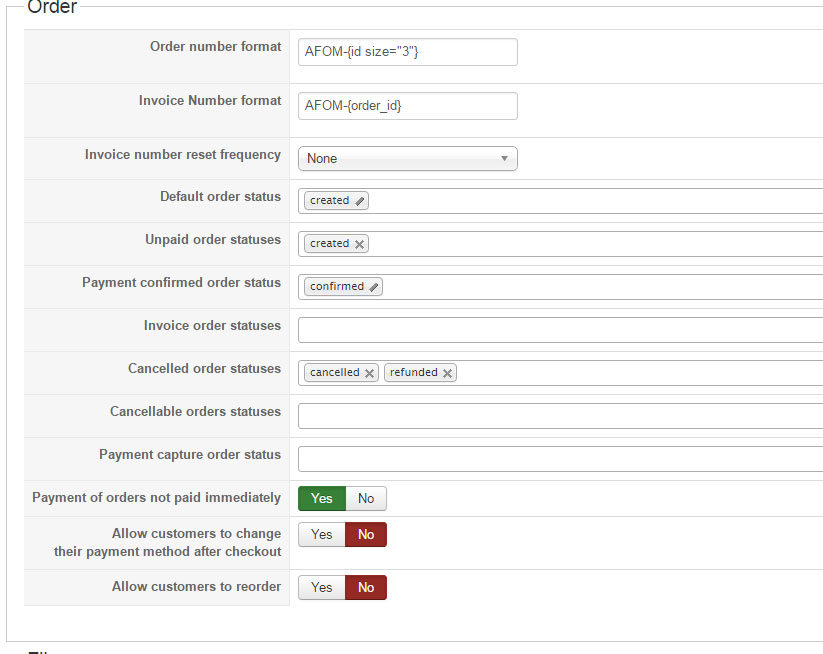

I should have received a confirmed payment notice and a link to download the e-ticket.
Like I said, this was working correctly before, just lucky I decided to test again. There must be a change that we have made for the auction that is affecting the other shop.

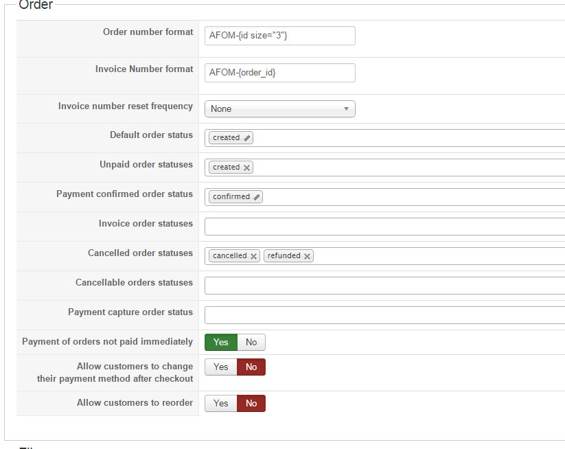

I have attached an image of the order setup, I have never had an issue like this with Hikashop before.
Lene

10 years 4 months ago #237277
I really need this orders issue to be sorted asap. My client is expecting to go live with the website today (more details in previous post):
This is the same for Hikashop and Hikaauction. Used to work fine in Hikashop.
Lene
