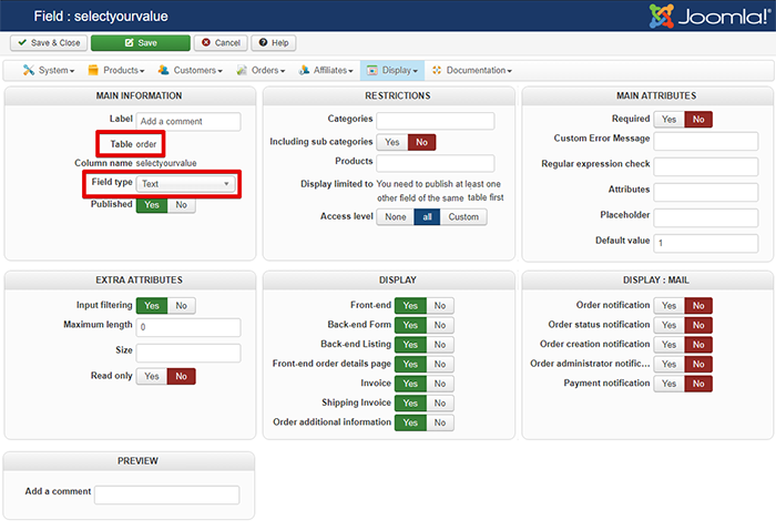

Let's go back a little, you want add to your checkout a form to able your customer to fill extra data, like comments, right ?
For us, the best was and the most easy, is to use an order custom field.
To create it, follow these steps :
- Go to Components => HikaShop => Configuration
- On Display dropdown select Custom fields.
- Click on New to configure your custom field, for start I think you can reproduce this configuration :
And don't forget, to go to your checkout configuration page (in Main Configuration, and Checlout tab) and add your Fields block in your Checkout Workflow.

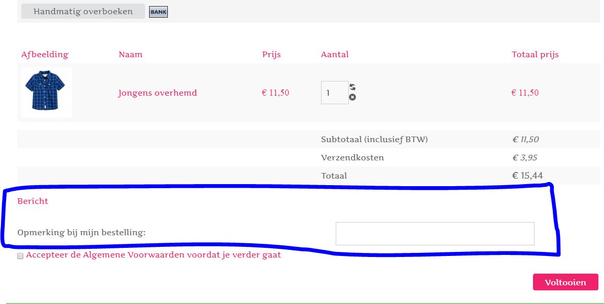

This was easy thank you! Now, I would like to customize the layout a bit. (Please see attached how it looks now):
1) I would like the text "Bericht" to dissapear
2) Besides that i would like the other line of text "opmerking bij mijn bestelling" to be on top of the text field instead how on the left.
Can you tell me how to arrange this?
Kind regards,
Joyce
  • Posts: 85883
  • Thank you received: 14120
9 years 1 week ago #273309
1. You can either use a translation override in order to change that text to nothing ( www.hikashop.com/download/languages.html#modify ), or you can add CSS to hide the title ( www.hikashop.com/support/documentation/1...ize-the-display.html ).
2. That's also possible with CSS.
I guess such CSS should do it:
;hikashop_checkout_fields label{
display: block;
width: 100%;
text-align: left;
